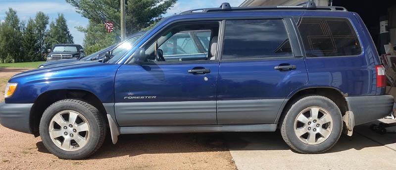

My new to me 2004 Forester has one of those awful antenna's in the rear side window, what do you guys suggest using and where do you locate a real antenna?

On my 03 Forester the antenna is in the left rear window.  After my son installed his new HU radio reception sucked.  Googled and found out the the blue Power Antenna wire needed to be connected to power the booster.  Connected the wire and works much better

my 2002 Foz also has the left rear window antenna. no major issues here with an aftermarket head unit.
I changed mine out for one that has bluetooth for hands free phone use, also has a USB port.. a bit more "modern" than the stock unit, lol
you can see the antenna traces pretty will in this pic...

What?  Did you install that antenna?  Definitely wider traces and different pattern than mine.
If I was able to go back and change the name of this thread it would be: "Window antenna not as good as an old fashioned one"  It's not awful ... on stronger stations, just on my favorite station.  Maybe I'll buy a steel rod one and hook it up to the amp and see what happens?
