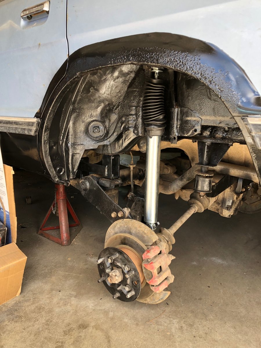

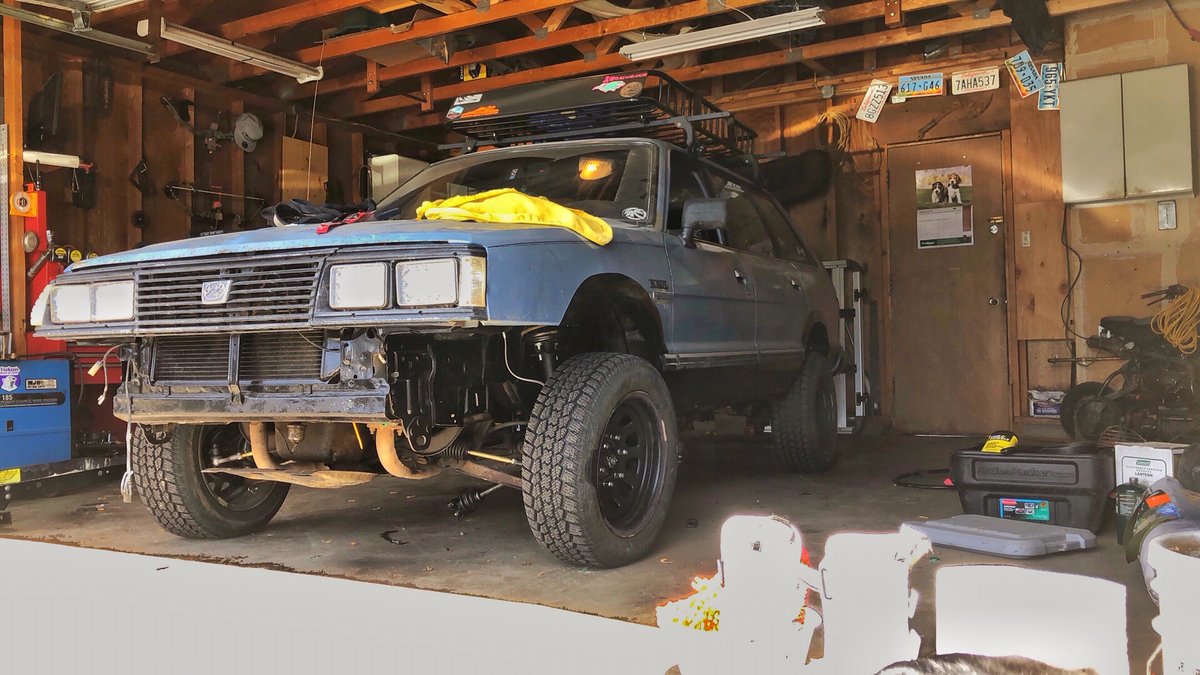

The rear end is all together and DONE :banana:
only thing I need to finish the lift is front extended brake lines which I’m going to order today.
I used a Rancho RS7241 shock for the rear which is supposed to just be the better quality of the Rancho RS5241 ADF and SJR suggest  I did have to drill out the upper mounting bracket on the shock to fit my bolts though they where too small  AB4C2C72-CF14-4177-A6DE-71EE42262FD0.jpeg
Edited by 83subaruGLchick

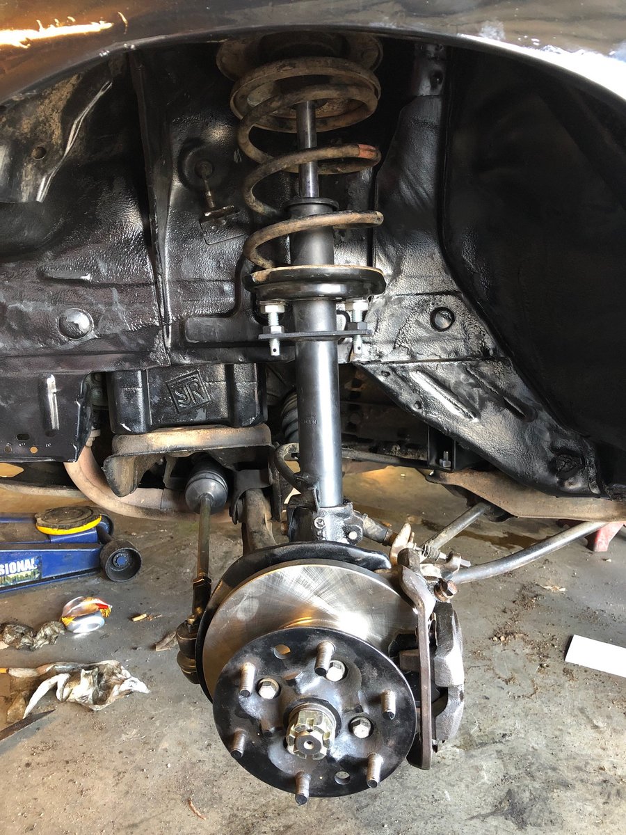

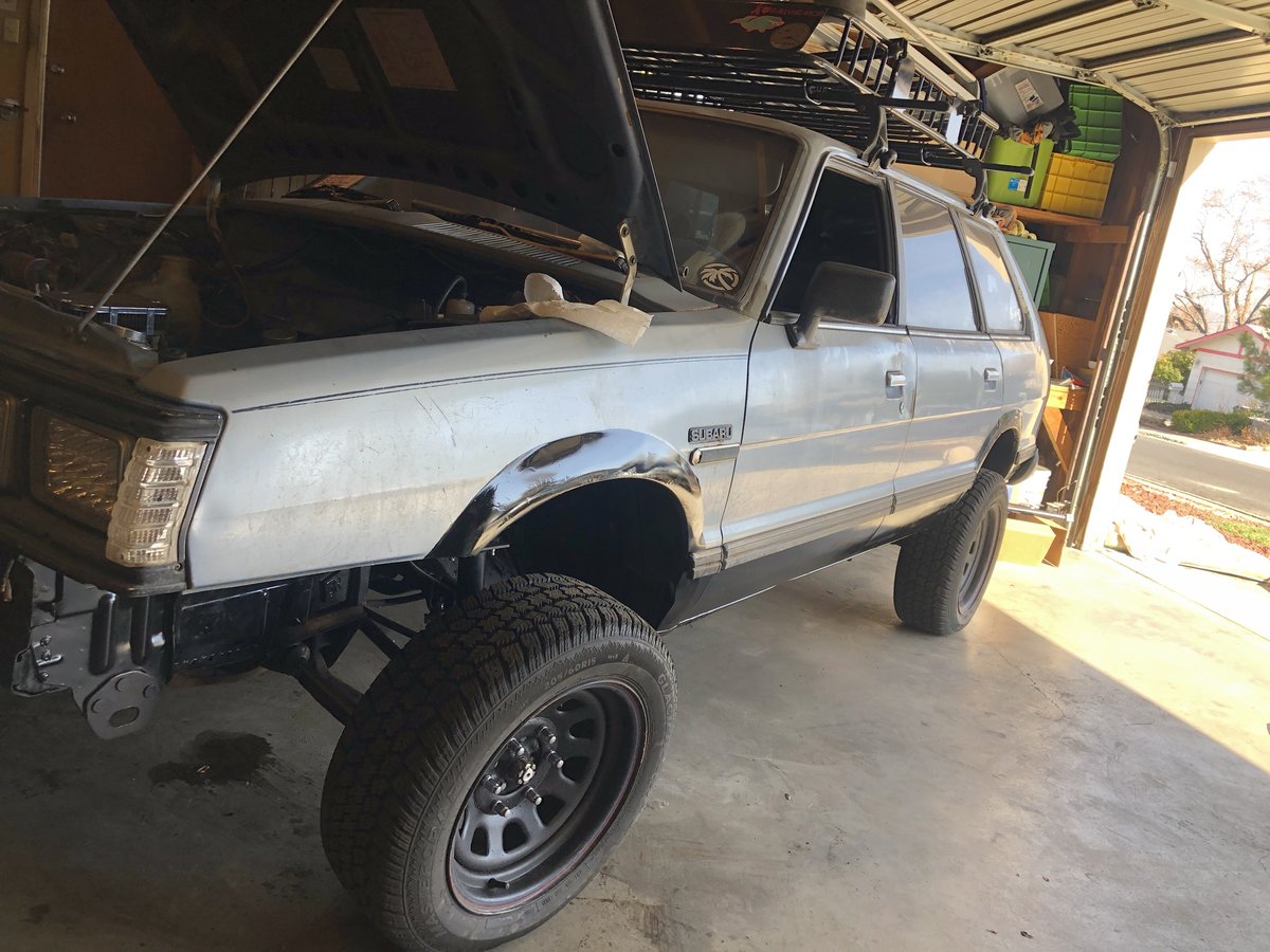

And here’s the front end. All cleaned up and together only thing missing is the extended brake lines and I also have to make the extended steering shaft. Other than that we are finally almost done! Take about a long time coming.
So just to do a quick summary of what I’ve been doing to this car since January I have replaced the following:
Front passenger side e brake cable
Front rotors and pads
Front brake lines
Inner and outer tie rods
Ball joints
Rear shocks
Front struts
Front CV axles
SJR 4 inch lift kit installed at the same time
This whole process has taken a lot longer than anticipated and it’s partly because I swear for a minute it seemed every old part I touched needed replacement as well as waiting for parts to come in, needing money for the thing and so on. I also cut the fenders sanded/cut a ton of rust off and painted the fender wells and around the wheel wells and rockers.

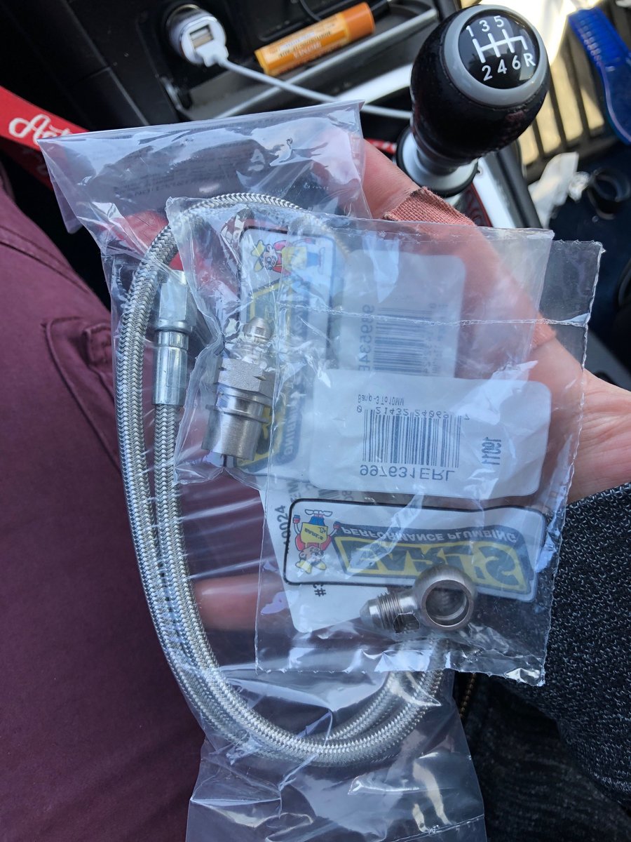

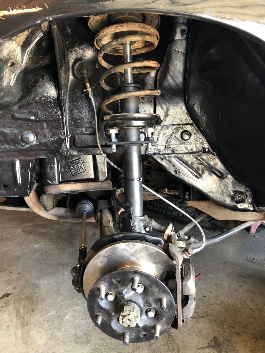

These where the solution to my front brake line mishap!! These are in they are working and they’re gorgeous. More pictures to come from today!
The lift kit is on! Just gotta finish extending the steering shaft and shorten the bottom radiator hose then I could drive her. :clap:

Brake lines in and bled :brow:
Everything looks great!
Get some wiring harness spiral wrap at Homeless Despot or auto parts store & wrap those brake lines to protect against flying rocks. ;)
1 hour ago, alexbuoy said:
Where did you get those brake lines
I just sent you the part numbers. But I bought them at summit racing.
STI brake lines fit the front of any EA81/82 series car (not sure about Gen 1s though).  I can also confirm that STI rear brake lines bolt onto EA82T/XT6 rear disc brake calipers (No idea about fitment to drums), just make sure the caliper is clean where the copper washer will seal against the outer body of the caliper casting.
WRX brake lines also fit but if memory serves me they are longer than necessary, but don't quote me.  Measure your stock lines, then look up the specs for the STI/WRX lines and make your choice.

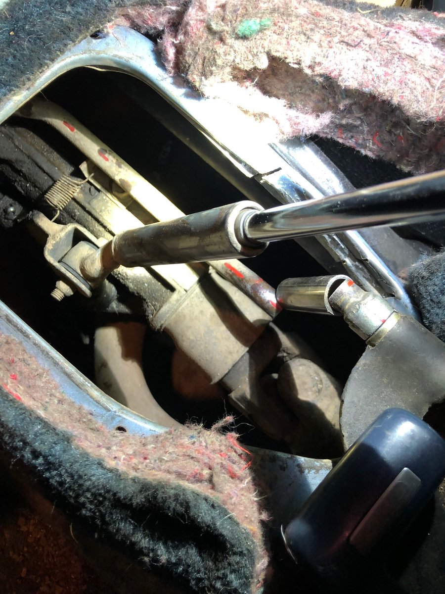

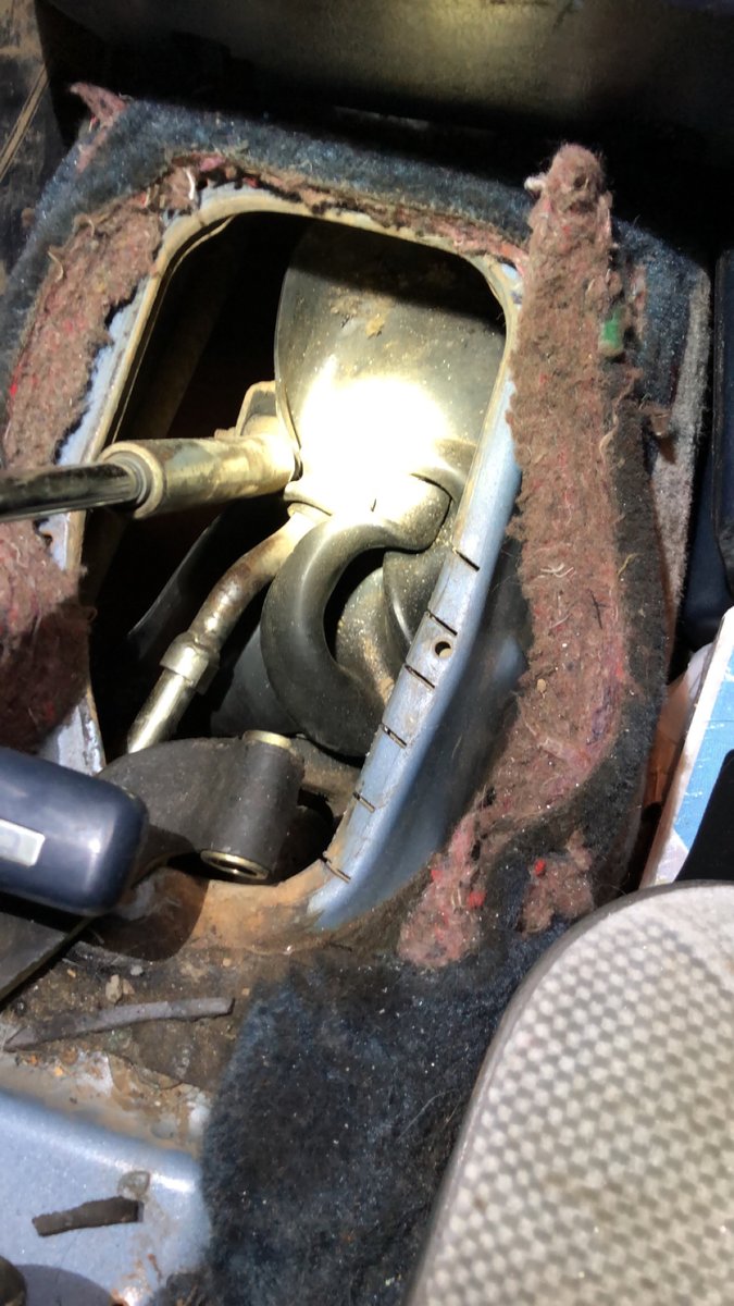

I just wanted to also say thank you guys that follow this and like my build it's awesome to see that although I'm mostly posting here for myself some people actually like seeing it as much as I do!  Okay so onto the updates, the steering shaft is in and extended I also replaced the crankcase breather hose because I went to move it out of my way and it just broke into like 10 pieces.. also had to get a longer vaccum hose from the intake to the brake booster due to the lift and shorten the lower radiator hose due to the lift as well!  I started her up last night in hopes of moving and driving her but I cant get it into reverse due to it hitting the body around the shifter so I'm just going to hammer it out a little and put the carpet back over it and you won't even be able to tell.  I figure while I'm there I'll probably due that 4 speed slop fix that I saw that involves self tappers...

Self tappers used in the slot and bolt trick? I’ve not heard of that.
What I did is probably what’s documented in the threads above: remove the tube piece with the ~45* angle bar on it that goes to the lever pivot.
Grind/cut a good slot in the tube, perpendicular to the bolt holes so that the slot goes beyond where the holes are. I cut my slot to be about 3mm wide.
Replace on the vehicle then drill the hole out to a larger size, this includes drilling the gear selector rod. Have a bolt that matches the hole size.  Place the bolt in the hole then do up the nut as tight as all buggery!
A lock nut will work well for this job.
You’ll feel like you’ve got a sports shifter once this is done!

Last night we cut and welded in the new 4wd linkage for the lift.  Just gotta go home after work and put her all together!!
So car is all back together reverse works! 4 hi and low work! Went to pull it out of the garage and it made it to the end of my driveway and the front driver side axle which is brand new broke into 2 pieces. I don’t know why this happened because the lift doesn’t change the angles I think it was just a defective axle or something. Anyways I’m going to have to take that whole side apart again and replace that axle but I’m honestly so frustrated with the car it’ll probably be a while before I do that. Also the transmission is leaking pretty quickly and it wasn’t doing that before either, not sure what’s going on there.
Here she sits. She will be sitting on the street for a while here in a little bit too because my roommate needs the garage for his Toyota crawler he’s gotta do some stuff. Would’ve been done if this car didn’t fight me every step of the way.
