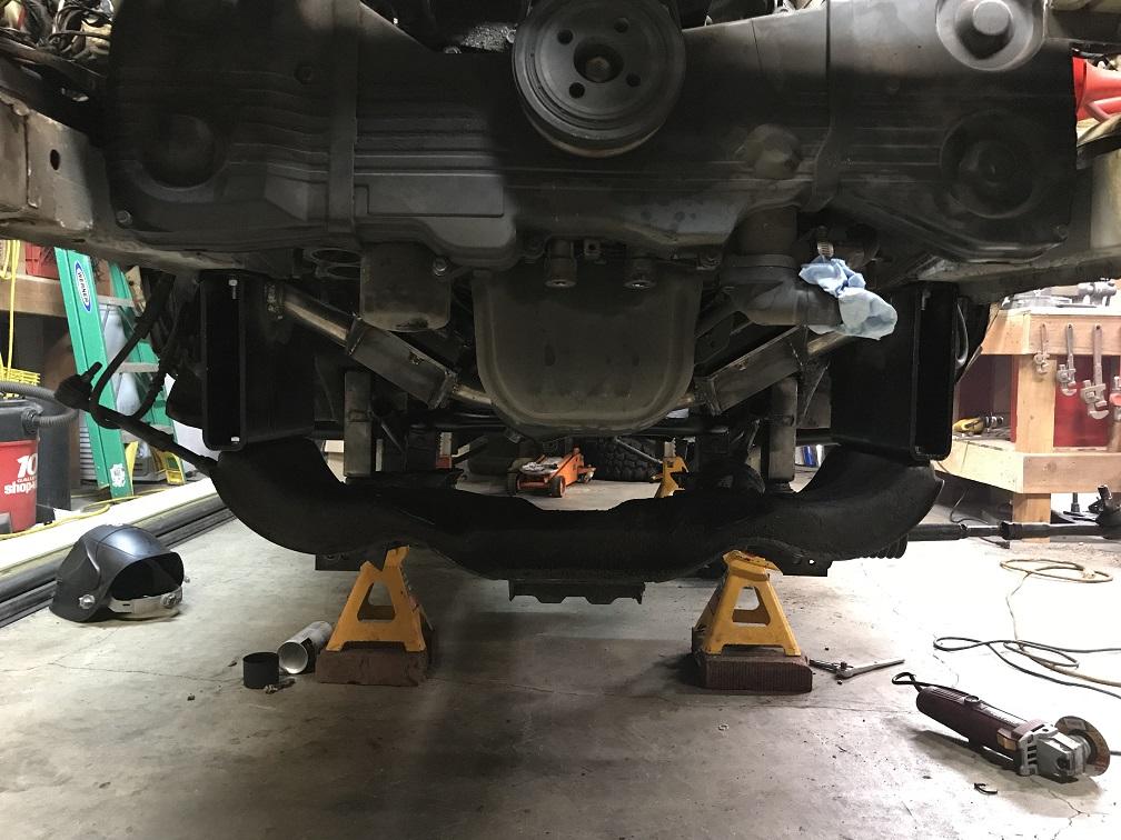

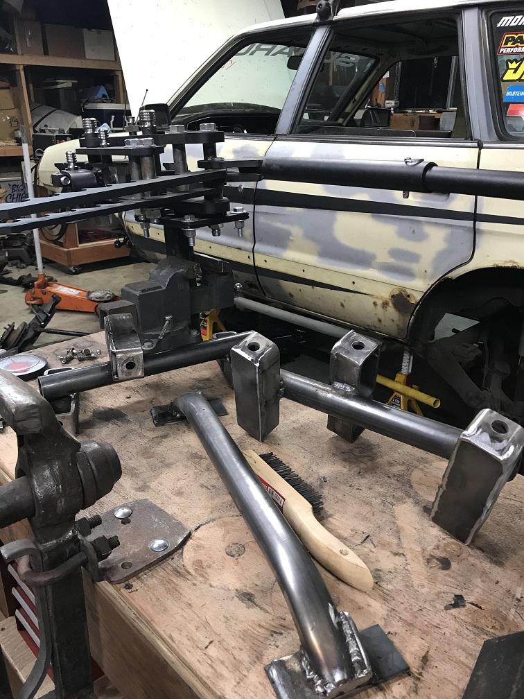

I used an old piece of mustache bar and welded it to the stock crossmember to support the front. For the rear I built a crossmember that bolts to the radious rod blocks and welded the stock mount to that. You can see the crossmember I built in the pic below before I welded the diff mount to it.
