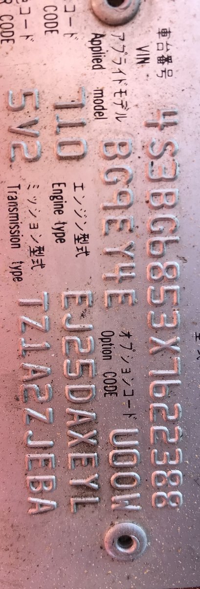

If the Legacy is a GT/ Outback or SUS in 1999 then your 2.2L will be a direct swap. If the Legacy was an L/ Brighton trim then it will have a 2.2L. In 1999 the 2.2L was " phase 2 " and is electrically fairly different than " phase one " which was used 1990-1998. The fender tag will say what it was originally. If it says EJ25D than it had a 2.5L DOHC, but if it said EJ221/222/223 then that is the phase 2 2L where you would need either another phase 2 EJ22, a phase 2 EJ25 ( EJ251/252/253 ) or a JDM EJ20 engine ( EJ201/202/203 ).

Ok, the seller was confused and it is an EJ25DAXEYL. Does that make a transfer impossible? The body looks great.

The EJ25D can be replaced directly with either:
The  95 EJ22
Or with the EJ25d in the 98 forester.  If it is in fact a 98.  If the forester is 99 or newer, it will have the EJ251 SOHC which will NOT work in the 99 Outback.
