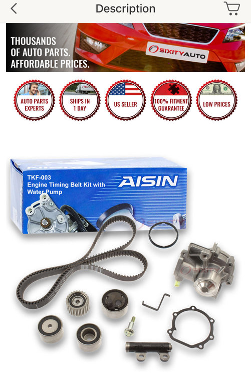

September 16, 20196 yr I need a little help and guidance with purchase of the AISIN TKF-003 belt/pulley/pump and tensioner kit... As the Legacy is running so well and giving no trouble, I thought it was about time to think about renewing the timing belt and pullies. And why not the water pump too? I often see AISIN mentioned, along with Mitsuboshi for the belt. I got searching and come up nil in Europe, all is SKF or GATES branded kit: I can shop around and cherry pick brand components I want, but it seems unnecessary. I last did the Forester belt change with the Gates kit: EU made belt and KOYO JAPAN stamped parts. 40,000 miles and no problem so far. No pump swap that time. I fancy the AISIN kit TKF-003 for the Legacy and only find it on eBay or US websites. The eBay vendor, when asked, answered that ALL the parts in the TKF-003 kit are AISIN brand. I’m not sure if that is correct, can anybody shed light on the actual contents of the TKF-003 kit? Thanks in advance
September 16, 20196 yr the kit pictured is a 1996 and earlier US market Subaru timing kit, is that what you're looking for? buy it, i'ts got everything you need except the thermostat. you can also buy from subaru if parts sourcing is a problem.
September 16, 20196 yr I'm fairly sure Aisin doesn't make the idler pulleys, esp the cogged one. Have them take a picture to confirm.
September 17, 20196 yr Koyo or NSK generally make the idlers/cogged pulley. NSF supplies the Tensioner assembly

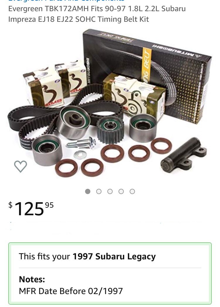

September 17, 20196 yr Author My Japan built ‘97 ej22 has the two-piece tensioner as pictured. I am waiting for a more detailed answer from the vendor of the Aisin kit. Elsewhere, I have found a decently priced kit using GMB pulleys, and a Mitsuboshi belt, the water pump I can find separately Any experience with GMB conponents? I have not read any bad reviews of GMB, and the price is really good:

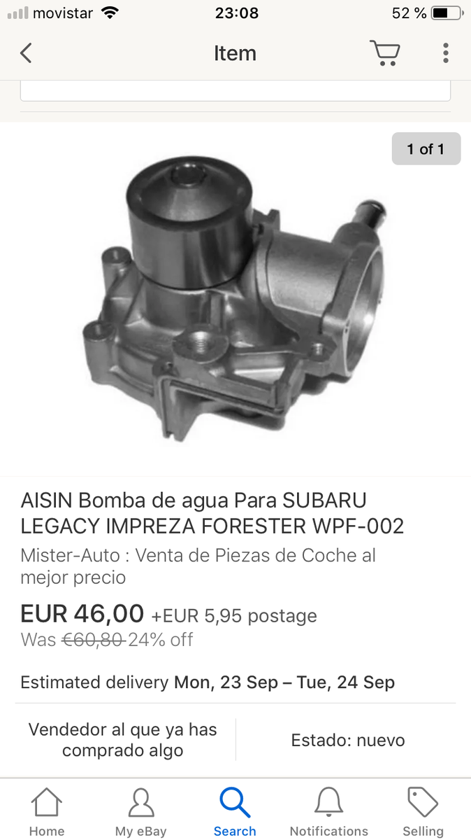

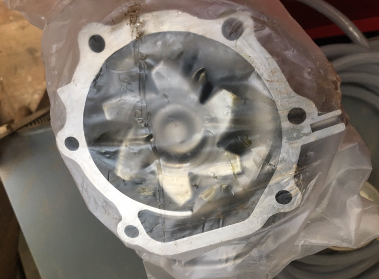

September 17, 20196 yr Author Doh!! ..and suddenly I remembered that I have sitting in the cupboard, a new pump... Edited September 17, 20196 yr by Mitchy
September 17, 20196 yr I’ve used a number of GMB kits before and have a few GMB timing boxes now. in general I’d avoid them for long term vehicles, valuable cars, interference engines, etc. I’ll install them on rusted out beaters that have maybe two years left before the frame rots through. Don’t get me wrong, they’re decent enough and don’t have high failure rates so you’d probably get by fine. but nearly every aftermarket kit has higher failure rates than Subaru OEM. GMB doesn’t have a magic supply of OEM cheap parts no one else can find. Those two piece tensioners are like $150, id wonder if that’s s knock off or rebuild and looks like OEM. When it comes to parts that will strand you, or interference engines, I prefer the highest quality you can get if they don’t cost much more anyway. If someone begged me to install a GMB kit for them and they want to save a few bucks on your car i would but first I recommend to save a few dollars: 1. Subaru belt and pulleys only (no tensioner) 2. Subaru belt and the lower cogged idler (by far it is the one that fails) and I’ll inspect the the others. The other ones very rarely fail. If you can DIY they can be inspected in 2 years or 40,000 miles in less than an hour, they’re super easy. Those two piece tensioners don’t fail, I’ve never seen it but I’m sure it happens sometimes. They were routinely reused and I’d even convert new Subaru’s to the old style before they got old. If yours is in good shape, the seal isn’t wet - It happens so rarely and you already have a water pump, just buy the timing belt and pulleys from Subaru. I’d almost rather keep the OEM original tensioner and not install a new aftermarket unless it’s OEM new (not rebuilt) 3. If they didn’t like those options I’d still install the GMB kit without much concern but to me there’s just no compelling reason to do so and depending on the car/person I’d tell them I’m not touching it if there’s issues ! Haha That said - I only work for free and don’t charge labor, so it’s easier for people to accept the higher cost parts. If you’re paying labor then the higher Costs changes the decision making process. Edited September 17, 20196 yr by idosubaru
September 17, 20196 yr GMB is chinese garbage parts. If you see those green bearing seals, run. The Aisin boxed kits are fully Japanese parts, from what I have seen. NTN tensioner, Koyo rollers, Mitsuboshi belt. Just used one of those kits for a 08 WRX.

September 17, 20196 yr I stopped using gates due to the crap components ( especially water pumps) they have shifted to. AISIN are not cheap, but they use all higher quality parts and are a lot cheaper long run than going back in to swap out a leaky or failed pump or ......idler!!!!
September 17, 20196 yr Mitchy Look at the two smooth pullies in both pictures you posted. In the top pic they are side by side and one is flipped over in the second pic one is on the left and one on the right. In the first pic they have 2 bearings per pully. In the second pic of the GMB and you'll notice they only have 1 bearing per pully. I tried GMB once and those two pullies lasted less than a year. The water pump from the kit leaked at the shaft seal in 3 weeks. The belt was Dayco so I reused it on both repairs.
