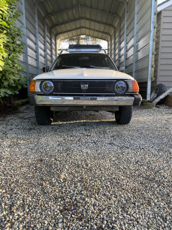

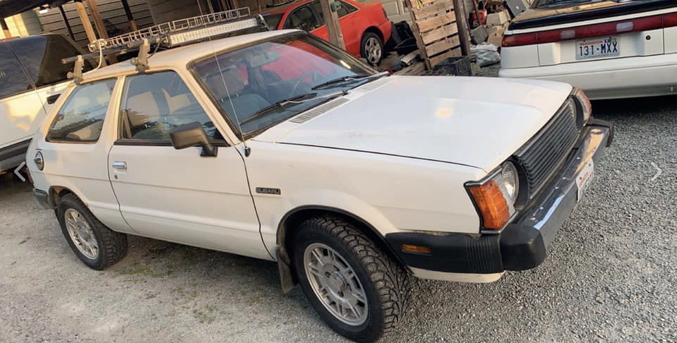

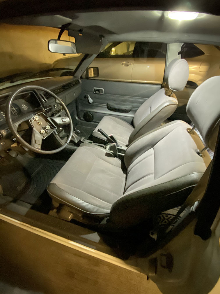

I recently purchased an 86 Hatchback that i'm trying to find a little more info on previous work and am assuming they
 were a member here due to a pretty extensive mod list, and this is the best place for that type of info and suby junky ;)
Details:
86 White 2wd Std Hatchback
182k Mi, 5 spd D/R 4WD conversion, 3.9 Diff, rear disc conversion, pug wheels, round eye conversion, roof rack etc
Looks like a lot of interior parts were swapped in as well as some crazy minivan seats I think.
I have been a member for a long time (djbroadus) but could not access my old account so here I am, This is my 3rd hatch and I am happy to be back.
Thanks for any info
K

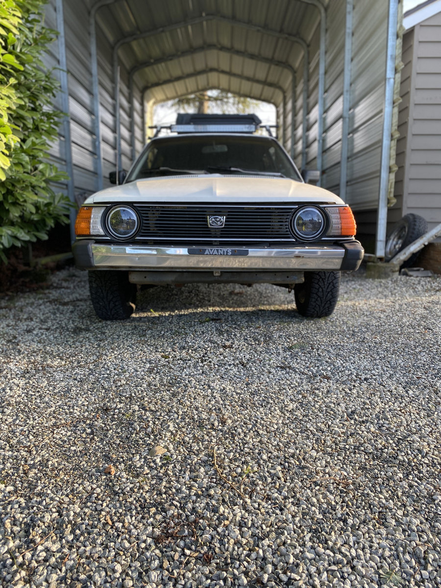

Also if anyone is looking for a round Eye conversion i'm thinking of swapping back to the 4 light set-up.

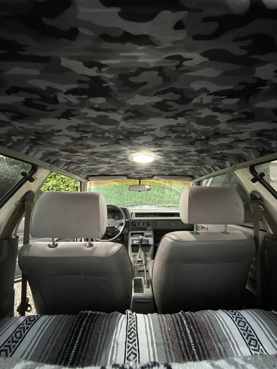

Swapped out my old crap steering wheel to a justy one, as well as re-upholstered my headliner.

Nice Standard Hatch, own an '86 STD myself. Basically the least amount of options and frills were put on these... the base of base models.
Today that is probably a blessing because there is less to go wrong.
Quite a bit of mods to make a fwd hatch into a 4wd; trans, rear driveline, mustache bar mounts, rear diff and axles, fuel tank swap, etc... if you have the 5 speed dual range the rear driveline must be custom as well.
The round lights came factory on the STD's. If you want to go quad-light you will need to mod the radiator-core-support, as well as your headlight wiring to match the new light pigtails.
The fuel tank is smaller, usually takes less than 10.5 gallons for me to fill up. You probably have the 4wd tank installed, which is different to accept the rear diff and mustache bar.
Edit: now that I'm thinking about it, because you have a lift kit on (not sure how many inches the lift blocks are on the back) the lift would make the rear-drive mechanics clear the factory tank.
