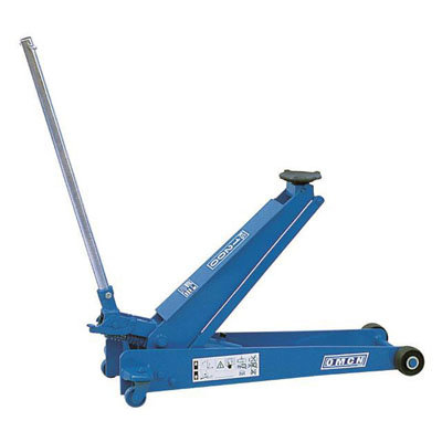

May 30, 20205 yr Really enjoying my recently bought professional OMCN 2500 lbs. jack, it's one of those thing that make you ask "how did i do without one all these years"... Was new old stock sitting in a shop that closed, cant complain at 150$ One question though. Following a post ive read here, i lifted the rear pushing the rear diff, but didnt really like what id does to all the rubber mounts that visibly compress..... Am i worrying for nothing or are there better ways to lift the rear wheels? Cheers TG
