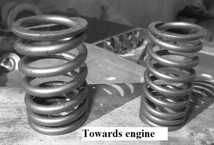

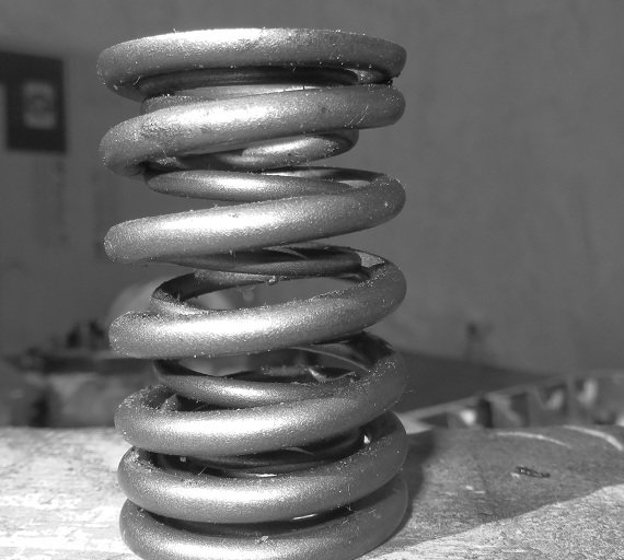

EA82 valve springs. Closer winding is towards engine. [I learned THAT the hard way]
What is that off of?  Are all EA82s are like this?  I’m not home but I don’t think I’ve ever seen any like this.  I’ve got a few heads and engines at home I’ll look and see if that jogs my memory
another thread says they’re all the same.  Weird.  This is an artifact of them being too old and rusted away around here so I’ve forgotten now that I don’t work on them much any more or there is some difference. I’ve worked on mostly XTs maybe they’re different.
Edited by idosubaru
These valve springs pictured are from a salvage yard EA82 (SPFI) . I don't recall what model. I also bagged the distributor which has the crank position sensor, if that helps identify the model or year.
However, I just checked the recently removed EA82 from my 1991 Loyale. It does have those reverse wind inner valve springs.
Yeah man I saw pictures online of them and another thread mentioning that many (all?) EA82's have them.   I'll check my stuff when I get a chance, XT6's are definitely single spring, maybe all XT's are an i've just done too many EJ's since then and have forgotten.
Have heard that double reverse valve spring was in theory a way to reduce vibration.  Now, did EA81 have them? If not then maybe the same brains behind the OHC was behind this "doubled reversed" spring.

Ido, when you said learnt the hard way about springs up the wrong way....what symptoms did you have ???
