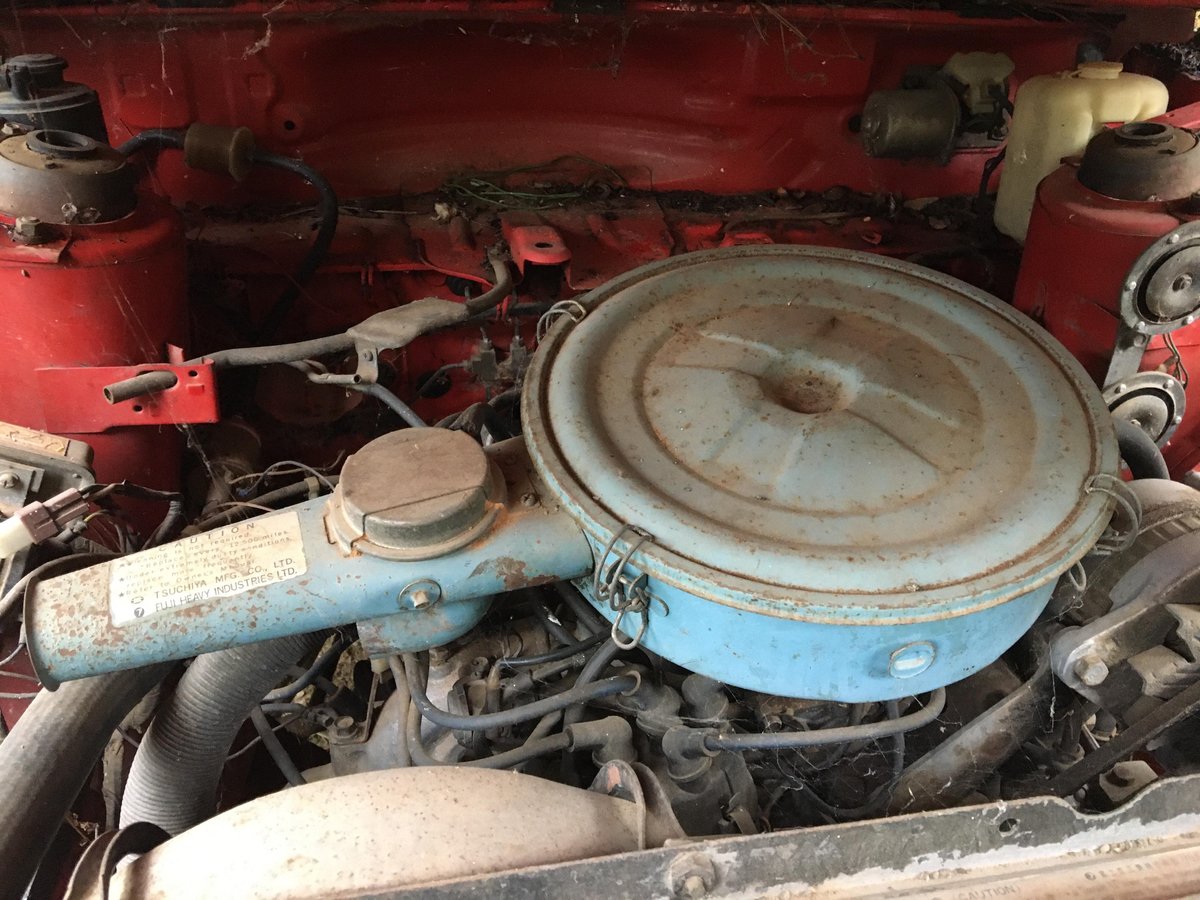

And for parts, I know this page sells a lot of stuff so I'm sure that if I needed something my best option would be to look on here first? I will include a pic underneath the hood, so y'all can see what is up with it. Sorry it's not the best picture but it's the only one that I have of this part of the car.

first impressions, it looks pretty solid, not much cracking on the top of the shock tower rubbers.
no rust at all where the spare tire goes, whats up with that?!?!
looks like the vehicle may have fuel delivery issues, the pump isn't where it's suppose to be, could be dangling underneath?
and it has the not so awesome Hitachi Carb that all these originally came with, i remember the pain to work on that original carb even after rebuilding it.
that's all the input i have about it based on this one picture, maybe someone else can see something i don't.
I don't have enough experience to even know where the pump should be lol, could you point that out? I will probably go up with knowledgable friends to check it out before I purchase it but it is far away so the more info I can get from home the better. Thank you for your help!
