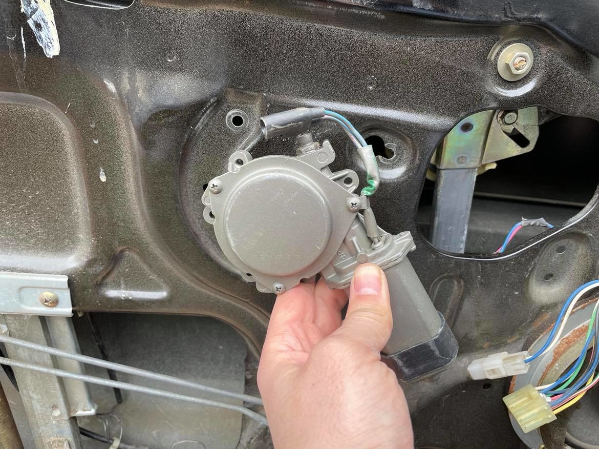

87 XT door innards, window motor.
Hey all. I am repairing the door to an 87 XT coupe, and it is missing it's window motor. I have already checked Rock Auto for a new one and they don't have it. So my question is, does anyone know if a different window motor will work for this door? Thanks in advance.

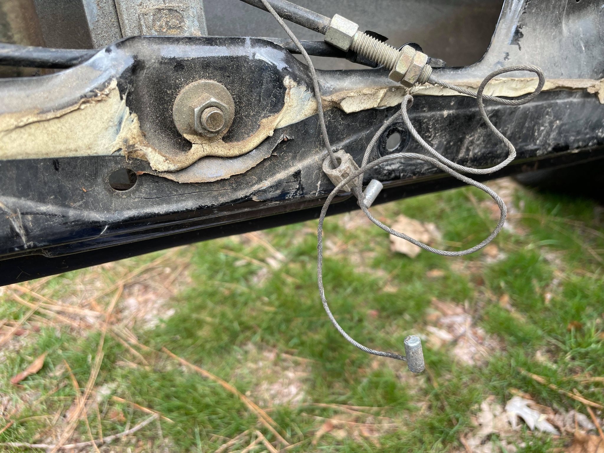

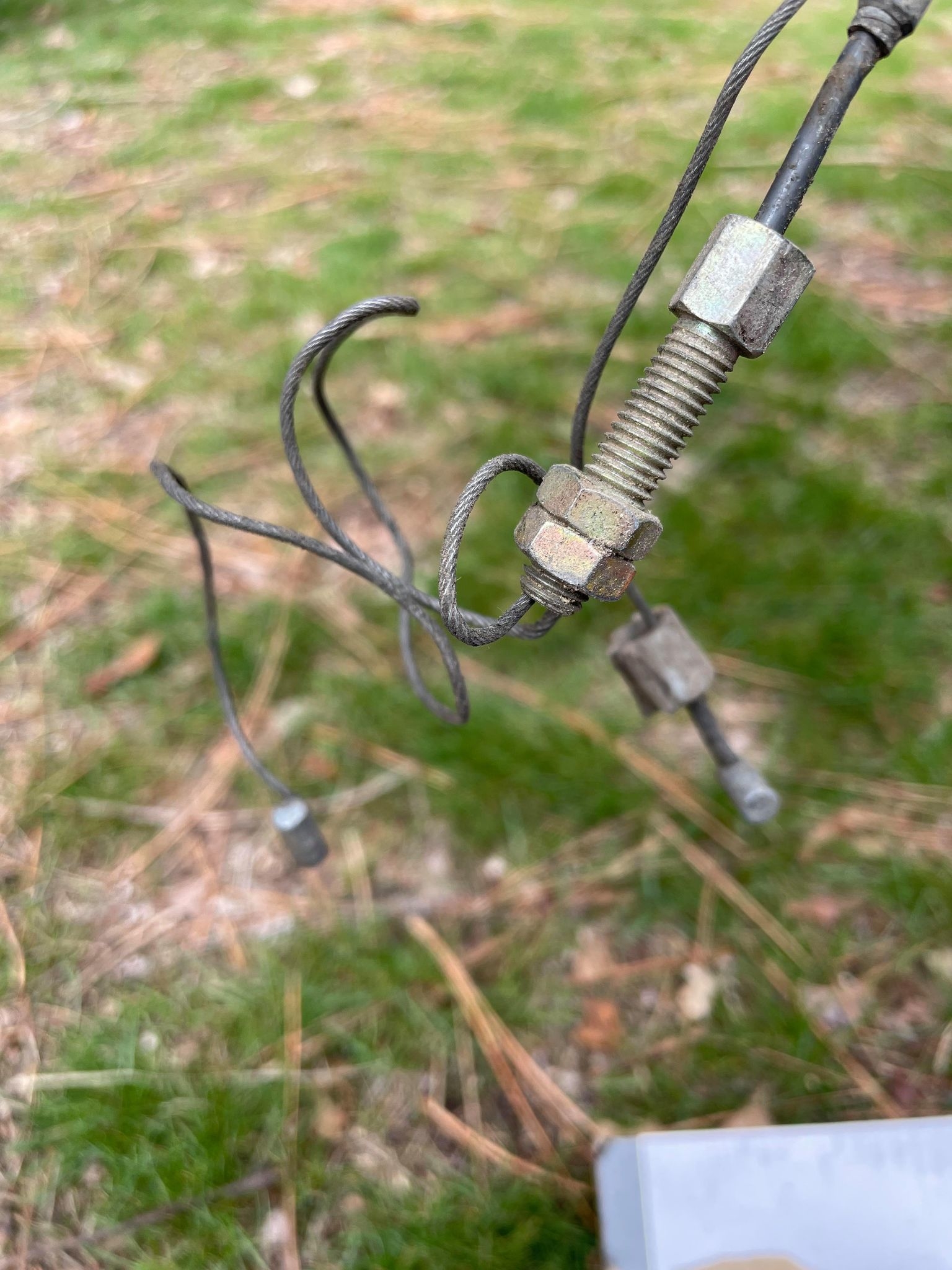

I have the regulator from an 87.5 parts XT. It's not good either, the cable is all kinds of mangled. Anyone know of a gear/linkage type that will fit instead? Not a big fan of the cable types.

I also have a tangled cable mess. 164432890_457260195392698_1651967579860373370_n.thumb.jpg.7034a788ba4260cbfd4190d131f0e08a.jpg164501152_946377759443384_656082931281230829_n.thumb.jpg.204c9b97806ced262db3a26964768d34.jpg166055446_313431936801507_1172657140981331226_n.jpg.d7471de2f39423faadfd4d8c561bbcaa.jpg
