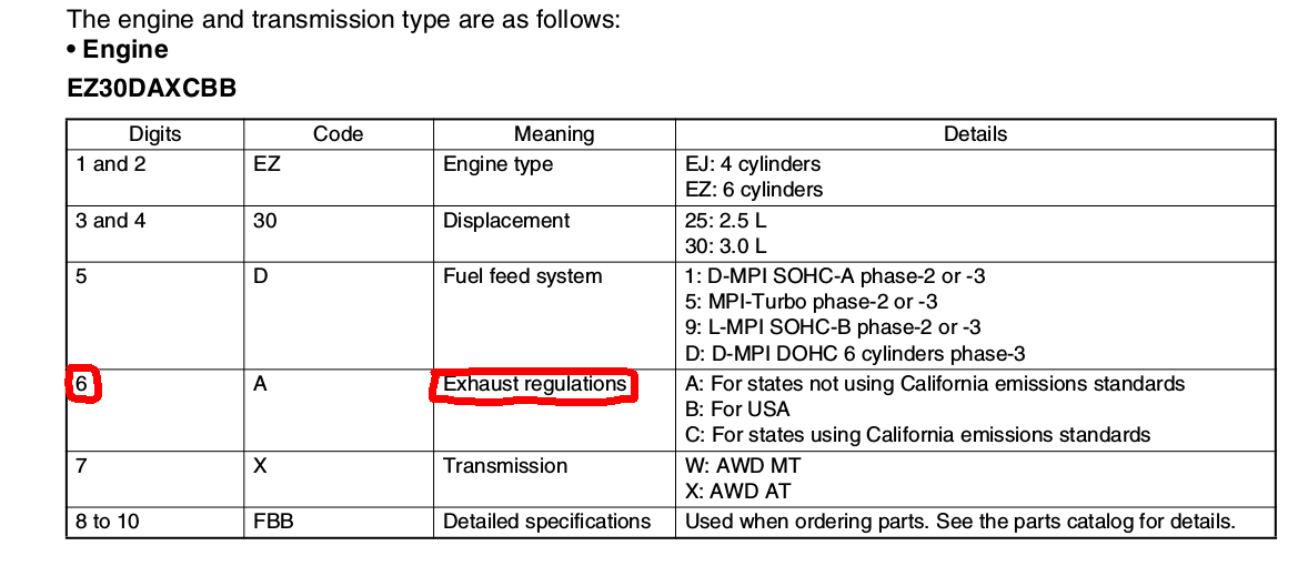

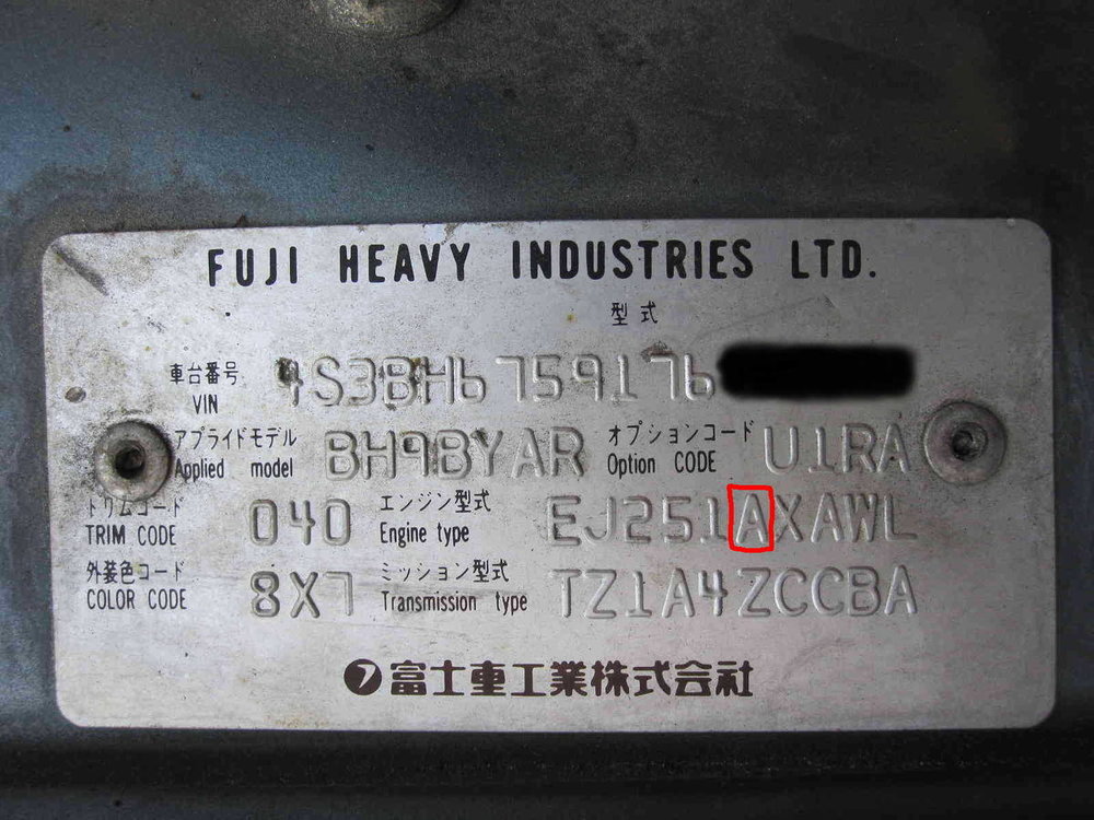

Question about Gen 2 emissions equipment.  The attached dataplate image is from a 2001 H4 4EAT OBW I looked at last week.  The other image is from the 2004 FSM.
I have read that PZEV hurts engine performance and economy, and is more expensive to repair.  According to cars101 PZEV appeared on the OBW in 2004.  Should I try to avoid the 2004 California OB's?  Presumably this would be "C" in Engine Type.  I am in the People's Republic of Kalifornia if that makes a difference.  I will need to register the car and pass emissions testing.  Interested in how undesirable it is to have PZEV on the car, not interested in discussing climate change or any of that stuff.
Related question: does anyone know if a non-California emissions 2000-2004 OB can be registered in California without difficulty or penalty, or be rejected for emissions testing because it's not a California emissions car?  DMV is impossible to reach right now or I would ask them.
