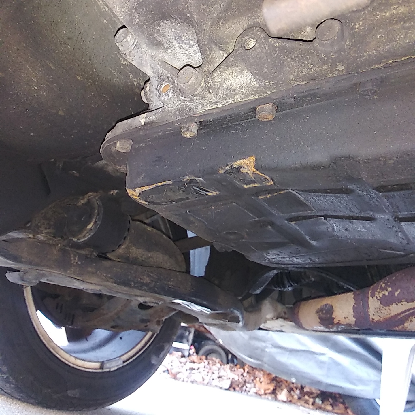

If covered, ignore: Check for a dent in the underside of the trans pan. When I 1st started working on Subes, I jacked it up on the pan (newb!), dented it and it broke a wire inside.

A dent in the transmission pan? You mean like this!? Notice the yellow / orange paint that rubbed off whatever he ran over. Curbstones are often painted that color around here. :banghead:

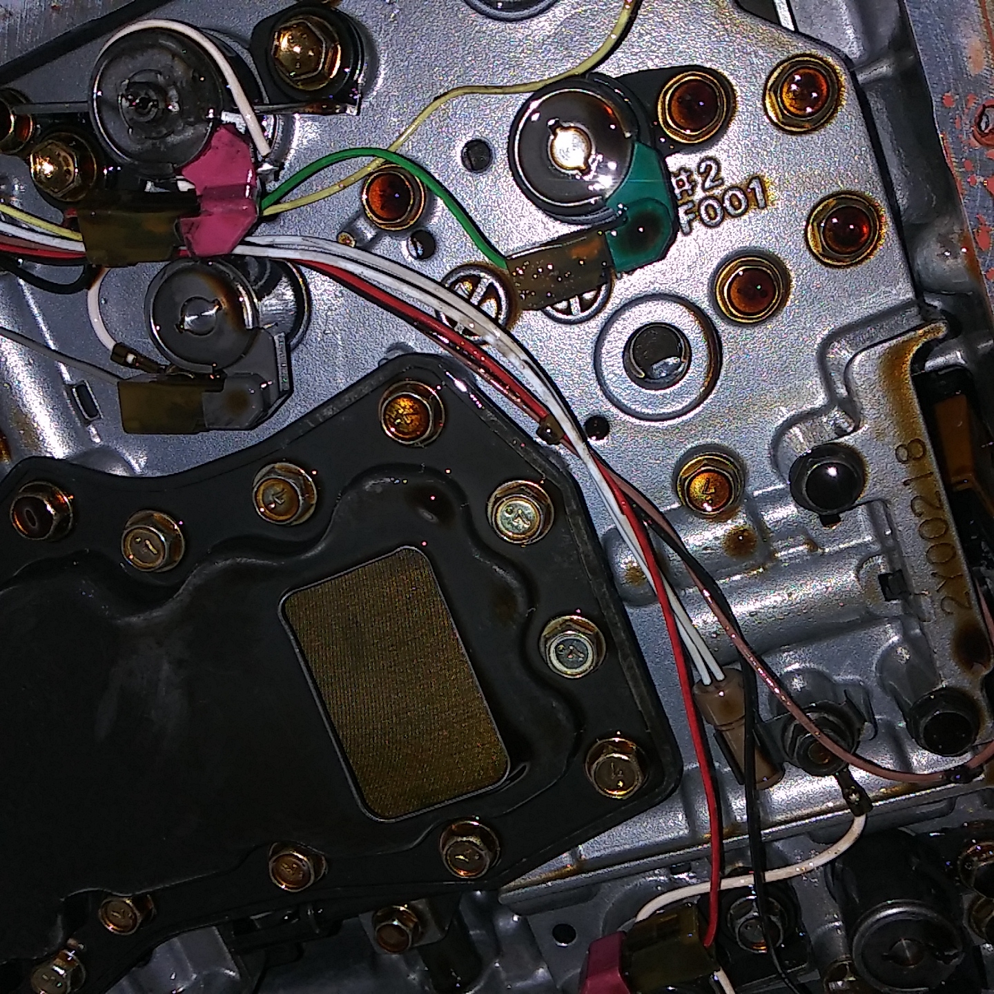

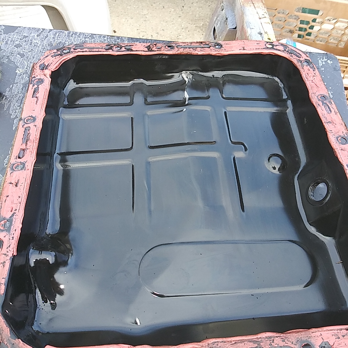

I dropped the pan. There are no broken wires. I can not even see any with pinched insulation that might gave been grounding out. It is still pretty oily in there. I'm going to let it drip overnight and give it a more thorough inspection tomorrow. I'm still trying to figure out which one is the shift solenoid. The infor I get by doing a web search is almost useless, Most of the Subaru transmission pictures I find don't look anything 429719617_Inside1.jpg.12eea10600fbf9497bd37b30e8330412.jpglike this.
2 hours ago, heartless said:
that long crease will definitely impede the flow of fluid in the bottom..  clearances are pretty slim in that area.
might almost be worth sourcing a different pan, as bad as that one is - car-part.com is a great resource
There is no way I'm reusing that pan. A web search tells me that I can get a new one for under $50.
I tested the "A" shift solenoid - the one with the green wire. It's an open circuit. I took out the bolt that appears to hold it in. I can spin it and it drops perhaps an eighth of an inch but it won't come out. I do not want to force it for fear of causing more damage. I'd rather not take out the valve body. I can not find any videos or instructions to remove the shift solenoids and most of the how-to videos on replacing the other solenoids have the valve body removed. Anybody know how to get the shift solenoid out? Does the valve body have to come out?
