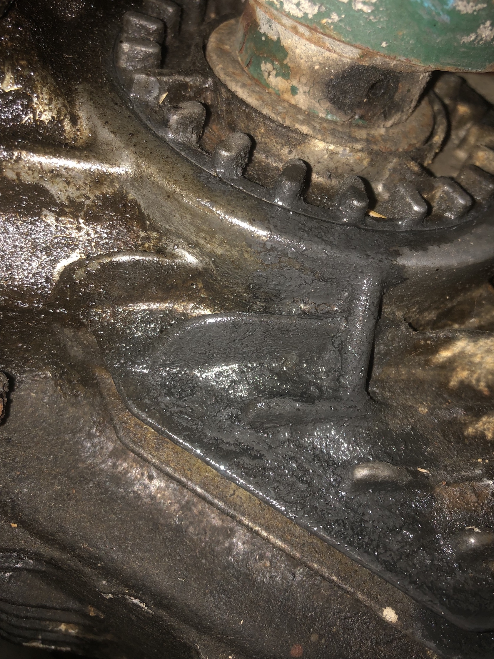

Since the beginning, we notice some oily aluminum filings near the RH side of the front diff, the retainer seems a bit loose.
Not knowing what we were doing, we took a bad decision : we tighten the retainer 3 notches.
This appends 10K miles ago, during these 10K everything went perfectly right, only oddity, a little noise, when hot, accelerating in uphill curves.
Noise is low and similar to shaft ones (clac clac)
Last week, when we put it back on the pit for changing oil, we discovered, as you can see on the attached picture, that the leaking problem seems worst and that some oil exited thru the gauge.

Thank you for your reply.
I was afraid that someone with Subaru knowledge reply that. Replacing transmission is a lot of work, and we are not even sure that the other one is totally compatible (it's a 2001 and we saw some differences on VDC models between 2001 and 2002).
Did anyone succesfully set the backlash, in place and without Subaru special tools or is it just impossible ?
Do you think that it's possible to judge how bad is the diff now by looking thru the flush plug ?

I doubt you have any options. No one knows enough to tell you how to do this and probably no one has done it any statistically meaningful number of times in potential failure situations.  You’ll simply get no replies and any reply you get won’t carry much weight
Ive had one bad diff I nursed and looked into backlash and preload options and got nowhere. Trans ended up driving poorly and locking up after 10,000 miles or so.
Once it starts down the path of eating the gears - no amount of setting the lash is going to fix it. You would have to get a new ring and pinion and that's not economically viable. Replace the transmission with a used one.

This is similar to what used to happen to the EA82 autos - the seal between the diff and auto trans would let go, auto fluid and diff oil would mix, pinion bearing would give out and end up allowing the pinion gear and shaft to move forward to munch the centre of the diff. This usually resulted in a front wheel lock up and a destroyed front diff.
As others have said, a replacement transmission is the way to go. The hardest part is unbolting the torque converter from the flex plate I reckon. Keep the torque converter in place when removing the old and fitting the replacement. Or get a shop to do it for you.
The sun dials are only going to be a band aid measure at best I reckon.

Today we flushed the diff after one last test with the mechanic (my brother) behind the wheel.
For him, the car is working very well, no shaking at all and the noise is very low and only when turning left, he’s not sure that it came from the diff, maybe shaft.
He has experience with bad transmission but not on Subarus.
Before flushing, we took temperature of the diff : 150 °F on each side (after about 12 aggressive miles)
One shaft was hotter than the other and was missing grease, we’ll replace it (maybe it’s the noise).
We also think that the dipstick o-ring is bad, may the reason why we have oil exiting from the top.
The oil level was good, the oil is very nice (no metal or ATF).
As you can see on pictures, residue on the plug is very limited.
For my brother, it’s premature to replace the entire trans now, he would like to change seals and the retainer on the RH side, and put it back as it was at the beginning (loosen 3 notches).
He think that what is leaking is aluminium that come from the retainer or the bloc, maybe dead retainer o-ring and vibrations ?
Our problem is how to change the retainer without loosing the backlash setting, we will count the turns extra carefully, any other method ?
Do you think it could be better doing the FSM AT-78 procedure ? Any advice ?
Maybe, as you said, all this will end up changing the trans, but we will try not to.

Install a used or new Subaru axle with fresh grease and boot.
Maybe that’ll take care of the issues.
Mark retainer location to trans case, count turns and reinstall to same position.
plug looks good to me - minimal residue.
I realize it is xtra work, but axles are L-R exchangeable, then, if the turning noise moves with the axle, that should exonerate the diff right?

Mark it with a paint pen.  Or use a center punch.   Then count the number of turns when taking it out.  Do one side at a time.
If it's really aluminium, it sounds like the bearings are so worn they're grinding away the case.
