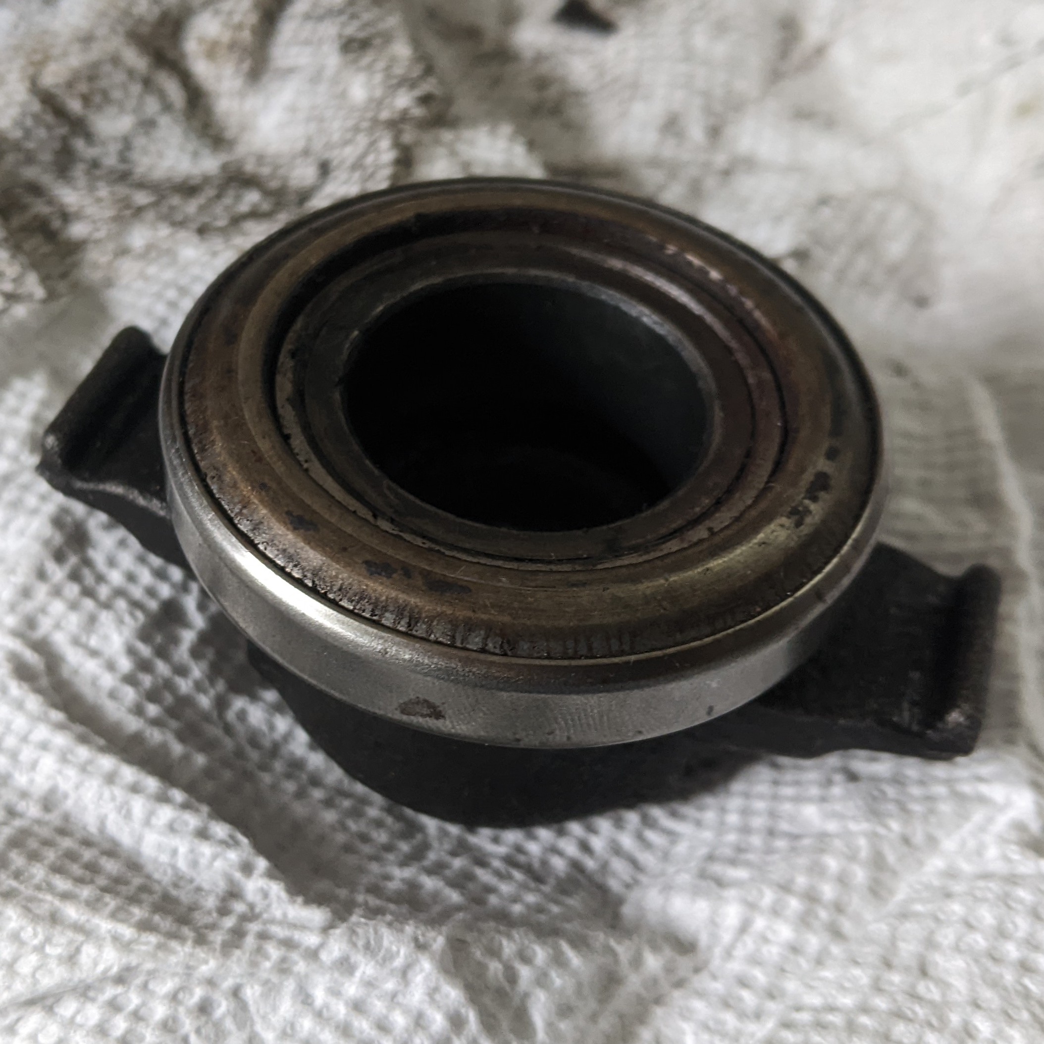

I happen to have an extra (bad) bearing on it's carrier/assembly/whatever and I took a photo of it in case it helps. The bearing has an inner diameter of 35 MM. Anyway, if anybody could point to a source for the right bearing I would greatly appreciate it. Any help would be greatly appreciated.
You likely got the TO bearing for the early “Loyale”.
Thats for an EA82 engine which is the OHC 1800 as opposed to your EA81 which is OHV 1800.

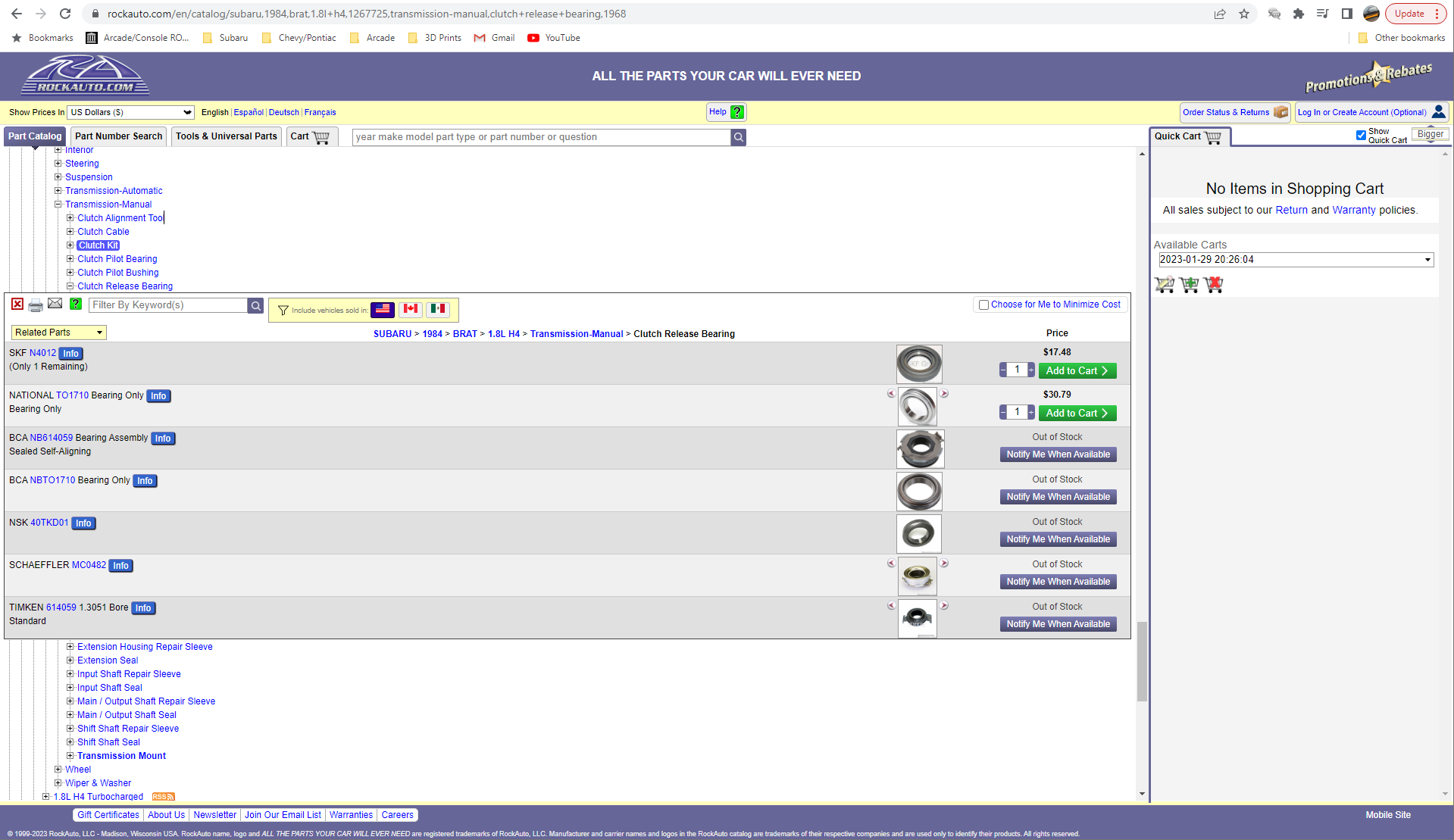

From the Beck Arnley catalog I can see you need their part number 062-1125
I would search ebay for that - Beck Arnley Subaru and the part number or just type in clutch release or throw out.
The original part number from Subaru is 43151 7000 which your local parts guy likely won’t find. There is likely a supersede number. They like to add letters to the part number carrying them forward. I’d guess they threw an “AA” in there but that’s it’s own story.
