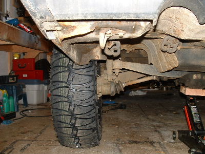

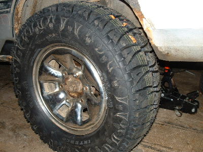

January 23, 200521 yr I'm still new to USMB so if I sound like a retard I'm sorry. but I have had my 88gl for about 2 years and i feel that it is time to experiment:brow: I want to lift my wagon and from what I hear its not too hard??? i was wandering if i could keep my stock steelies and get some good off road tires for them? has anyone done this. would these work http://www.intercotire.com/html/tsl___radial.htm the 14 inch ones
January 23, 200521 yr your stock rims are most likely 13 inchers.you either need to source some pug rims , buy some stock 14 inchers from oz, or do a six lug converson and run 14 or 15 inch rims.........and yes ,people have gone as big as 33 inchers with the proper lift and other accompaniments.
January 23, 200521 yr Here's a good thread discussion tire options: http://www.ultimatesubaru.org/forum/showthread.php?t=24979&highlight=tire+write-up Yes, you will have to get larger rims. They don't make tires much larger than stock size for 13" rims, and nothing that would be considered an "offroad" tire.
January 23, 200521 yr IMHO forget pug rims and drill your hubs for six bolt rims it's easy to do, read the tire write up at the top of the Offroad page there's a link on how to do it. 15"x7" rims open up a whole world of tire choices.
