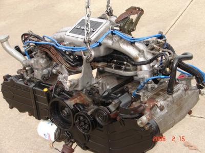

February 23, 200620 yr Author awesome thanks for that link steve. i appreciate and printed it! what is an "L" series that you refer to? you mentioned you got an engine code after the swap, recall what that was? my donor motor doesn't have the a/c or alt on it, but appears to have the brackets. both being XT models (where yours was an XT to RX swap), maybe the alt and a/c will bolt in place? i'm converting it to XT6 electric power steering so no issue there. it has the crank pulley on it. i don't have the dogbone, i'll have to fabricate something for now. thanks for that heads up, i'll put an order in the parts wanted section. see how the throttle cable goes as well, that should be interesting. that might be my biggest concern at the moment. thanks again steve! here's a pic of the donor motor.
February 23, 200620 yr L-series refers to the sedan/wagon/coupe body. Since you're doing XT to XT, your original dogbone will be fine. Same goes for the belt driven accessories, just slap them on and go. Throttle cable will also be the same. Actually you won't have to change a thing besides the intake and exhaust hardware. P.S. - got any plans for the spider intake on your original turbo engine?
