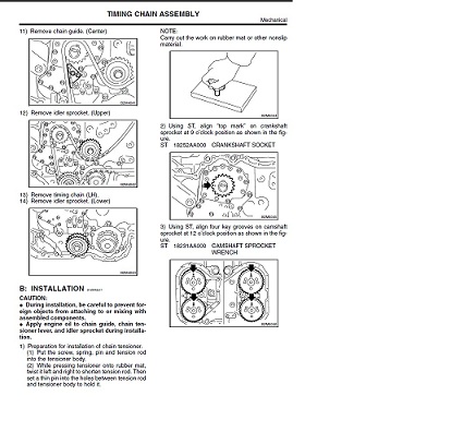

September 1, 201015 yr what do you have it apart for? that's awesome that you're digging into it. how has the job been so far, any difficult parts? i'd love some feedback as i will be getting into a timing chain some day as well, we have an H6 OBW. i've yet to see anyone post that's actually done this so there's not much first hand experience on the subaru boards. i have the factory service manual from Subaru and here's the page on alignment, looks fairly straight forward and basically like most other subaru's with just a couple tweaks. if this doesn't show up, email/PM me and i'll send you a full size version, i had to shrink it to fit.
September 1, 201015 yr in case you can't read it, the text says: 2) align top mark on crankshaft sprocket at 9 oclock position as shown in picture. 3) align four key grooves on camshaft sprocket at 12 oclock position as shown in the figure.
