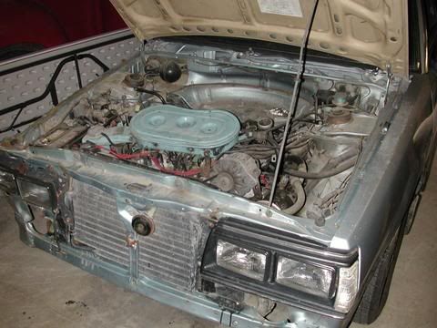

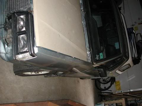

Front end looks pretty whacked - you are going to need a front clip from a wagon or something to make it decent again. No way all that structural will come back out straight. Too many crumple zones, and sheet metal with factory bends.

If you look the crumple zone, is not crumpled. It just needs a front core support and you should be on your way. If it is rust free and in NY, you would be a fool not to buy it.
Jerrys salvage title BRAT sold on ebay for over 2500, with still some dents in the quarter panel. No it will never be a 5000 dollar Brat, but show pictures of the damage, and the repair and get it painted it should be a solid 2000-2500 BRAT.
Right - the crumple zones look ok. It's just that if you attempt to yard on the front end with a rack you'll pull the crumple zones out too. That was what I was refering to - not that they are damaged, but that they make it more difficult to repair the damage it's got. A front clip is definately in order for that one - you may only need the radiator core support, but the final say will come down to the frame rails, and how tweaked they are. It may not be much, but even 1/2" will make it really messy, and could damage the alignment and driveability.
