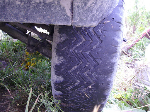

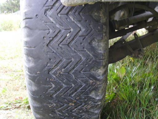

As I am securing the 4th set of tires for my lifted wagon in less than 1 year, i am thinking what could be causing the camber issue I have. I have discussed it with the board already, and no one can come up with any ideas. Then it occurred to me that it might have something to do with the fact that i made the lift kit myself, and i know its not perfect.

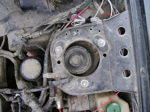

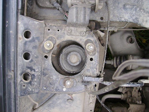

How did you make your homemade lift? Did mine 1.5 inches and its no worse than before... If you lift via the top of the strut then the key is to build the lift so that the top of the strut is angled further inward than its stock location...
i did a 2" lift out of steel tube and i cut it at a 15 degree angle, which was SUPPOSED to correct the camber.

Post some pics of how off your camber is and please post some pics of your lift and the blocks... I think I was able to go beyond 15 degrees something like 20 or so with just 1.5 inches, though I honestly don't recall exactly... But please post some pics...

well, that will effectively move the strut top straight down. but by leaving the engine crossmember, your control arms are angled down more, which pulls the bottom of the knuckle in. in order to correct that, your strut blocks need more than 15 degree compensation.
or, lengthen your control arms a bit (1/2" or so?)

i was out looking at it and it occurred to me that the top of the strut had to face a specific direction. Is that the case?

Bill its a mystery, John even cut another set of blocks with the 15* angle and it still has the same problem. I think that there is just something up with that car, I'm not bad mouthing it but I just can't figure out why it keeps doing it unless we just took a whole nother front end off like an 87 or 88 wagon and try that????????? I just dont know?????

Did you install them backwards? pushing the tops of the strut out instaed of tucking it in?
Yes, see my post above
the blocks are facing the correct way. i was referring to the top of the strut itself
