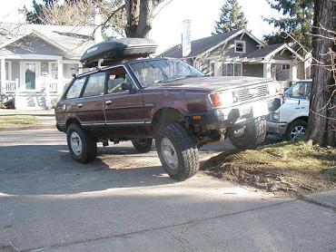

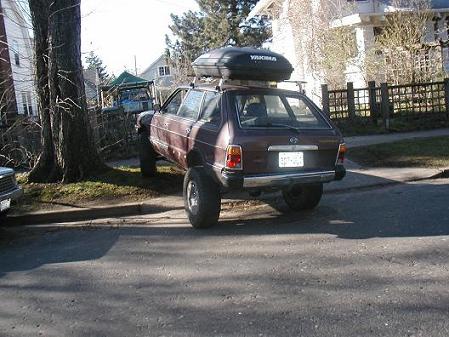

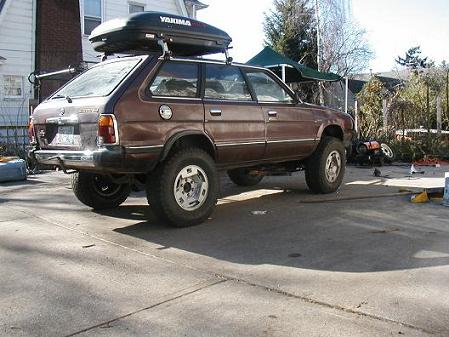

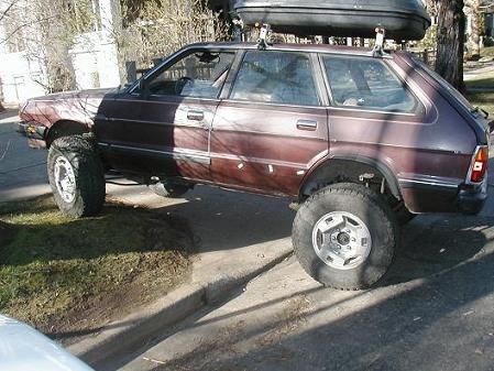

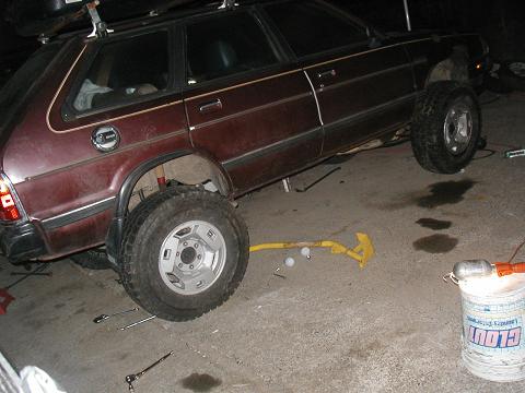

yeah, so its dry out, so I got some more work done.. hubs back from the machine shop drilled this time, so all the lugnuts are on and tightened down :-)
I have yet to take it around the block due to my exhaust problems.
http://www.ultimates...ntid=3479&stc=1
http://www.ultimates...ntid=3480&stc=1
http://www.ultimates...ntid=3477&stc=1
http://www.ultimates...ntid=3478&stc=1
http://www.ultimates...ntid=3481&stc=1

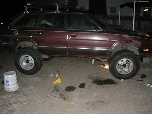

and a before shot...
http://www.ultimates...tachmentid=3269

btw, 6" lift, 31x10.50x15" tires, nissan pathfinder rims. perfect fit, could go taller w/ same width but would have to pound out floorboards ALOT. by perfect fit, some easy trimming required of front fenders, absolutely NO rubbing on the struts, with about an inch of room to spare. no trimming in back required.
all that is left for me to do is get my exhaust together, finish putting my steering back together, bleed my brakes, hit the gas and dump the clutch...(and finish off my bad half shafts...) :banana:
enjoy. hope to see you all on saturday.

Looking good.:grin: Those rims look good, how much trimming did you have to do in the rear?

havent done any trimming in the rear, although I drove it around the block a few times today with no exhaust... SWEET :banana: :banana: :banana:
the biggest problem is I need to take my bfh to the floorboards in the front, it rubs kinda bad there, steering got stuck trying to turn into coffee shop parking lot and I had to jack the front up, use a wrecking bar, deflate the tire a little bit and have someone help me wiggle it out. also if you got a lot of weight in the back, theres this little tab in the front of the back wheel well that will rub on the tire, gotta take my hammer to that. other than that there isnt much rubbing. btw if I put swampers on there now, I wouldnt need to use my bfh and sawzall, theyd rip all 4 of my fenders off in probably about 20 feet(I want to get 31x11.50x15 LTBs).
another problem i'm h aving is getting the steering tightened down, whenever I tighten it it forces the rod out of the coupling a little bit, and then when I turn the wheel it will jump and click and not actually turn unless I'm moving.

ok everything is back together, steering is perfect... rubbing is a little worse than I first thought. I either need to get an automated BFH, or go with smaller size tires, cause I can only swing my 5lb sledge so much with its 10" handle.
here are some day time pictures...
http://www.ultimates...=1&d=1139562143

looks hot! a little rubbing is ok, just make sure it's not on anything sharp. if it's rubbing on the inside wheel well, where it's smooth, it's not really an issue, but if your catching the edge of the fender, it'll make quick work of those tires!

Sharp. Very Sharp. I love the Hard Body wheels. Got the center caps?
How does it do on the freeway? I got this feeling you're gonna be looking for somewhat smaller tires if you're running the stock drivetrain. :)
You are right, or did I miss that thread. . . ? :-\ :confused: :)
Turning radius is the shnit. It's one of the very few things I miss about Subarus while driving my Toy.

hard to tell from those pics, but it looks like your camber's better already!

its settled out a little bit, but its still kinda bad. I can drive it. I dont have an exhausts on it yet, so I havent be willing to take it to far from my house cause I dont want to get pulled over. sure beats my neighbors alarm clocks in the morning :grin:

when we did the 8in lift we beat that part in as much as possible and then with our sturt block tight against it our camer worked out better then stock................ if your not up against that then your strut top block is not steep enough IMHO Looks Good..

that is true, it is not steep enough which is why my camber is off.
