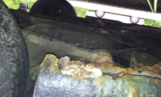

mattocs replied to mattocs's topic in 1990 to Present Legacy, Impreza, Outback, Forester, Baja, WRX&WrxSTI, SVXHere is a picture of the rust. This is the drivers side rocker near the rear wheel. Sorry its upside down..

mattocs replied to mattocs's topic in 1990 to Present Legacy, Impreza, Outback, Forester, Baja, WRX&WrxSTI, SVXQuick question involving rocker panels and lifting the vehicle... As the car cannot be lifted by the rockers now, what lift points should I recommended to any garage that would put the car on a lift?

mattocs replied to mattocs's topic in 1990 to Present Legacy, Impreza, Outback, Forester, Baja, WRX&WrxSTI, SVXIt is all pretty rusty. I don't want to patch here and there...i'll just do the entire length.

mattocs replied to mattocs's topic in 1990 to Present Legacy, Impreza, Outback, Forester, Baja, WRX&WrxSTI, SVXI found an online source that does custom metal. For a 70" x 9" .040" thickness aluminum it will be about $35 shipped. That isn't bad. I don't know if I should bend it over the pinch weld or bend it in the shape of the pinch weld. Bending it in the shape over it would be a pain in the rump roast. I'll probably just bend it right over it and have a 1" lip on the other side of the weld and rivet it there. Perhaps I will just pound the pinch weld flat, or what is left of it (the parts that have not rusted off..)

mattocs replied to mattocs's topic in 1990 to Present Legacy, Impreza, Outback, Forester, Baja, WRX&WrxSTI, SVXYeah, I am looking for 18 or 20 gauge aluminum. I need to find a place in Pittsburgh that sells that kind of thing. I'll have to make a few phone calls tomorrow.

mattocs replied to mattocs's topic in 1990 to Present Legacy, Impreza, Outback, Forester, Baja, WRX&WrxSTI, SVXBondo gets messy, so I like to avoid it, but I'm sure some will be required. I thought about the foam holding water and helping along new rust., but also about the foam filling the void and not allowing water to pool in there. I need to figure out the thickness I need. I need it thick enough to be sturdy but pliable enough to wrap around. The entire area is about 70 inches long and I'd need it about 8 inches wide so I can wrap it around all the way. I'm painting both rockers with bed liner coating.
