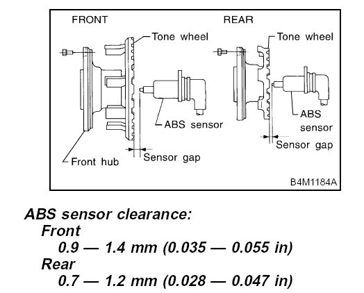

OB99W replied to baboonia's topic in 1990 to Present Legacy, Impreza, Outback, Forester, Baja, WRX&WrxSTI, SVXAt least some of the Subaru gaps seem to average closer to 1mm. Attached is info about the 99 Outback; it uses the 5.3i ABS.
97 Outback ABS 5.3i troubleshooting?
OB99W replied to baboonia's topic in 1990 to Present Legacy, Impreza, Outback, Forester, Baja, WRX&WrxSTI, SVXAs I mentioned above, the tip normally projects about 3mm (beyond the cylindrical portion of the sensor pole piece). You're finding a 4-5mm gap; lets call it 4.5mm. Subtracting 3mm from 4.5mm leaves 1.5mm, which is very slightly larger than what the gap should be. The sensor tip is definitely missing. Code 56 is "Abnormal G Sensor Output". It's possible that the codes other than 22 and 24 (51 previously, 56 now) are byproducts of the malfunction due to the damaged wheel sensors. I can't be sure, but there's a fair chance that replacing the two damaged front wheel sensors will complete the repair.
