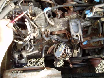

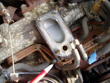

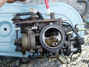

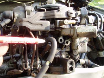

  13. I'm replacing the carb on my Brat with one I just snagged off a hatch from the yard. On the "new" carb there are two fittings that don't exist on the "Old" carb. The first one looks like a vacuum fitting just behind the idle screw above the throttle cable linkages and under the choke. There is a metal fitting on the engine right near there that had a cap on it, I'm assuming that is where I should connect to? Or should I cap the fitting on the new carb? These are shown in the attachments; "Front" and "Front Engine Fitting" I am pointing a pen at the fittings. The Second is also a vaccuum fitting at the top rear of the new carb. Right behind the intake. The fittings I think that goes to are just left of it right above where the radiator hose goes to the block. There are actually two fittings there. A front one and a back one. These are pictured in "Top" and "Side Engine Fittings"
