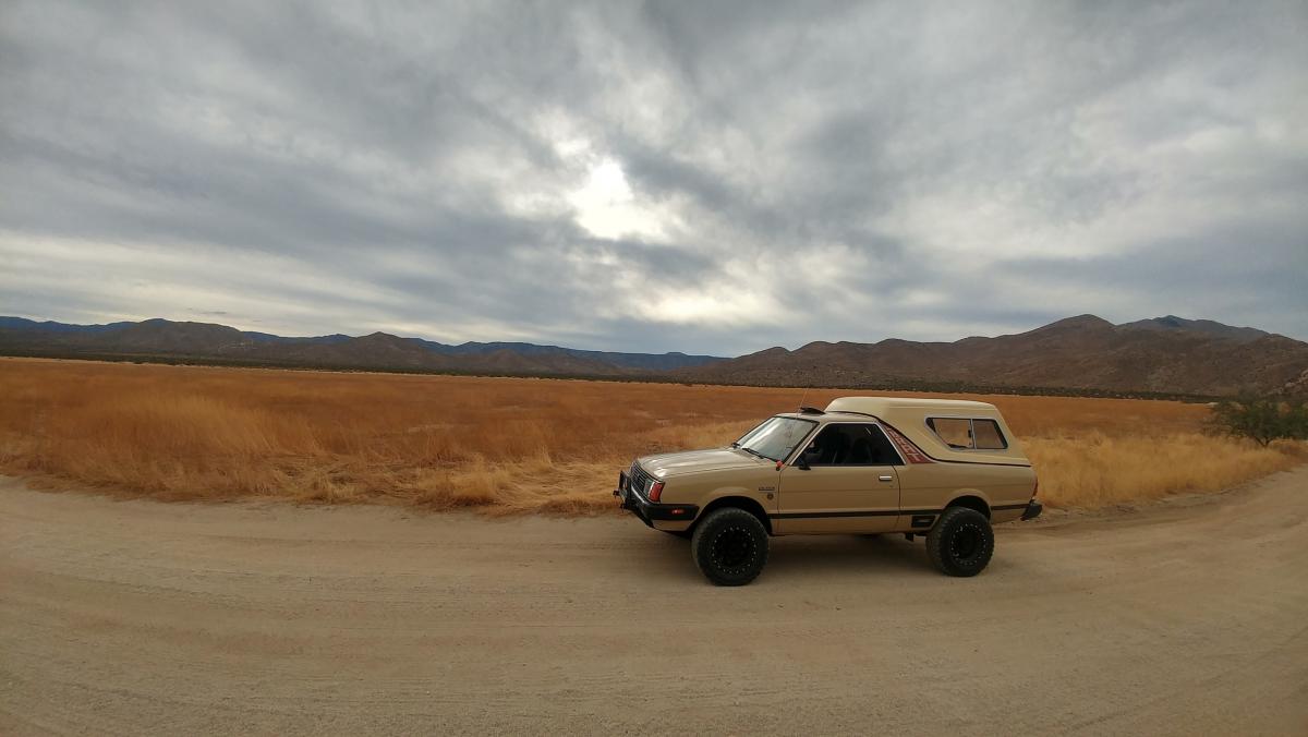

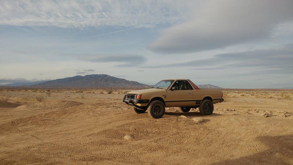

Lifted Subaru Roll Call 2018
82 Brat DL 5 spd DR w/ Jerrys kit EJ22 with ADF adapter and SPEC stage 3 clutch rear disc brakes reupholstered interior GL dash swap HID head lights full LED conversion 4" ADF lift EA82 front springs clocked torsion bars lowered bump stops PS conversion 6 lug conversion 15" Method Standard wheels 215-75-15 BFG AT TA KO2 Restored Snug top STi Spec C roof vent all new bushings new struts/ shocks new brake lines WALBRO 155 GPH fuel pump Custom 1 piece rear drive shaft JVC head unit with 4 kenwood speakers modified 1st gen A bar Nilight 22" light bar and 2 pods In the works: tube lower control arms and Forester knuckles/ struts/axles, Sway-A-Way rear torsion bars
