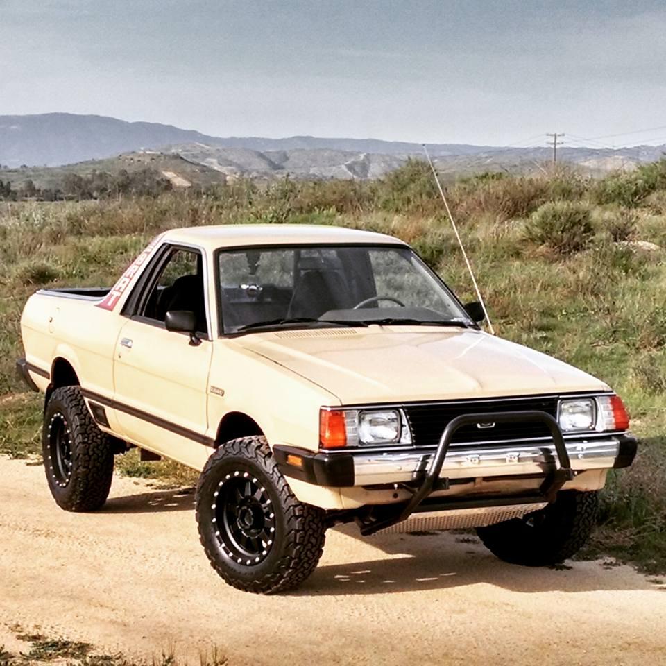

Well time for an update. I ended up just drilling the EA81 hubs and welding in new studs. The wheels I ordered are Method Race wheels in a 15". I also ended up going with 215/75/15 BFG AT KO 2's. Slightly larger than the swampers I was wanting, but the swampers weren't available. The 215's measure in at 28.6". I did have to trim some of the fender and do some hammer work on the inside of the fender well where the body seam was. I still have some slight rubbing inside th fender well, but not enough to be concerned about. The rear was perfect. I ordered the Rancho 5241 Shocks and they are the perfect length. It rides beautifully. I also got my brushgaurd refitted with an aluminum skid plate made. My exhaust was all custom from the header back. It is 2.5" OD and has a stainless steel turbo muffler. Its a little quieter than I would have liked, but I am also enjoying how quiet it is the more I drive it. My MPG's dropped from 28 to 25 overall and my speedo is off about 18%. I can still do 75-80 on the highway and even go up hills without downshifting, but I really feel the old engine is being overworked so I am looking into regearing the trans and diff with 4.11's or 4.44's from Subieworks. Anyways, here are a couple pics, if you follow me on FB or Instagram, you've probably already seen it. Method Racing even posted it on their Instagram site which received over 3,000 likes lol. The RC car in the second pic is a custom Axial SCX-10 rock crawler I built.

Well, I finally decided to lift the Brat. I used a ADF 4" lift which seems to bolt in almost flawlessly. Originally I installed the strut mounts backwards but that has since been sorted. I still have lots to do which includes extending the brake lines, fixing the shifters, getting EA82 hubs for the 6 lug conversion, longer shocks for the rear and extending the bump stops, extending the steering, fixing my brush guard mounts and adding a skid plate, getting 15" rims and 27" super swampers, and fixing the lower radiator hose. I'm also going to get a custom exhaust made that tucks up under neath. I am super happy with the outcome so far!

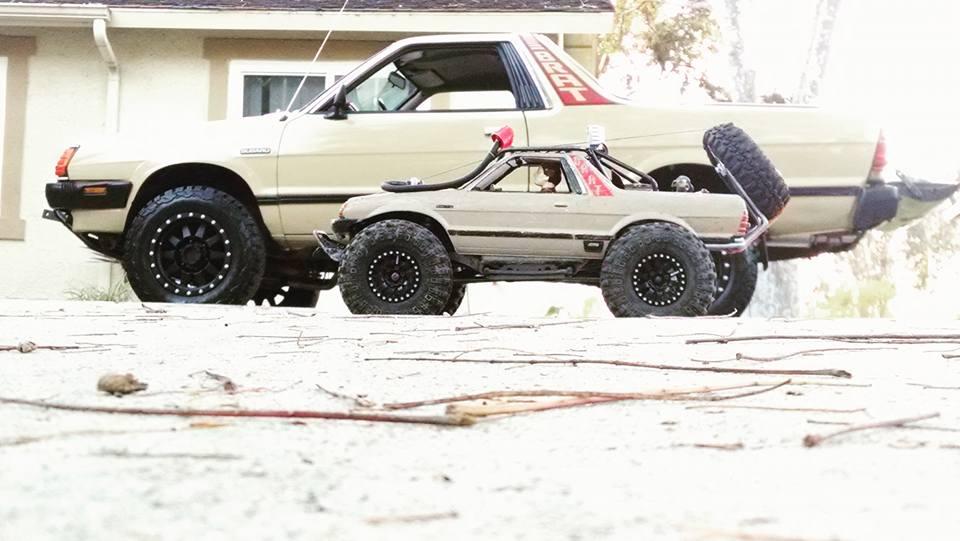

That terminator in the back ground of that pic is awesome!!!
