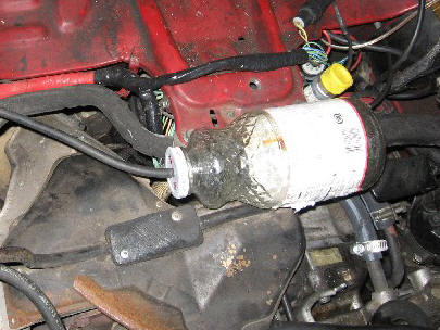

No way. Glass is 100% static. It's impossible for it to constrict or expand. The metal lid works great too to hold the Vac hose. I just punched a small hole in it by twisting the tip of my knife. Made the hole a bit smaller than the diameter of the tubing and shoved it through. The curved in lip produced by the way I hogged out the hole, holds the tube in very well. -

My 89 Gl Trubo has the crappy dealer installed cruise control. The kind that uses engine vaccum instead of an electric pump. Common on DLs but in this case added to a base model GL Turbo. Whatever tank was in there is gone. I've seen round ones in there but that doesn't fit with a turbo, unless maybe that's why it caught fire:rolleyes: . Anyway the little standard(the one in original pic) tank isn't enough to hold vacuum for the cruise and heater controls both. Espescially with a turbo at highway speeds just enough to make near constant boost. Here was my then temporary now still....well....there... solution.Works Great. With the spare over it's held in place well. -
