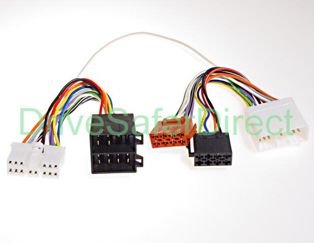

subaruplatt replied to subaruplatt's topic in 1990 to Present Legacy, Impreza, Outback, Forester, Baja, WRX&WrxSTI, SVXI found this PC000044AA . From England! http://cgi.ebay.ca/PC000044AA-eq-ISO-Subaru-Impreza-Justy-Legacy-Outback-/320566958427?pt=UK_Cars_Parts_Vehicles_Terminals_Cabling_ET#ht_3221wt_913 I later realized it was the wrong part but could still be used because the right side or the two male connector to the female Subaru harness connector was all that was needed to connect up to the Parrot harness. I cut and taped the 3 common wires and discarded the left side ( male subaru to two female ISO etc). This is the message I received from england. I see from your photo that you have an RKi8400 - that is a car audio player but you have ordered a SOT lead for a handsfree kit you should have ordered one of our RADIO-SWOP leads instead - please advise your vehicle's model, age and type of stereo/nav you may be able to use half of that lead but it is really the wrong type of lead. Pretty sure this was the part I should have used http://cgi.ebay.co.uk/PC2-44-4-Subaru-Forester-Impreza-Justy-Legacy-ISO-Lead_W0QQitemZ160393548868QQcategoryZ14932QQcmdZViewItemQQ_trksidZp4340.m263QQ_trkparmsZalgo%3DDLSL%252BSIC%26its%3DI%26itu%3DUCI%252BIA%252BUA%252BIEW%252BFICS%252BUFI%26otn%3D8%26pmod%3D320566958427%252B320566958427%26po%3D%26ps%3D63%26clkid%3D5916829066871524340 Honky dory It works!
