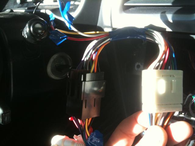

I finally found http://www.dynamicsounds.co.uk/autoleads-pc2444-subaru-legacy-vivio-tribeca-wiring-harness-adaptor-p-9245.html Autoleads PC2-44-4 - Subaru Legacy, Vivio, Tribeca Wiring Harness Adaptor. I think it's the right lead, although I haven't ordered it. I made do withe half of the PC000044AA http://cgi.ebay.ca/PC000044AA-eq-ISO...#ht_3221wt_913 but I was forced to switch the red and yellow around which was convenient on the Parrot harness that included with the stereo. Cut and tape the three common wires they are not used. Red wire must be 12 volts hot at all times and orange wire must be on and off 12 volts with key. This is at the Parrot din connector that enters the unit. Constant power protects the firm ware from being corrupted and if it doesn't shut down gracefully when you turn off key you know you have this problem.

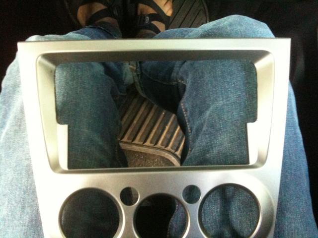

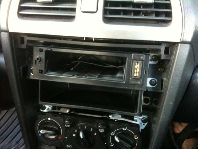

FINALLY! It is done. Firstly the Parrot is really 23 watts continuous with fifty watts peak and is well within the specs of my upgraded speakers. The centre console pieces were easily removed starting from the shifter bezel and working through the ash tray and finally onto the hvac/stereo bezel. The 2 DIN stereo looks a bit harder to do but the 1 din is really easy. I had to lose 2 screws in the process of mounting the factory side plates on the new head unit. I had to move the whole unit forward one set of holes so the front would clear the plastic catch bin below it. The plastic catch bin has two screws and two plastic pins. The pins had to be removed too. ( they did't align and would hold the mounting plates apart at an angle ). Then I realized after I had the whole unit installed that the front of the Parrot was never going allow the factory bezel to fit over top, it was two big for the space in the bezel. I had to involve a professional help 120$, as I don't even own a dremel tool. I had the bezel entrance widened on the top and both sides and am reasonably pleased with the outcome. The thing is amazing! well not true high fi, the mid fi sound is a HUGE improvement over what I had in the base model! I did the dual mic s behind the steering column on the stationary bit, because it was such an easy place to install them. This placement has good audio quality no need to thread the mike all the way to the visor. The Subaru Subwoofer sounds almost invisible I have the gain on it at about 3 o'clock and the whole system set to a custom eq but it also sounds fine flat. One note to watch out for it you remove the drivers seat. The bolts are extremely prone to cross threading and it might be prudent to have some large washers and new bolts on hand. I am now run flat and tweaking the subwoofer to match. I am trying to establish a base level before I go with any EQ. I am fooling around with both the gain and bypass on the sub. MMMM.
