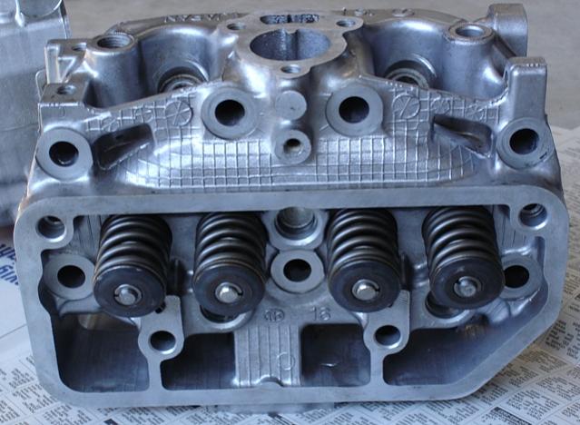

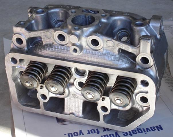

Folks, Put everything back together and all is well. However, had to take the L side head back to the machine shop as the outer spring for cylinder number 2 was installed backwards (you can see it in the picture in the earlier post). Am glad I caught this prior to the install. The most nerve wracking part of this project was getting the push rods positioned correctly. Took my time with this and after the first couple, the installation became natural. Started the truck up yesterday and idled it to operating temperature. Left just DI water in the cooling system. Brought it back in the garage and let it sit overnight. Today, drained oil and filter and redid the torque on the head and intake manifold bolts, and adjusted the valves again - following the regimen laid out in HTKYSA. Will torque the head bolts after 300 miles again and once more after another 1000 miles. The valves are good after today's adjustment. Probably overkill, but I don't intend to do this anytime soon again (I hope). Also installed a new hill holder cable, Denso PW20TT plugs and a new battery. Feel bad as the gas in the tank (1/4 full) was at least 2.5 years old. However, after a few tries, it fired up. Drove around the sub-division for a couple of rounds and then took it on the road. After a gas fill-up, went for a 15 mile spin around town, keeping below 50 mph (no more than 3000 rpms). The engine does feel a bit tight. Now to replace the water with coolant tomorrow, and to source some 185/70-13 tires. Thx, aba

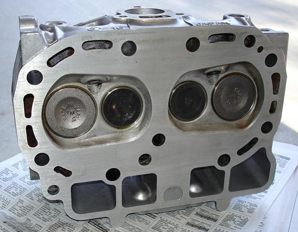

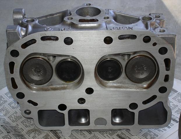

Update: Got the heads back from the machine shop yesterday. Hydro test was good. New valves, new exhaust valve guides (intake guides were fine according to the shop and they did not replace; and 4 intake valve seals. They said the exhaust valves did not use a seal. This stumps me, as the parts manual clearly indicates a total of 8 seals for the engine. However the B&A gasket kit included only 4 seals, so I had ordered 4 extra ones. Is it true that the engine uses only intake seals? Also replaced the valve spring keeper keys. Am attaching a few pictures of the completed heads. Will clean all remaining parts today and start assembling tomorrow.
