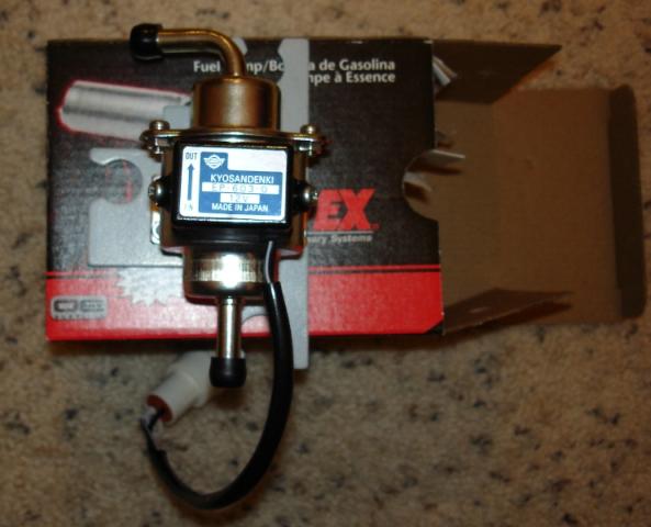

Some leads for replacement fuel pumps, in case you need a new one - I bought this one at ADAP for <$40 (with coupon). It is a Airtex boxed Kyosandenki pump from Japan (see picture). My original pump is not bad and the truck is working well. So I am keeping the new one as a spare. The Kyosandenki has the OEM connector, shelf and all, and is ready to bolt in. My problem was a 1/4 tank of gas that had been in for 2.5 years. I just replaced my HGs (over Christmas) and got the truck back on the road, so started having some trouble due to the old fuel. Had to replace the filters, and some lines. The vapor separator is usually full as visible in the engine compartment (few large bubbles visible at the top, after I shut the car off). I am probably still getting some crap from the tank, as it continues to clean out, based on intermittant idle issues.

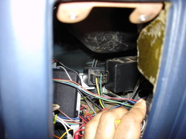

Thanks. I just took care of the fuse contact. The contacts are good and I was able to push the terminal and lock it in place. The fuse appears secure now. But your idea is good and if it gives me any more trouble, this is what I will do. Now that I have everything apart, I want to change out my turn signal/flasher relay. Not that it does not work, but I bought a new one in the hope that the amp draw would be less and it might take care of the volt meter bouncing when the turn signals are on. I have located the flasher and am having trouble taking it off the metal bracket to which it is attached. Any idea, as to how it comes off its bracket? OrI might just leave the original 'Niles" one in and try the replacement. Going out to get some pictures and will post shortly. OK, here is a picture looking through the left dash speaker grill. You can also see my alarm module to the left of the flasher.

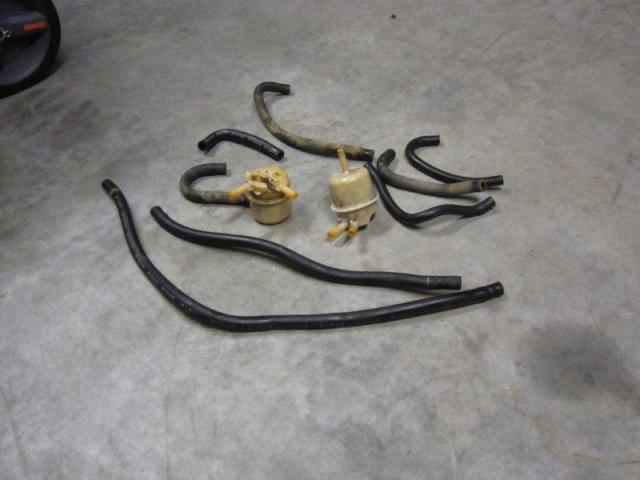

Latest work on the 87 Brat: Yesterday, fixed my passenger side power lock (I had installed these in the 90's, still going strong). The actuator rod was not grabbing the OEM rod as the screws had come loose. Tightened the screws and all is well. Last weekend, replaced a cracked glovebox cover, driver's under dash panel and door speaker grills with pristine ones I had picked up in a VA Wreck yard. Today, replaced the fuel filters with Subaru ones, fuel supply hoses in the engine compartment and under the car, and a few other emission and fuel returns with 5/16" Gates hoses. Had only @1.5' 1/4" hoses, so could not get all the smaller ones done. The Brat was getting very difficult to start, so this is the first thing I did. Seems to have helped based on easier starts this evening. Will monitor this week. The fuel pump and ignition coils are original. Have ordered OEM comparable replacements. Also ordered a set of lug nuts/locks and new wheel studs. The threads on most are getting mangled up. http://www.amazon.com/Wagner-BD60987-Wheel-Lug-Stud/dp/B000CQRN1G/ref=au_pf_ss_1?ie=UTF8&Model=Brat%7C54&n=15684181&s=automotive&Make=Subaru%7C13&Year=1987%7C1987&carId=001 http://www.amazon.com/dp/B000A8JD1O/ref=pe_175190_21431760_cs_sce_dp_1 Other than being difficult to start for a couple of weeks, everything is well. The 2.5 years of sitting with a quarter tank of gas might be haunting me now. However, have run @2.5 tanks through since the HG replacement. Should straighten out soon.
