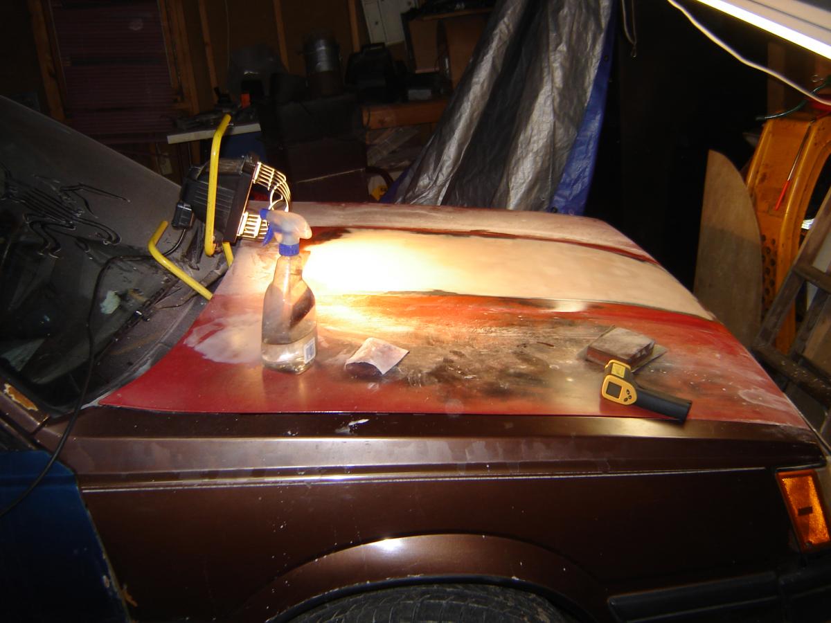

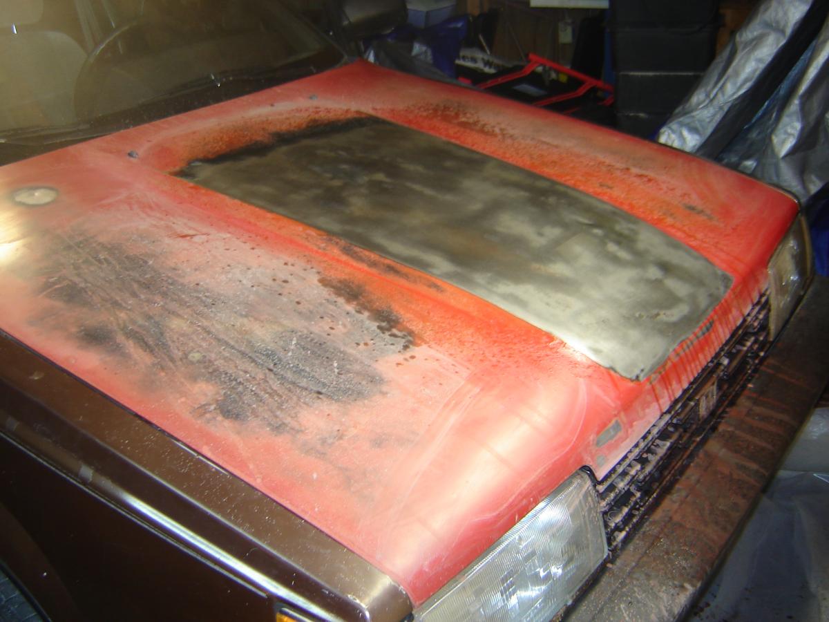

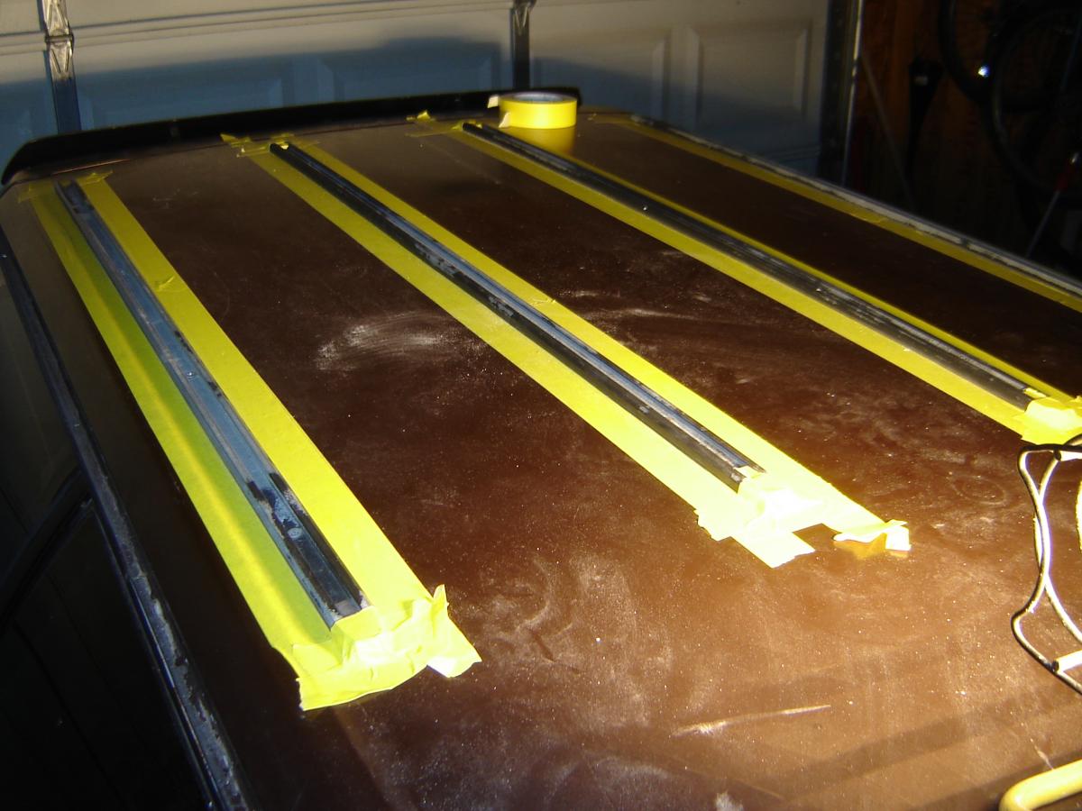

  15. My first real attempt at bodywork, making a smooth hood. Took about 5 days keeping the garage/materials workable w/small salamander, (cough). Painted roof rails, too. Strut rod bushings, + a washer each side, a bit of pounding on the front flaps & fenders got the little bit of clearance I needed. Tweaked the alignment -running good and straight now. Weber swap went awesome -except the JBweld did not want to set up on the cold intake. Using the Transdapt -looks great! Someday warm I'll get the edges all smoothed out. Fortunately had a 'Y" fuel fitting from an old carb. Found the perfect little linkage piece in my scrap pile, too! Went for a test drive and immediately a guy in an older legacy wagon pulled up -said he'd never seen a 4wd before! So I tried to run him and ended up dumping it from 2nd into 5th kept up! -But it's been a Long time since I've gotten a ticket, so I backed off...
