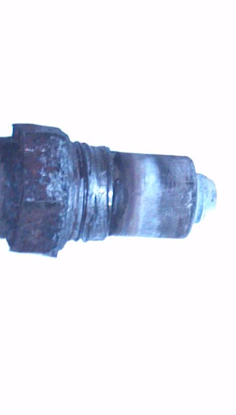

nickb21 replied to nickb21's topic in 1990 to Present Legacy, Impreza, Outback, Forester, Baja, WRX&WrxSTI, SVXThanks for the info! I had decided to just re-use the A/F sensor, but it was a major PITA to get out of the original cat. Apparently 11 years of NJ salt doesn't help. I had been spraying it with PB blaster for about 2-days, hit it with my MAPP torch, and used a 1/2" O2 socket with a 2' breaker bar... Well here are the results, ripped some of the threads totally off. It'll sort of start to thread into the new cat, but I imagine it's just gonna cross-thread the heck out of everything (if it even goes in). Any way to fix this, or am I getting a new sensor now anyway?
