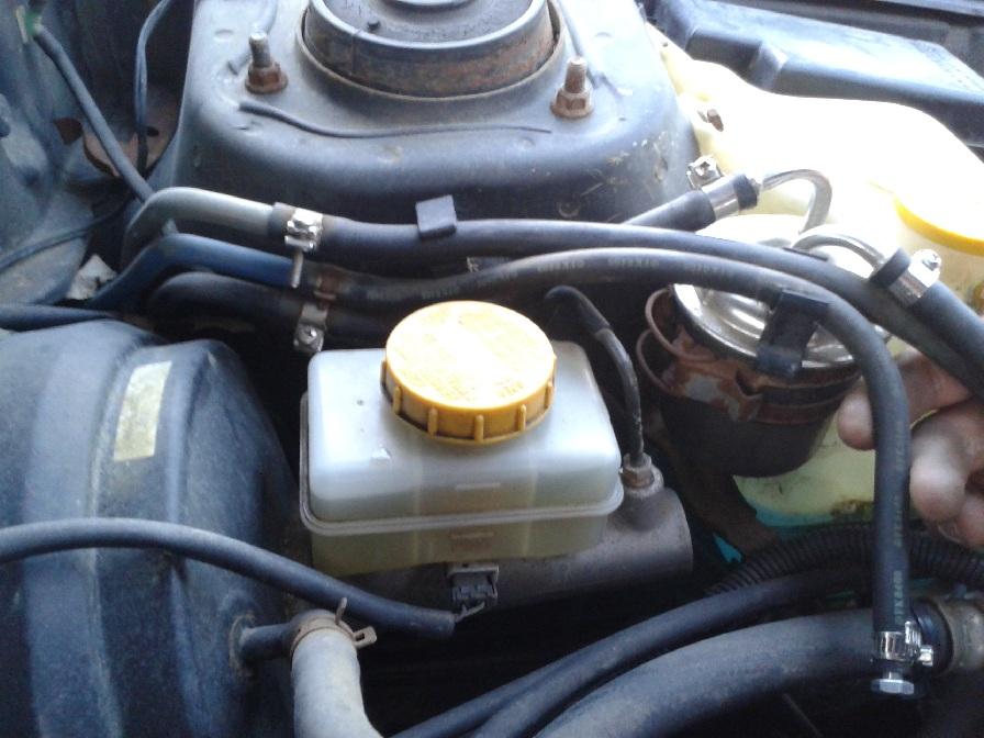

'98 Forester Fuel Line fun...
Tofutti replied to Tofutti's topic in 1990 to Present Legacy, Impreza, Outback, Forester, Baja, WRX&WrxSTI, SVXWhat is the purpose of the damper piece?; What does it actually do (if anything)? I get that I can remove it safely, but what was the idea behind putting it there to begin with? What was it designed/intended to damper? ... just always wanting to expand my knowledge and understanding.. Also, FWIW my VIN starts with JF2...
Snow chain recommendations for 2014 Outback
Tofutti replied to bibsoconner's topic in 1990 to Present Legacy, Impreza, Outback, Forester, Baja, WRX&WrxSTI, SVXHere in Vermont, we get snow and ice. We're in it six months of the year. We all have winter tires for this reason. I can't count how many times EACH SEASON I drive home literally plowing snow with my front bumper. Never used tire chains on any of my Subies. I've also never seen tire chains on any of the Subies in my area. (And trust me, just about every third vehicle you see on the road up here IS a Subie.) It's practically the State Car. Also, there is no place around here that we are REQUIRED to have chains available to enter. I understand that geographically, we are different. I suspect that winter tires simply aren't that common in your area, because they're generally not needed, hence, Public Safety folks need to ENSURE that a motorist is equipped in certain areas. If you show up driving on a set of Cooper Weathermaster S/T2 's (Studded), there's a good chance that after they figure out what the hell those are, they'll say you're okay lol. Yes, it's probably not practical for you to go to a junkyard and get a spare set of rims, order these tires and just keep them mounted on there, and change over in your driveway when you're headed to the hills, but you'd probably be fine. That all said, davidlm1954 is on point about the AWD system in these cars. It is VERY different from traditional 4x4 systems. I notice a difference even in my old Loyale, which is four-wheel-drive, not all-wheel-drive. All that aside, I've seen two types of cable chains: One that is just a cable system that runs over and around the tire, like a traditional tire chain would, and another type that has small coil springs that surround/wrap around the sections of cable that run across the tread area. The latter kind tends to "bite" a little bit more in deeper snow, but doesn't have much more effect than the plain ones do on clean ice. If clearance is suspected to be an issue, go with the former "plain" cable chains. I cannot speak of specific brands, but as long as they are approved for your vehicle/tire size, you should be fine.
Tofutti replied to Tofutti's topic in 1990 to Present Legacy, Impreza, Outback, Forester, Baja, WRX&WrxSTI, SVXVictory is mine! (But not without the help and support of all of you.) So, Thank you! heartless, a picture really is worth a thousand words, especially with a person like myself who sometimes has difficulty understanding what another is trying to say, even more so when the two of us use different terms. This is why I try to articulate and explain so much and thus, end up writing a novel for a simple response. Sorry about that everybody.. Also, to that end, MilesFox, after having a chance to look over the FSM, I was able see what you were suggesting, but I think for now, if all seems well for a little bit, I may not go further in to putting the rest of it all back together, as there are other lines plugged off around that evap box under the rear-end, as well as a couple more in the wheel-well by the filler tube. I see the main vent in to the tube is hooked up, but none of the other lines that run up and down the filler tube are connected... From what I can tell under the car, mine looks, according to the FSM to be the "With ORVR" model. I can only guess that "ORVR" stands for "Overcomplicated and Ridiculous Vapor Recovery". ...it's a bit much for me at the moment. And, FairTax, you were spot on and thank you for explaining the jet pump. Makes perfect sense to me now. Also, a coworker has a '99 SOHC Forester, 5-speed (mine's DOHC auto), both EJ25s and I popped his hood today. I found that amongst being a couple quarts low on oil LOL his is just a straight hose on the main feed, as everybody was saying it should be. This isn't something to do with the differences in auto or manual, or maybe more likely, a difference in single or dual heads? Whatever that thingy on mine is, it looks factory anyway. I dunno, maybe my engine is a transplant/mutant and that thing came in with it... who knows. Anywho, I was going to reconnect the original jet pump line as it seemed to still be holding up, such that I had a hell of a time plugging it off the other day, but I ended up puncturing the hose trying to get my bolt back out. So, I decided I would use the ( O ) line as suggested. I also wanted to verify if my assumptions were correct about it being the same evap line that's plugged off up front. I pulled the front plug, then pulled the ( O ) line, got a bunch of gas, and could not blow through it.... Went down to the floor and pulled the unmarked line that was supposed to be the return line, as it was plugged in to the return port on the sender, blew through it and expelled a bunch of crap out the evap line up front... Okay, mystery solved. Pulled the ( O ) line off at that junction and stuck the unmarked line on that spot. Cut and fit the ( O ) line in place on the jet pump ports, kicked the key over and let her idle for about 20 minutes. No leaks, No smells. ETC cleared and drove home. (MIL had been on for O2 sensor.) Thirty-five miles without incident, odors or MIL thus far. We'll see how the week progresses. For now I think unless I develop symptoms/issues, I'll leave that evap pinched off up front. If she throws any codes, I'll dig in a bit. Thank you folks so much again for your help and patience with me! You guys rock

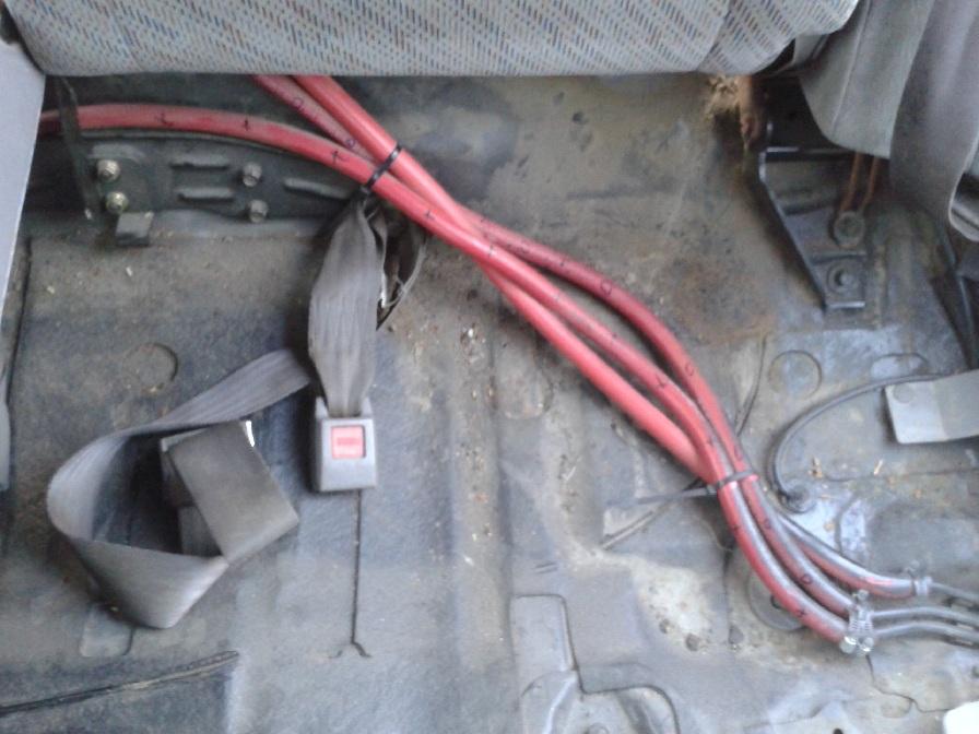

Tofutti replied to Tofutti's topic in 1990 to Present Legacy, Impreza, Outback, Forester, Baja, WRX&WrxSTI, SVXWell according to the FSM that heartless linked me, On this one, it looks like that IS the jet pump line (going back in to the sending unit) The same line he tapped on to with the rubber hose I marked with ( O ). Assuming there are only three lines running back through the car, (and that the send and return lines are correct, (since the car runs great), would this mean that the third line that he has connected to the jet pump inlet on the sending unit would actually end up being this evap line that is plugged off here under the hood? I'm just trying to get my logic straight. (Also trying to understand how this all works.)

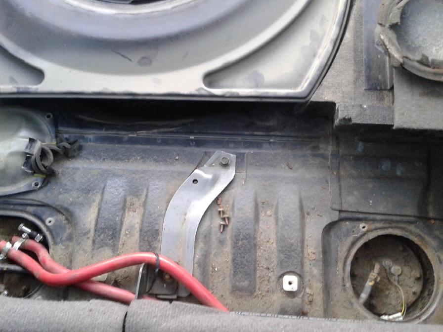

Tofutti replied to Tofutti's topic in 1990 to Present Legacy, Impreza, Outback, Forester, Baja, WRX&WrxSTI, SVXLol you got me dude. It is how it was when I picked it up. "There is another cover on the drivers side, pull that cover up and see if that one hose leads to the top of the sender assembly on that side." Sorry, I meant to include this shot before. Whatever it is in here, is factory. Miles, I'm not sure I'm understanding your advice here. If you could dumb it down a bit for me, I'd really appreciate it. I need to be able to drive this thing home tomorrow afternoon. It's currently sitting at my workplace, and I'll be riding in tomorrow with a coworker. I'll get a chance to play around a wee bit tomorrow afternoon after work, (with very limited parts/supplies) before driving it the 35 miles back to my house. If it can safely make this trip home tomorrow, I'll have WEEKS to figure it out and make it right before I need to drive it again. It shouldn't take weeks at all though; you folks are clearing this picture up rather well so far, and I thank you for all your help.

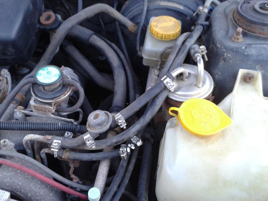

Tofutti replied to Tofutti's topic in 1990 to Present Legacy, Impreza, Outback, Forester, Baja, WRX&WrxSTI, SVXAlso, took a few pics to add some light to the situation... I traced the lines and marked one with a ( + ) and another with ( O ), and left the third blank. Everything look in the right place? Also found the Evap line(?) under the hood had been plugged off (I added those clamps out of shear paranoia.) Make sense? If there are only three lines running through the interior of the car, back to where he tapped in with the red rubber hose, (assuming the main feed and return are properly placed) would that mean that the ( O ) hose would actually be this one that's plugged off up front?!
Tofutti replied to Tofutti's topic in 1990 to Present Legacy, Impreza, Outback, Forester, Baja, WRX&WrxSTI, SVXThank you VERY much for the link, heartless! I can now do some research.. At a cursory glance, it almost looks like I could add a "T" and tie old line back in, assuming of course, the other ends on that whole assembly are still where they need to be in the tank, and not leaking. Not sure on that one yet... Grossgary, I know that just a couple days after I bought the car, I was in there, under that panel tracking down the fuel gauge issue, and it wasn't plugged off at that time. I appreciate the thought, and that would make sense, but if it had blown out prior to that, why would it have taken a month and 1500 miles to begin leaking? Especially considering the rate at which it's spraying out now. I think we're on the right track in thinking something changed somewhere, since it was ok before. Also, the car runs GREAT: Smooth idle and lots of power, decent mileage too. Also, my apologies for the noobish question, but could somebody explain to me what the jet pump actually is, and it's purpose?
Tofutti replied to Tofutti's topic in 1990 to Present Legacy, Impreza, Outback, Forester, Baja, WRX&WrxSTI, SVXThe line that I plugged off tonight (found pouring gas all of the sudden after 1500 uneventful miles, since I've owned it, and probably many more since the "repair" was actually done..) is the one that originally went in to the sending unit where the red (replaced) line right next to it now goes. I was assuming hoses were properly traced and hooked up accordingly on the interior side of the car. I can post more pics of that if needed, to clarify. I'm wondering why all of the sudden it's dumping gas out of this old line (which is/should be also open on the other end, unless it T-s off somewhere else nobody knew about..) ... (and not any of the other ones that were also bypassed). I don't like taking chances with fuel lines either. This is also why I say I don't know these delivery systems intimately. I've seen that inside the car, down by the Drivers side rocker panel, there are three lines going to the front of the car. I have seen that these three lines have all been cut and fixed on to those red hoses, where the steel lines would have gone down through a grommet to beneath the car.. Those red hoses ( three of them separately) run within the interior of the car back to that cover panel, and attach as seen in the pic above. I'm not sure if this clears anything up. I can post more pics as I get them tomorrow. I wonder why everything was fine after months and many miles, then just now this old, disconnected line is dumping it out.
Hi all, First time on this side; I usually lurk around the EA threads... Here's the long and short: (mostly long..)(sorry) I picked up a '98 Forester S from a friend/coworker for cheap. He'd had the car for about a year and had lots of little things fixed and amongst other things, related to gas leaks, included fuel lines. He was frustrated that as soon as one thing was fixed, a month later something else would let go. The person that does this work for him is another Subaru guy, and works on everybodys Subie in the county, basically. In replacing the rusted fuel lines in the back of the car, he simply notched out the cover, and drilled a hole and got on to the the top of the sending unit with some big, heavy reinforced rubber hose. All three lines to the sending unit were fixed/attached to. These were run internally down to the drivers' side (underneath the seat, etc) and reattached where the steel lines come back in to the car, effectively bypassing all the rusted junk underneath the car. I also noticed there were a whole bunch of rubber lines all around that "emmisions box" under the right rear corner that were plugged off with bolts in the ends of them. The car has not thrown any codes, except for the gas gauge not working. (He nipped a wire while drilling back there. I found and fixed.) So, this was done quite some time ago. Previous owner later had fuel leak issues while filling the car. Claims it was only an issue while filling, not while running/driving. New OEM fuel filler neck was installed (old one found rusty, go figure.). Previous owner still had issues and assumed it was the rubber hose AFTER the metal neck that was leaking. He also wasn't able to see how much fuel he had, due to the gauge no longer functioning. Instead of tracking his milage and adding gallons accordingly, he would "drive it a little bit and put gas in it." Not knowing what exactly the issue was, (tank leaking or not) I showed up with 3 gallons of gas in a can and poured them in, and proceeded to watch at least a gallon drip out. I planned to drive until it ran completely out, then put 5 gallons in, track mileage untill totally out, and do the math from there. I drove over 350 miles before it initially ran out. = Tank already full upon pick up. I had assumed maybe previous owner was just overfilling it and sending some back in to some of the lines that had been plugged off or something. After all that reading, we finally get to the meat of it. I apologize for the long winded-ness, but I feel it helps to know a bit of the back-story. The previous owner throughout all of this would also complain of smelling gas inside the car after refueling. I also had noticed this. Additionally, I had found (While finding the cut wire and thus restoring the fuel gauge) that the cover/hatch over the tank/sending unit was not really sealed up, after having notches cut out of it, thus any leakage back there could easily be smelled in the car. I fixed this as well, and have not had any gas aromas inside the car that were not of my own origin I have now put over 1500 miles on the car without any leaks or incidents. I drove it to work yesterday, and about 15 minutes prior to leaving work, another coworker started it for me to let it warm up. While walking to the car, I noticed it was raining gas underneath the rear end of the car. I shut it off and it stopped. I restarted and it resumed dumping my paycheck on the ground. I rode home with coworker and rocked out the loyal Loyale today. Started the Forester this afternoon and no leaks.... Until after about ten minutes of idling. It was pouring it again. Pulled the cover back off and was able to find that one of the lines that had been bypassed (so we thought) and left open was the culprit. (if you're kneeling on the backseat facing the rear of the car, the lines come out of the sending unit in a triangle pattern, pointing towards the front. This one would be the top right. ( only assume that's where this hose would have connected, lengths seem to match.)) I threaded a bolt in to it and found that after enough time it was building up pressure sufficient to still leak past the threads. Also added a hose clamp and found it to still want to weap until I really torqued the clamp down. I let it idle for a little bit while checking things over and didn't find any other issues. I'm not intimately familiar with automotive fuel systems and am only minorly worried about some big Hollywood-style explosion after a pressure build-up and release somewhere bad while going down the road... So, looking for some insight and thoughts on this as to how I should really proceed from here. If this no longer leaks, am I just ok as it is? Should I be looking for some valve malfunction, or other plugged line/canister? If he bypassed all of this, and correctly rerouted, where is this pressure and fuel coming from? (To which, I might add, the repair technique he performed here, he has done several times without issue over the years.) I am just trying to handle this myself as the guy is very busy as a single father, working a full time job and always has six Subarus in his yard to work on after work.. Also, the car had just under a half tank when I parked it yesterday morning, and while it was doing it's thing, it reduced itself to a quarter of a tank. In the pic, the line on the top right with the bolt and the clamp is the one I just plugged. All other original hoses in here were left open. The red line (obviously) was the other guys' work.
