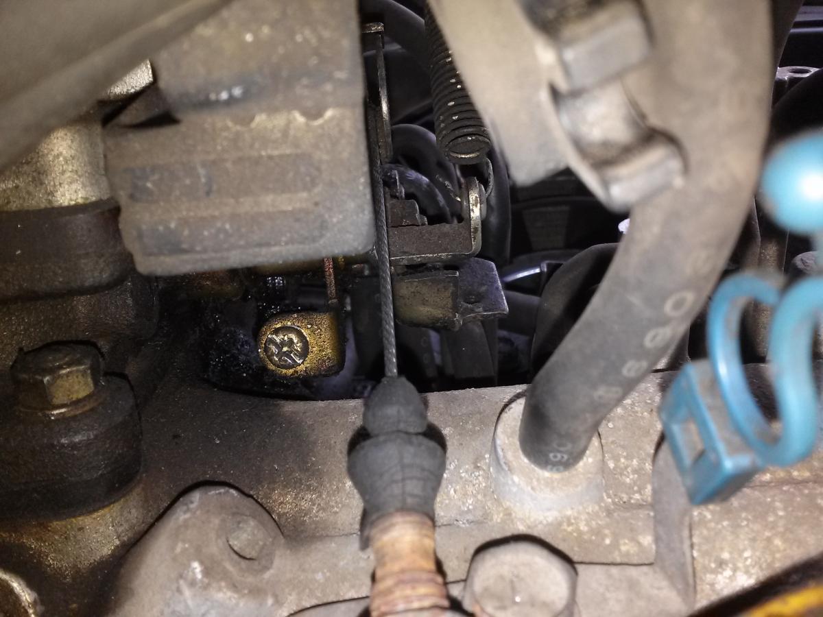

  20. High idle out Idle screw in When warm choke open It just seems like it's getting stuck on the high idle lobe... Revs raise past the point in the lobe releases drops to nothing... Tap gas lands back on the lobe fires back up This was the fix for mine 6 months after I got it, drove me insane Doesn't seem like fueling issue if your able to be speed racer, if it wasn't getting enough you'd flatten the bowl n she'd buck like mad till it caught back up
  21. This guy right here, bring it out a bit, supposed to balance the two until the high draw noise goes away, running 8 BTDC timing wise right?
  22. Are you adjusting the idle screw or the high idle choke screw? Idle screw is in the front, pain in the butt spot High idle screw is in the back, real easy
