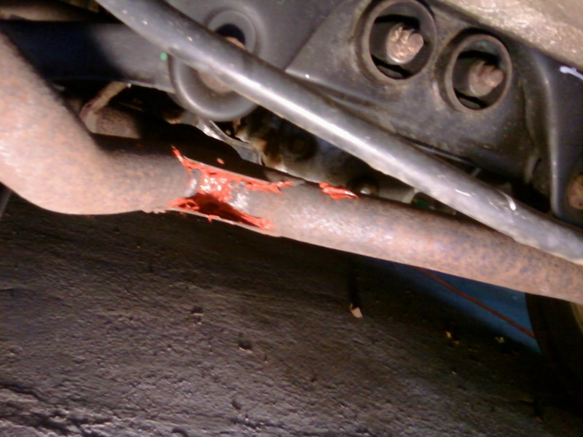

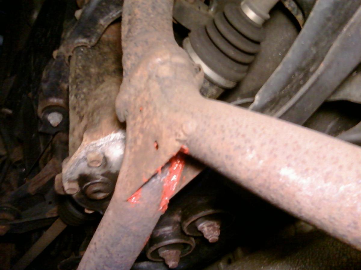

  23. Well, since it was impossible to access and super clean the area for JB or anything for that matter (hindsight I guess I could have sandblasted the area) I am counting on the tenacity of the silicone to bond to the adjacent rusty exhaust pipe and seal the crack. I extended the silicone beyond the thin crack and am hoping that the flexibility of the silicone might work to my advantage. If the bandage fails, I will arrange for a buddy with a lift to cut open the bottom brace enough to get rid of the silicone and weld the crack. Likely, this methodology will not make it to the Subaru Repair Manual section of the site. I was just glad that there was a high temp silicone to try out.
