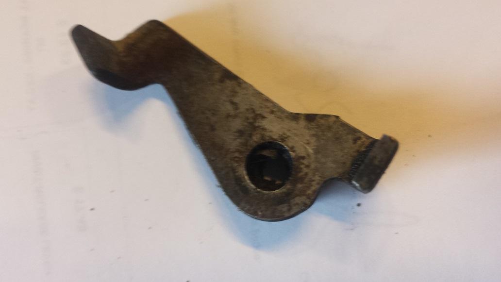

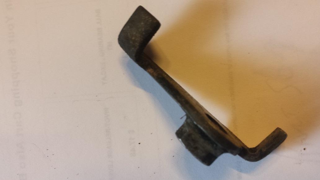

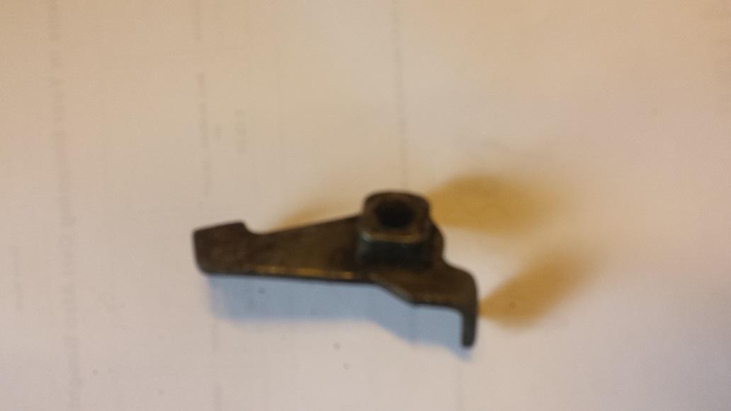

All: Doing some last minute cleaning while I am waiting for final parts shipment. I am replacing clutch / seals on my 1995 Legacy Wagon / EJ22. I bought this car second hand so not sure of its history. In cleaning under the intake manifold today I found the following bracket. It was oil caked...so it has been there awhile. Any idea location / function? Thanks, Tom

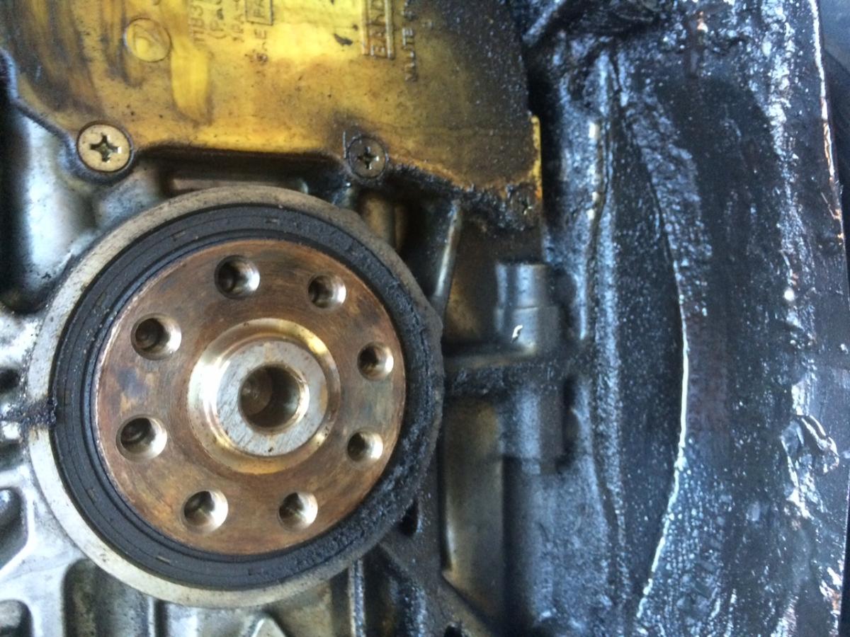

1995 Subaru Legacy L wagon ej22 Got the flywheel off. Looks like I have the plastic oil separator plate. Week be swapping for metal. Thoughts on the rear main seal. Pic attached. Should I swap it out? Board seems to dissuade people from removing...but it looks like it is leaking around bottom. Thanks Tom

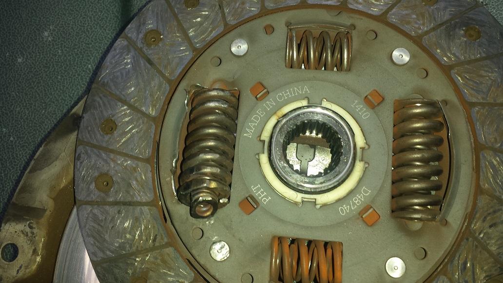

1995 Subaru Legacy L Wagon - MT / EJ22 / 186K So pulled the clutch today and found a suprise...attached. I now know what that noise was. I am thinking that the throwout bearing caused the damage. The throwout bearing looks good. But was missing a clutch sleeve clip / spring release clip / weight release lever as show in the diagram. It was super loose front to back / side to side when I pulled it. Plan to replace bearing / clips / springs / fork (has a stress crack). Just want to make sure I have covered all the bases. Thanks again! Tom
