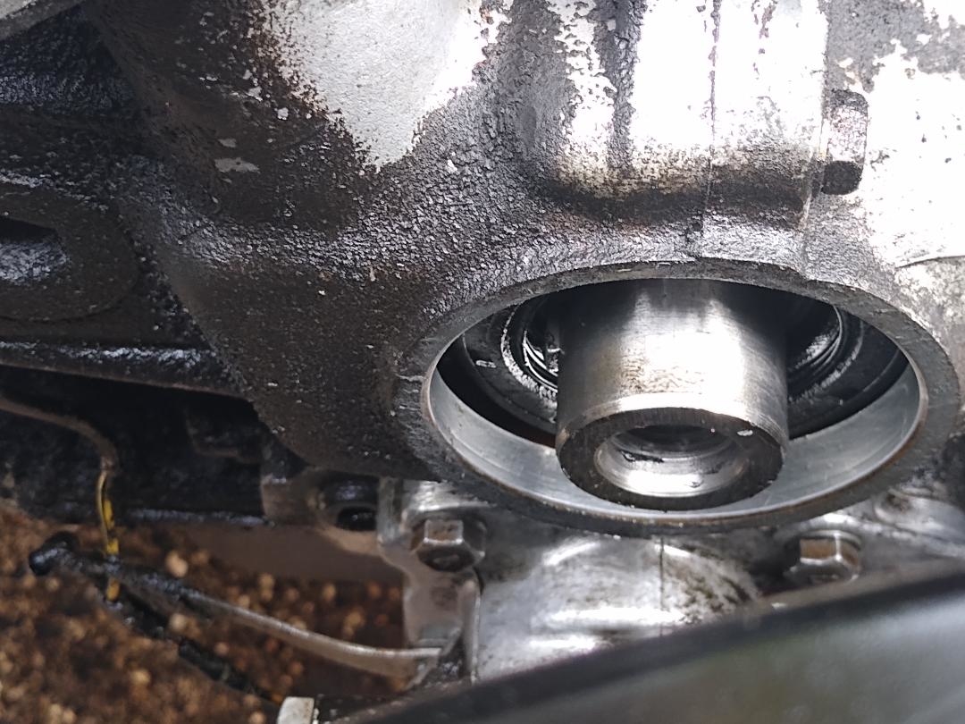

Seal is rigid in there. Anyone know how to extract this without hassle and a chain of catastrophe? I've tried prying it loose, it won't budge. Trying to refrain from removing the radiator and grill but I guess that's a start. Wish me luck. I've never seen this happen before.
In recent days I've been going nuts trying to find a nasty oil leak with pressure in the front of the ea81. I checked the pressure sender, the oil filter, removed and rebuilt the oil pump, again, still had a leak, in the vicinity above the oil pump but ruled out the oil seal that I'd changed about two years ago. Today, I bought a drip pan with plans to pull the front pulley assembly and view it above the pump and view the seal. What I saw was good until I realized that the seal had somehow entered the engine still riding on the crankshaft within! So luck the oil didn't evacuate enough to blow the motor!

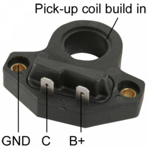

I have had an ongoing problem since the car died. I first replaced the disty, thinking of the high mileage, and was confident that the sensor pickup had gone bad and noticed high heat along that side of the disty. The change did not allow ignition but the next day after checking for voltages and ALL terminals were hot, I reassembled and it fired up! I ran it for about 20 minutes to recharge the battery. Shut down, the next morning...no start. I checked all terminals and found they were still all hot, i.e., lit the test light. Pulled wires from the sensor and B+ at both connectors. I have changed the disty w/sensor, coil (polarity is correct), and what's next? The ECU? If so, where is it locate? Behind fusebox? I somehow do have an extremely light spark from coil but makes no sense as there seems to be a constant B+ on both terminals of the coil (polarity is correct) and no pulse, solid light from test light. A Twilight Zone episode, extended version! -

Coil put out weakly and failed internal resistance but installing brand new coil does nothing. Same results. Very weak pulsing spark and both terminals of the ICM stay hot. Looking for way to diagnose ICM resistance. Probably just going to replace with my new spare ICM and see if that solves it. -
