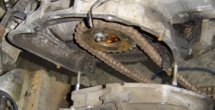

Ok after looking inside the transaxle (see picture) looks like major work to get a low enough gear that leads me to the chain and sprocket reduction at the motor, now heres another question, is the Subaru flywheel evenly balanced all around, so if I took it off the motor added a sprocket on the crankshaft then ran that down to a shaft that contains another sprocket, bearings and the stock flywheel ,would it run balanced? ,this would also leave the motor in the stock location up high and only drop the transaxle, I know some flywheels are not center balanced is this one? -
