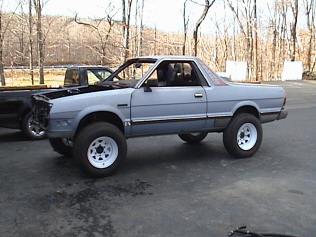

Hey Guys. I have a 84 brat with a 4/3 lift and 6 lug conversion. Im looking for the best possible wheel tire combo to install with out having to cut the fenderwells and that wont give me rub issues when Im wheeling. Im looking at a set of 14 by 6 with 3.5 back spacing then maybe 205/70/15's ??? (they should be 25" tall) Thanks for any help.will be selling the 15/8 that I originally bought once I figure this out.
Im beating myself up over wheels and tires.I purchaced a set of 15 by 8's before my 4/3 lift and 6 lug conversion was even done. I dont know what I was thinking with the 8 inch wide wheels,It kind of limits me to what tires I can use.Plus I dont have the heart to cut the fenders cause its such a perfect rust free body.Im looking at a set of 14 by 6's with 3.5 offset.What do you guys think? and would anyone be interested in my 15 by 8's ? I can let them go with a set of 235/75/15 too (heres a pic with the 15's w/235)

In that picture I had the strut lift blocks on backwards.I have corrected this since.Im sure once the rest of the engine and trans is in it will compress the susp giving me less pos. camber. I reversed the blocks but now there is another problem,the top of the strut coil spring seat is rubbing the inner fender well.I guess I will just hammer out some clearance,kind of sucks cause everything is painted up nice in the well.
