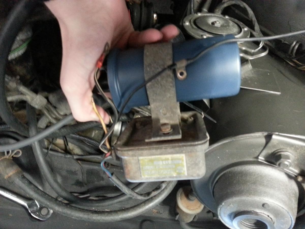

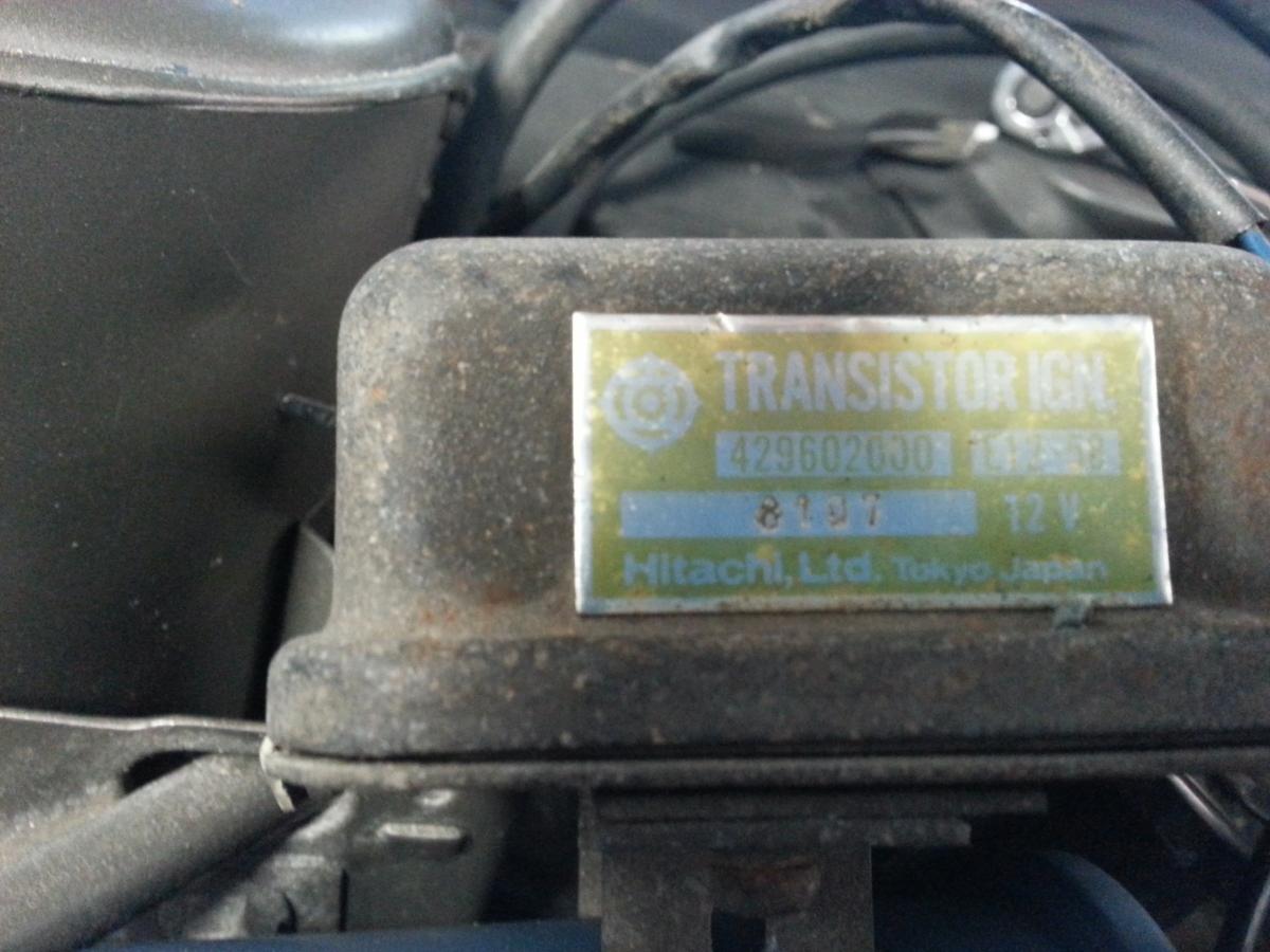

I have tested the wires from the dist to the transistor ignition unit that bolts onto the coil they are good and have no breaks I tested that the dist is outputting a signal when it goes around I have a new coil (do not buy Direct Import brand or whatever it is that O'Reilly's has the coil points stripped out taking the nuts off out of the box) I have the power wire that comes from IGN giving the 12v and everything is wired how the book says but I still have no spark I am thinking that it is the transistor unit but other forums that people have said they think its their unit everybody hops in and says no they don't die there is something else wrong- 10 replies

So I have my test light out everything is wired up the way the book says for my 1980 1.6l EA71 auto choke 4spd M/T + side of coil to bat - with test light gets proper 12v with IGN on - side of coil to bat - with test light also gets 12v with IGN on I know that this should only get 12v when the dist fires not constantly- 10 replies

So I pulled my E-A71 to reseal it. Put the engine back in and it starts right up. I take it for a test drive it will only go half throttle then starts to bog down so I let off and stay below that point and it coughs then shuts off and will not start again. I have replaced the spark plugs/wires and coil but it still has no spark i have tested the distributor and pickup. I have tested all the wires in between and everything seems to be as it should but im at a loss as to why it just stopped and everything else seems to be working properly.
