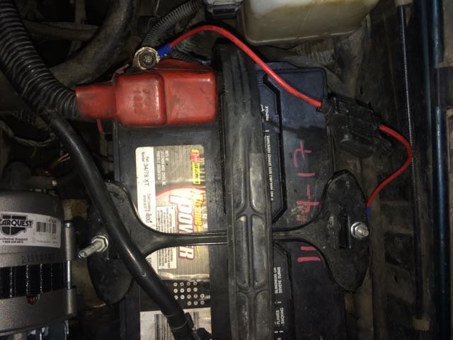

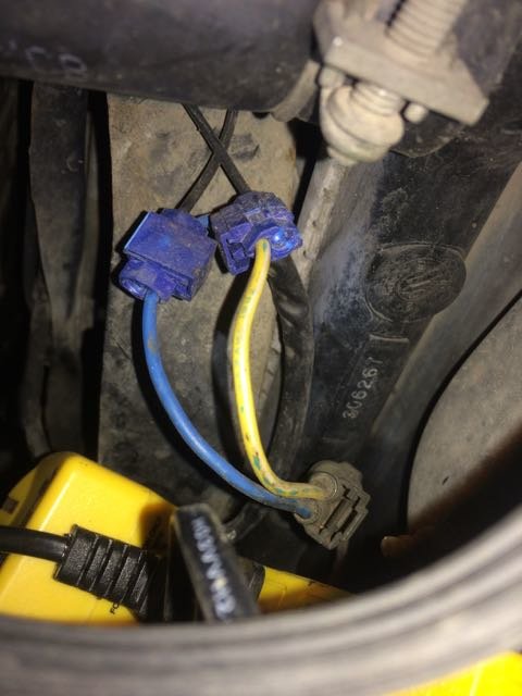

  17. Starting at the battery, here's a fuse holder connected to Postitive with a 7.5 or 10 amp fuse. This fan draws 6.6amps. Then, at the center of the radiator is the relay, with that positive wire connected to the common terminal which is green on this socket. Make sure to get a >10 amp rated relay. Black coming up from fan goes to chassis ground. Blue wire from fan connects to Normally Open terminal. Then the coil wires keep going to the right side of rad and connect to... The existing radiator fan wires. When the factory fan kicks on, it energizes the coil on relay, which switches on power to the add on fan.

  21. I removed the mech fan and installed a 12" generic electric fan from Amazon. Ran all summer with a/c and no issues. Wired it with a relay switched from the factory electric fan on the R side of rad. Super happy and it seems to have a little more pep.
