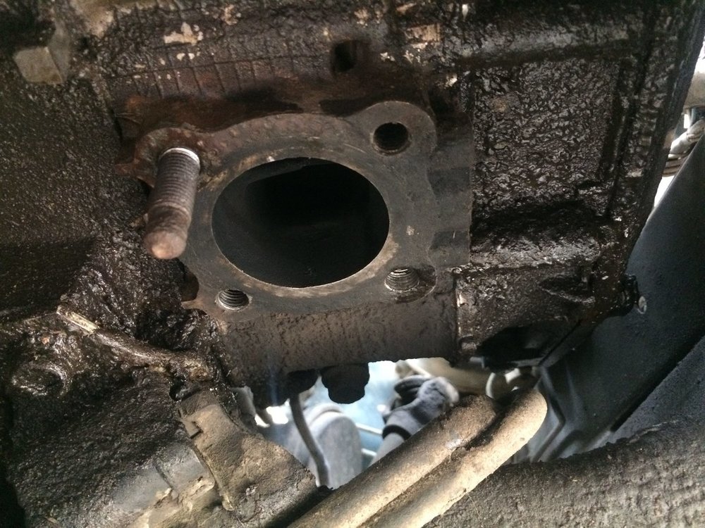

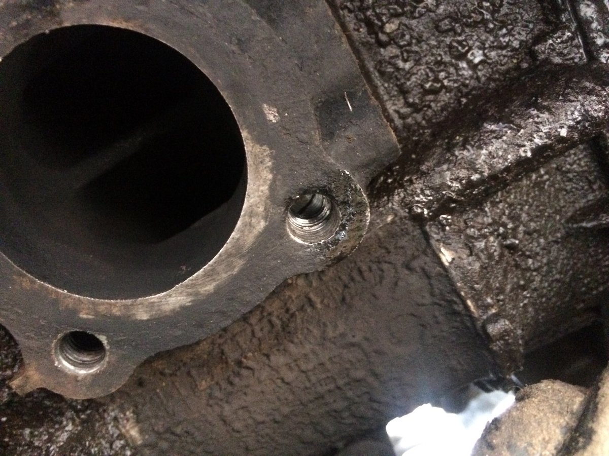

  5. Success! Mounting shaft came out after a couple taps, then snap ring came out, then tapped the bearing out. No markings, but it measures 15mm ID, 35mm OD, 11mm thick. Bet the parts store has one.
  6. Anyone have EA82 tensioner pulley from a parts car? My bearing seized up yesterday and the parts people are scratching their heads. https://www.dropbox.com/s/71oknlxoezvv1sl/img_3573.jpg?dl=0
  7. No, my replacement Cat/Y pipe from rockauto has large holes in the flanges. They're like 15mm. I went larger diameter on the coupling bolts to the muffler too.
  8. I ended up drilling & tapping new 12mm threads. Worked a treat! It's so quiet now! Thanks for the input all.
  9. Pulled the Y pipe out today because of exhaust leak that is noisy and smells in the cabin when not recirculating cabin air. 2 studs stayed in the engine block, not stripped. 1 stud came out with the nut, engine block threads OK, but 1 hole on the L side is stripped. Won't thread back in at all. What's my best option... 1. Drill and re-tap larger diameter? Seems to be plenty of material to support larger hole an re-cut threads. New Y-pipe and cat have large slots (15ish MM) Never done that before though, might be tricky to align drill bit and tap? 2. Helicoil? Never used these either. 3. There are 2 other holes with threads 90 degrees rotated from the original ones. Is there a way to get a 2nd flange around the pipe rotated 90 degrees to use these holes? They have threads same size as the original ones. 4. Other ideas? I want to keep it as OEM as possible. i already have the replacement Y pipe and cat so I don't want to change that.
