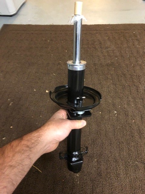

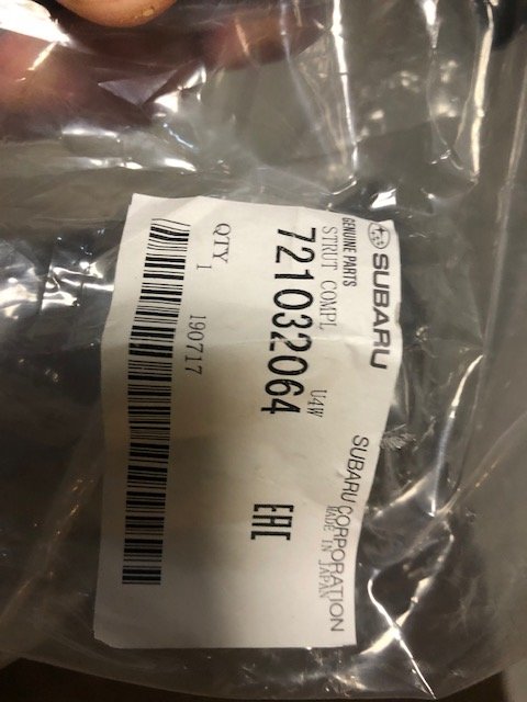

  11. It includes the lower perch. I bought a set recently.
  12. Dude, that's it. Thank you! Had been trying to figure this out for a while.
  13. You can buy OEM 4wd struts right from Subaru. $100/each.

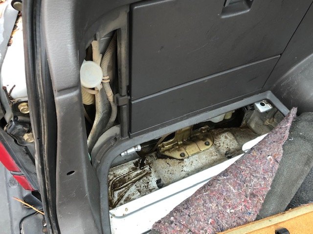

  14. Thanks for the advice. I've had good luck resealing tail lights on the 3 doors but in this case it didnt seem to be tail lights. I will check the window seals and trim.
  15. I had a problem where my starter would just click sometimes and not start. Ended up installing a 12v relay to the starter signal wire then pulling power off the batter and sending that to the starter via the relay. Fixed my issue.
  16. Hi All, Looking for a bit of advice. I noticed some water pooling in the rear fender well where the jack is stored on my 93 Loyale wagon. Initially I thought the tail light was leaking but I dont see evidence of water coming in from there. I see the window washer tank in that location too but I dont believe that is the culprit. Any thoughts on this? Thanks!

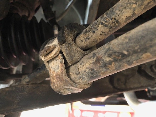

  17. Rubber replacement. 22mm energy suspension 16.5121G. Fit well but didn’t have the rounded base but seems ok anyway.
  18. Only listing at rock auto is for the rear bushings on the front swat bar and it’s actually the wrong size anyway. I did manage to find a suitable replacement for those however.
  19. Hi, anyone have a part number for the end link bushings for an 85 Brat sway bar? Can’t seem to find a listing. Thanks

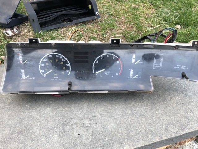

  21. Here is the cluster I am selling.
  22. Yes, it does. I just listed the cluster on the 4x140 facebook groups. Dash wiring harness is likely good too, how hard is that to remove?
  23. Finally got around to this job on the weekend. Overall it was pretty easy thanks to the tips from you guys. Removal of the donor dash took about 2 hours. Then about an hour when I did it again on the Brat to remove it's dash since I had done it once before. Installation took about 3 hours, but I went slow and also spent alot of time cleaning and making a few things right. Overall the project was a big success. I didnt have a hard time with the 3 bolts under the windshield, I used a ratcheting box end that is hinged on the ratcheting end and it make quick work of those bolts.
