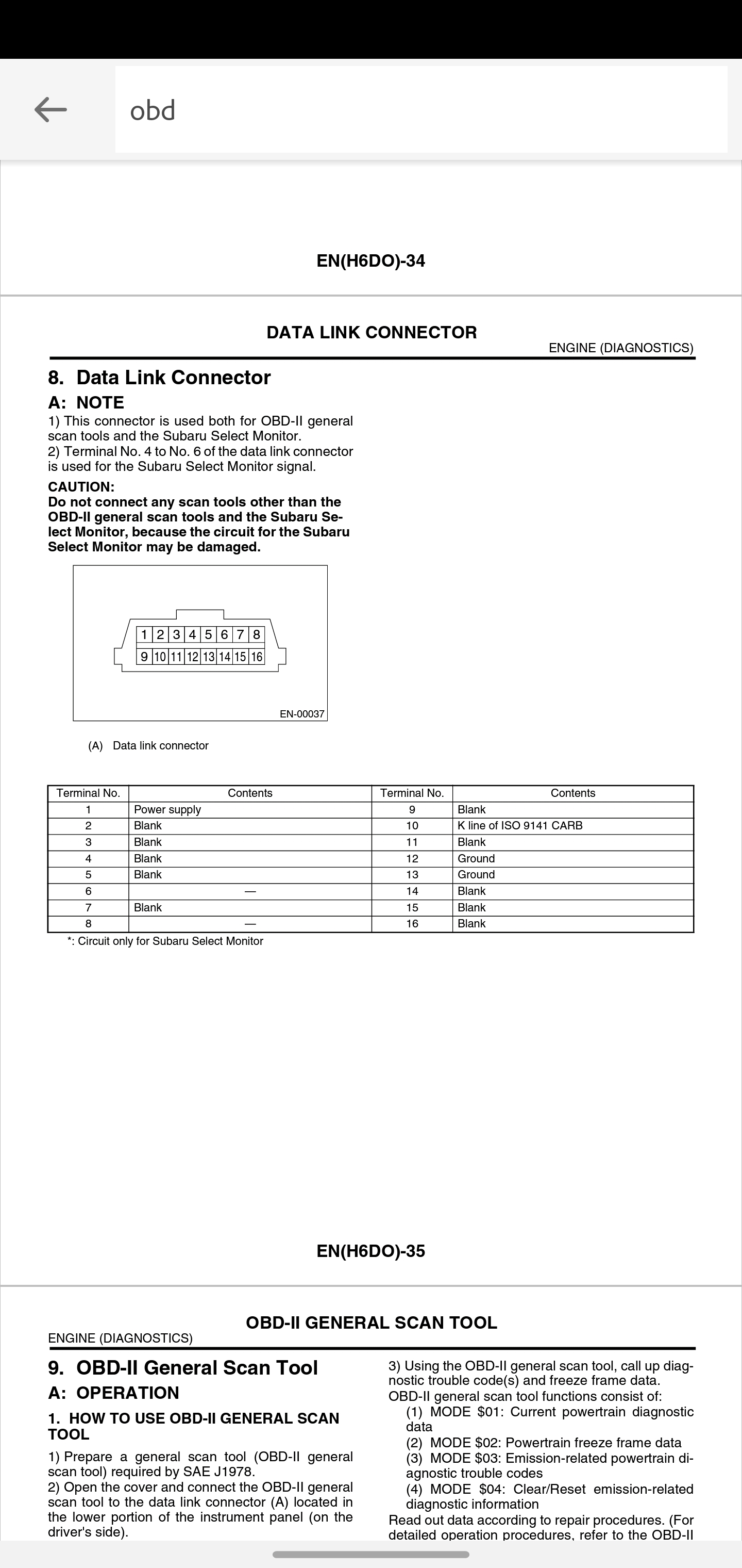

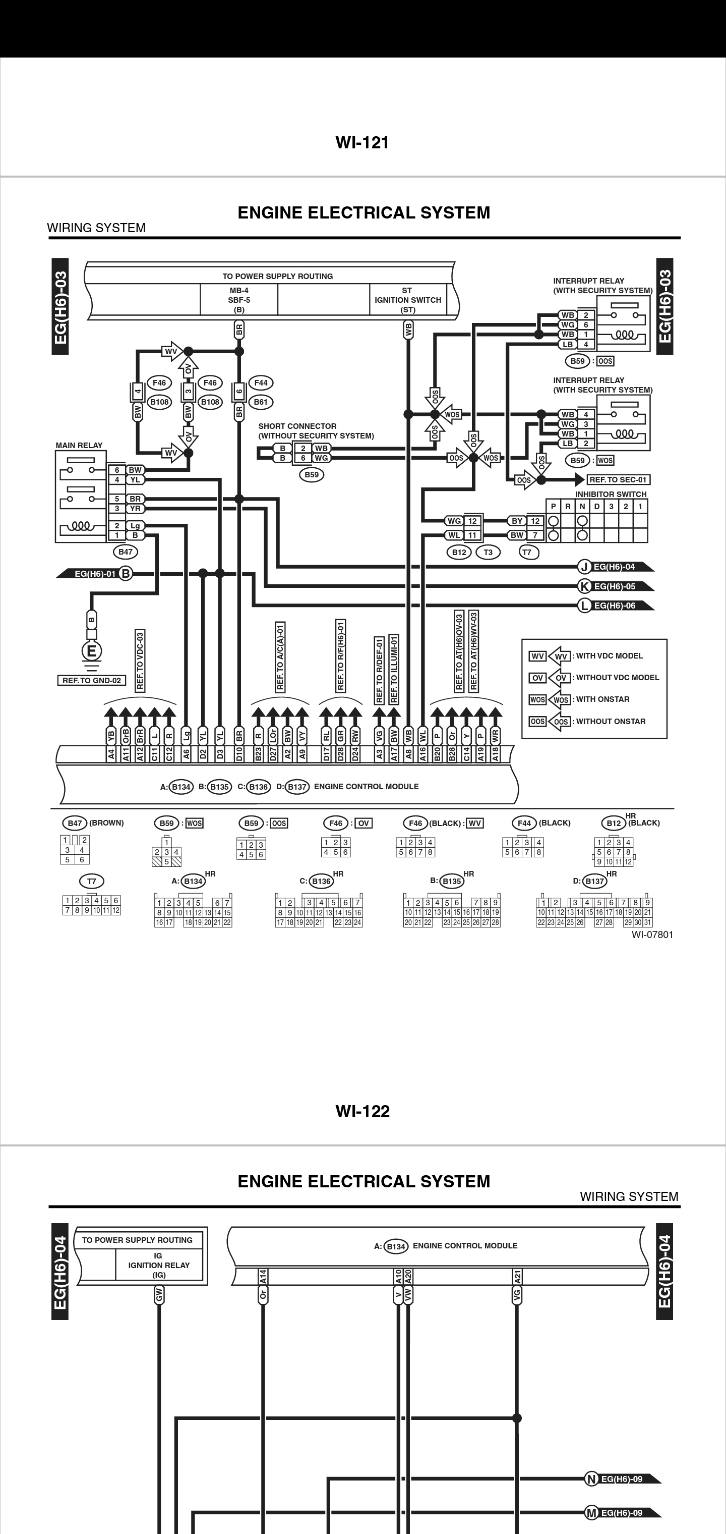

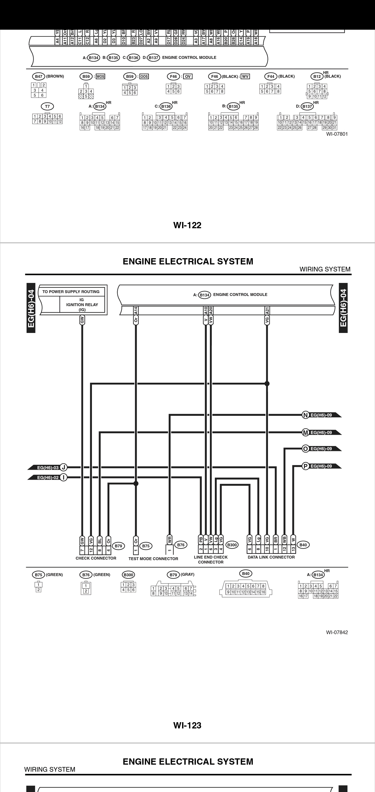

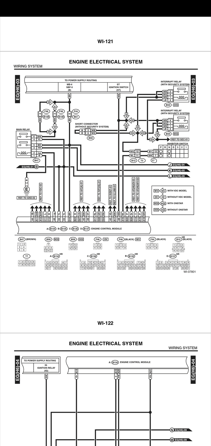

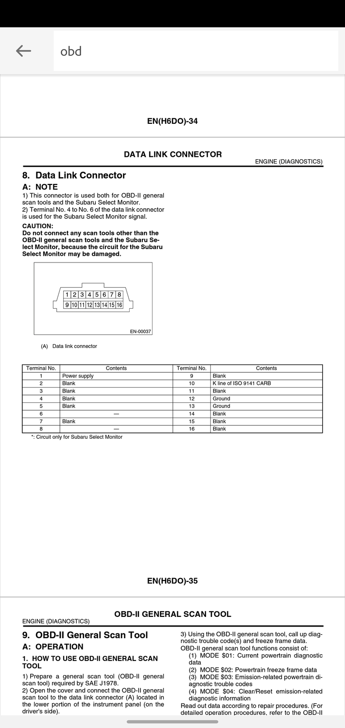

laegion replied to laegion's topic in 1990 to Present Legacy, Impreza, Outback, Forester, Baja, WRX&WrxSTI, SVXThat wasn't my post, I just replied to it. My old OBDII scanner uses 4xAA for power Yes, all 3 interface with my '95 Legacy with no issues. My Bluetooth unit is just the generic elm327. I've checked the fuse. If you look at the diagrams it shows the power to the OBDII port is shared as a back-up power for the ECU and feeds two circuits on the main relay. One circuit powers the O2 Sensors, the other powers a bunch of valves and sensors.- port powered OBDII readers not working on 2003 Outback H6
laegion replied to laegion's topic in 1990 to Present Legacy, Impreza, Outback, Forester, Baja, WRX&WrxSTI, SVXHere are the relevant pages from the service manual, hopefully someone more knowledgeable than myself can spot something I haven't...- port powered OBDII readers not working on 2003 Outback H6
I've been having an issue where none of my OBDII interfaces that power off of the port itself can connect to the ECU, They get power but cannot connect to the iso9141 protocol even though both should be able to do so. I do have a self-powered, super old OBDII diagnostic reader that does work. While this is helpful I'd like for my Sprint Drive and my Bluetooth adapter to work so I can use my phone rather than this old. My Sprint Drive does register the voltage from the port at 11.4v and I'm wondering if this would be enough to cause a connection error? I'm thinking about hooking up a different 12v source; but I can't see any reason why there would be a problem; none of the other stuff hooked up on the same fuse or ground is having an issue that I can tell...so I'm thinking bad port or a wire short? The fuses are all fine. Has anyone run into anything like this before?- 1995 Legacy ECU removal

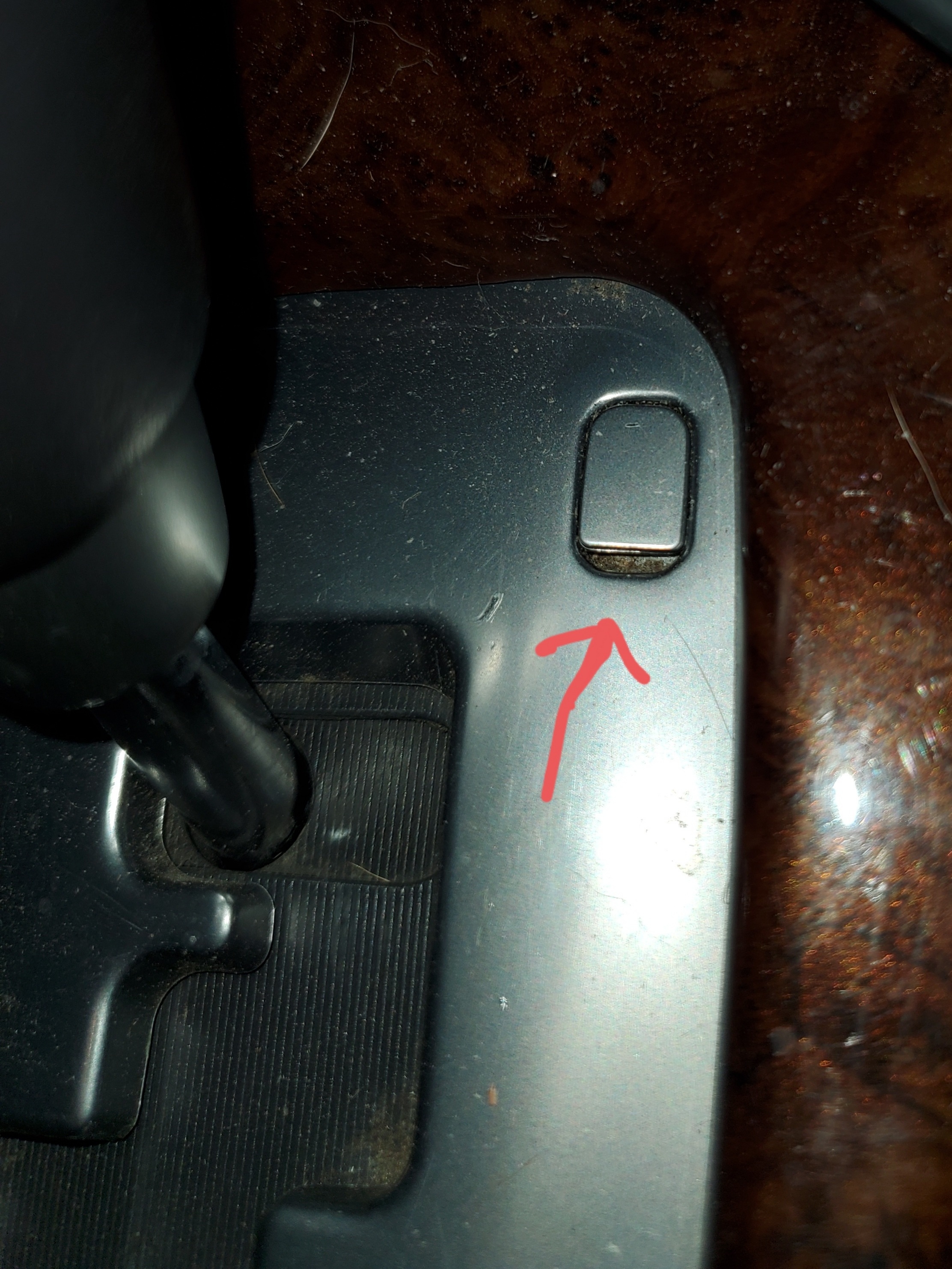

laegion replied to legacy2000's topic in 1990 to Present Legacy, Impreza, Outback, Forester, Baja, WRX&WrxSTI, SVXI don't know for sure on your car since mine is a 2003, still the same generation so maybe the same. On mine there is a small cover in the top right corner of the shift plate. Just gently pop that off with a flat head screw driver and the use the screw driver to gently push down on the plastic beneath the cover and your shifter will move.- 95 Legacy LS sedan....height adjusters any good??
