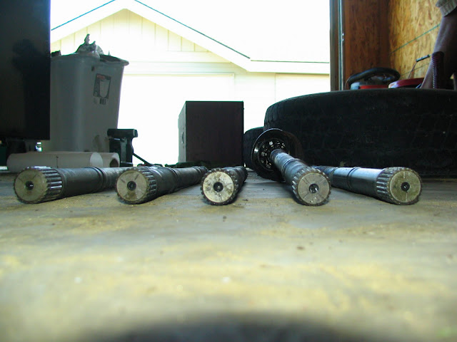

Above is a shot of all the axle shafts (one with the cv joint still attached (sucker didnt want to come off)). They are all the same length, but the two on each far side are larger in diameter than the three in the middle.
A little hard to see but the two on the outside are both the same larger diameter and the three in the middle are all the same smaller diameter (used a micrometer to make sure).

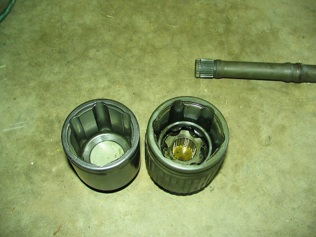

The two on the right are larger CV joints and even slightly longer overall length than the three to the left. Yet the splines and threaded area are the same diameter.
Another shot to show the size difference.
This is the odd axle out on the left. It is the same size as the smaller ones but the CV joint shape is slightly different.
The top three DOJ cups are smaller diameter than the bottom two.
There is also a slight height difference.
Overall theses axles will fit the same way in any EA82 vehicle. But two of them are noticeably beefier (inside and out) than the other three. I would like to think that they are factory and the smaller three are aftermarket. But i have no way of knowing for sure since i don't know where they originally came from.

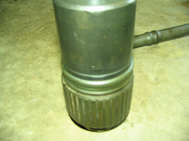

Same goes for the DOJ cups (81 on left, 82 on right)
What this means to me is i made a mistake. The first time i redid a few axles for Bill i must have picked up a FWD EA82 axle. The boots i ordered of course would not fit because these axles are much larger than both EA81 and EA82 4WD axles.
