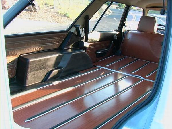

Messing around with an idea for the rear hatch
My carpet is toast, and I really like this. Bamboo laminate flooring. I unfortunately don't have enough to do it all right now, but enough to know that this is going to happen. I'll be ordering another box later
My inspiration
A Peugeot 504
