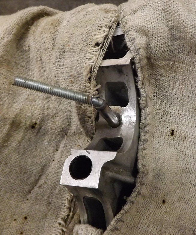

These are the strut tops out of the Impreza.  Driver's side on the top, passenger side on the bottom.
New one on the left.  You can see the one from the driver's side on the right was cracked about 3/4 of the way around.

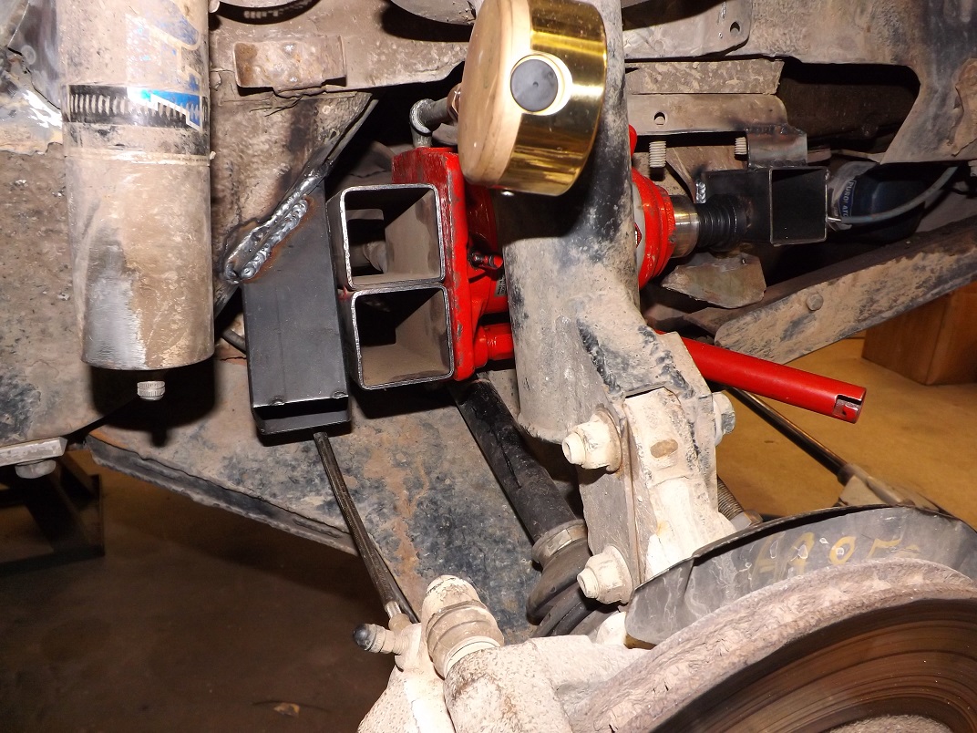

One of the last things I did before the UP trip was to finish the mounting posts for the sand ladders.  We did end up using them once, these posts and quick release levers worked out pretty well.

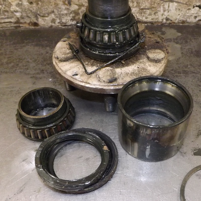

Over the weekend I replaced the rear wheel bearings, seals, and hubs.  The one that had been replaced a few weeks ago was questionable since it wasn't really sealed for a while and it was running hotter than the other three.  The other one hasn't been replaced in years, figured might as well do it now.  Replaced the parking brake hardware while it was apart.  The shoes were still thick so I left those in.

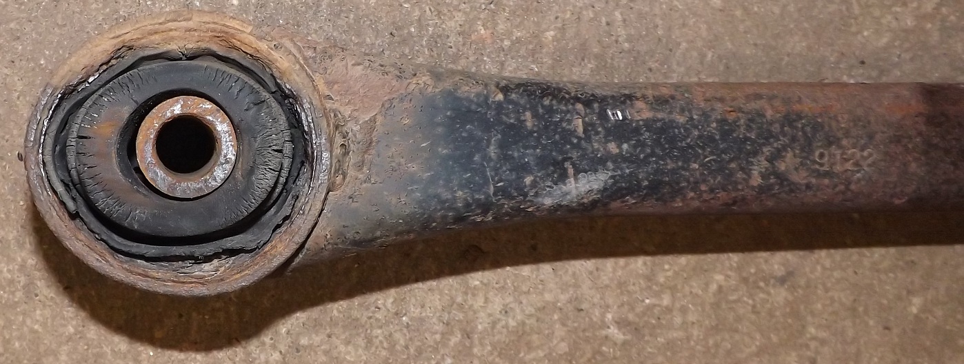

I've noticed that the trailing link bushings are pretty loose, took them off and they look like this:
I had a couple that we haven't beat on, one actually looks new, so I put the fresh trailing arms on both sides.

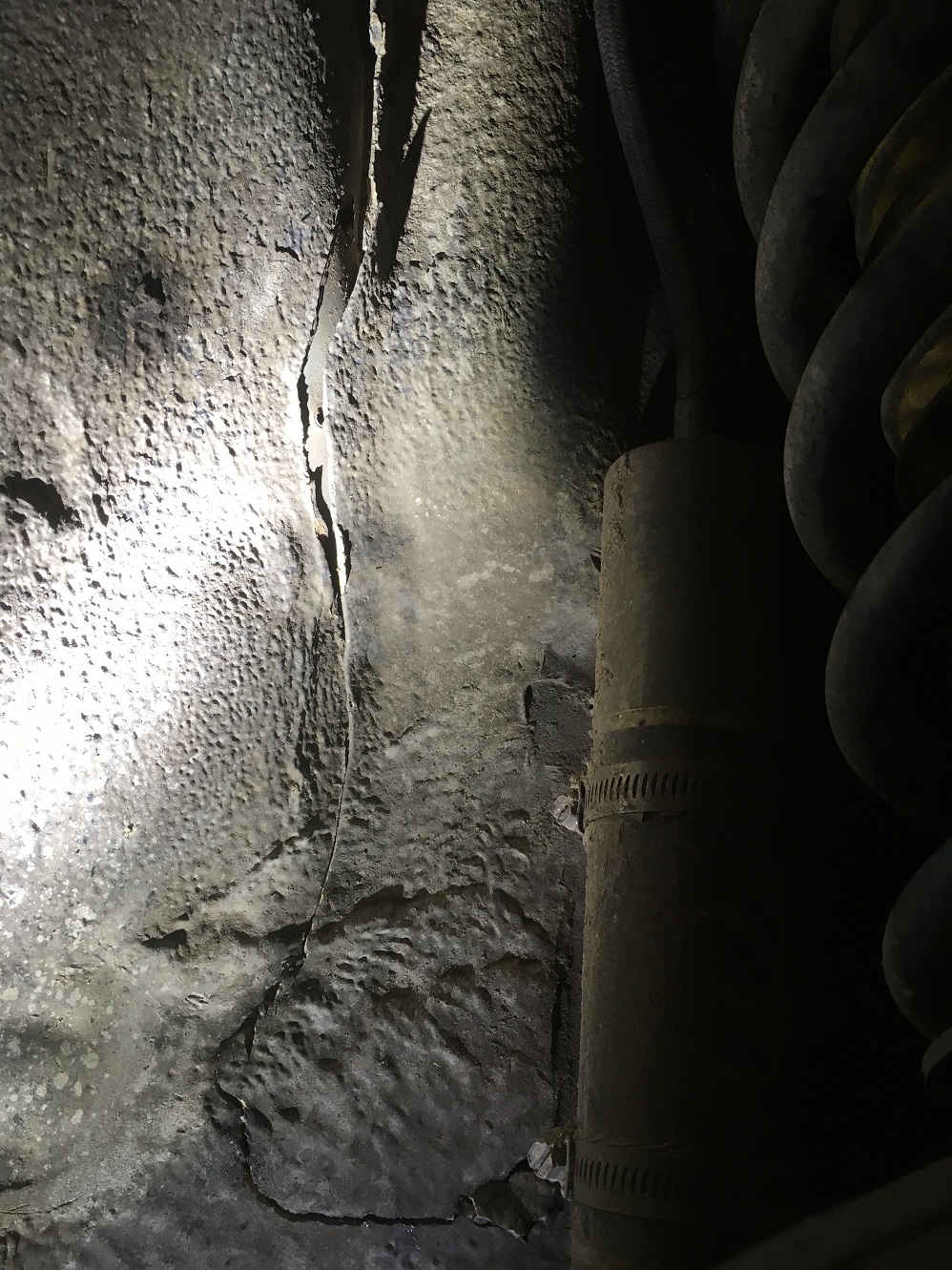

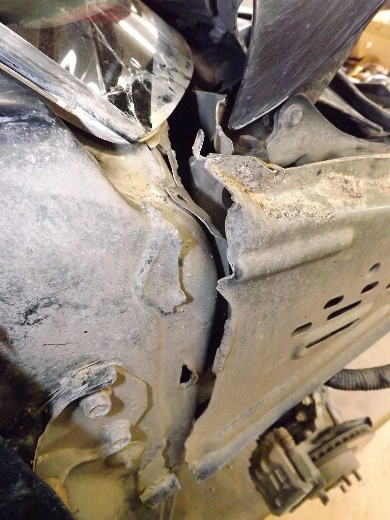

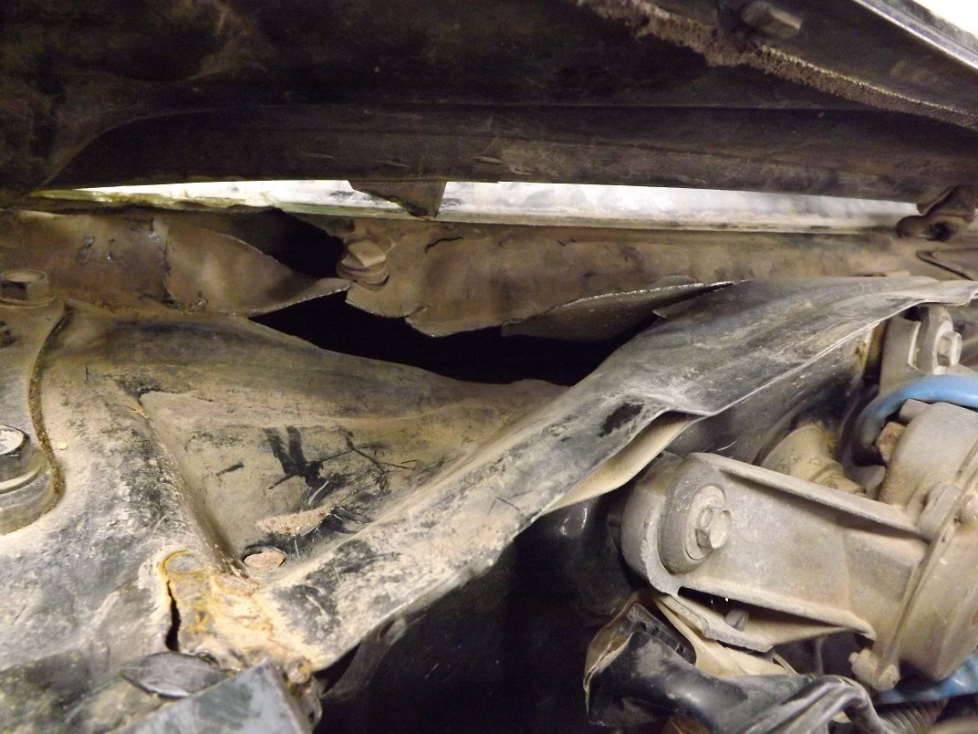

Here is the only picture I've taken that shows how big the crack in the body is.  Goes almost all the way up and down behind the RF strut tower.

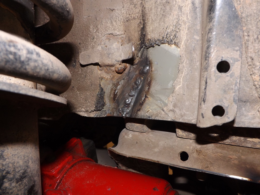

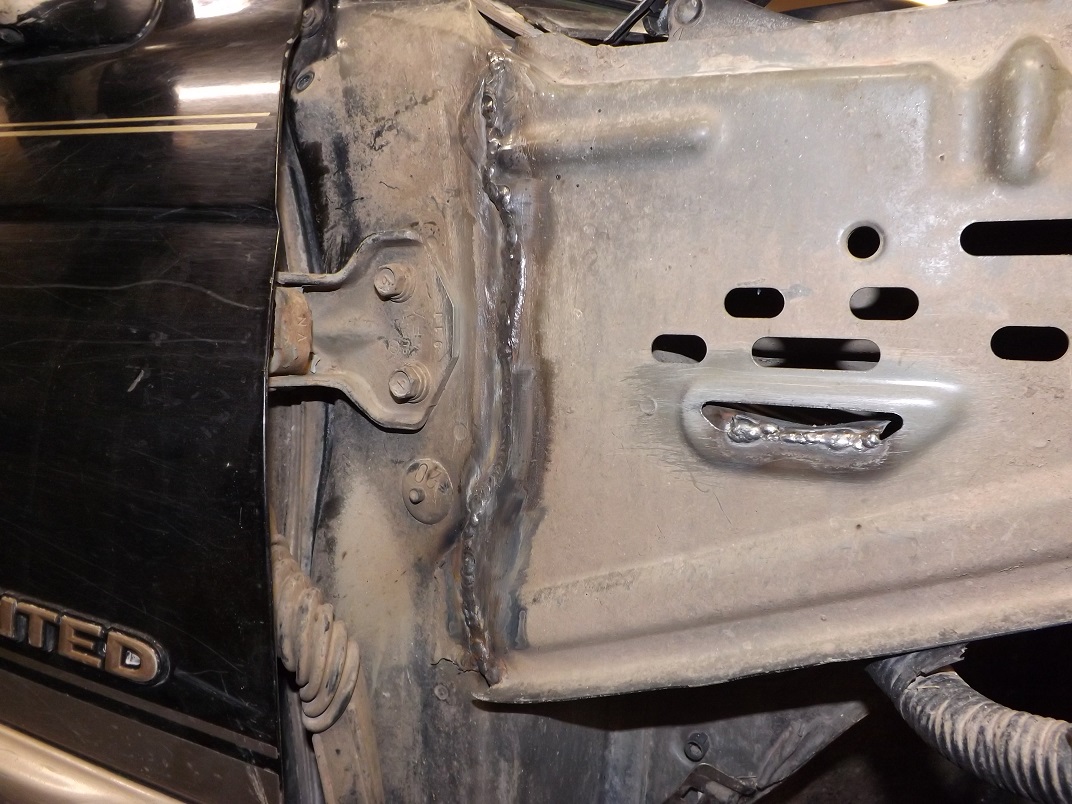

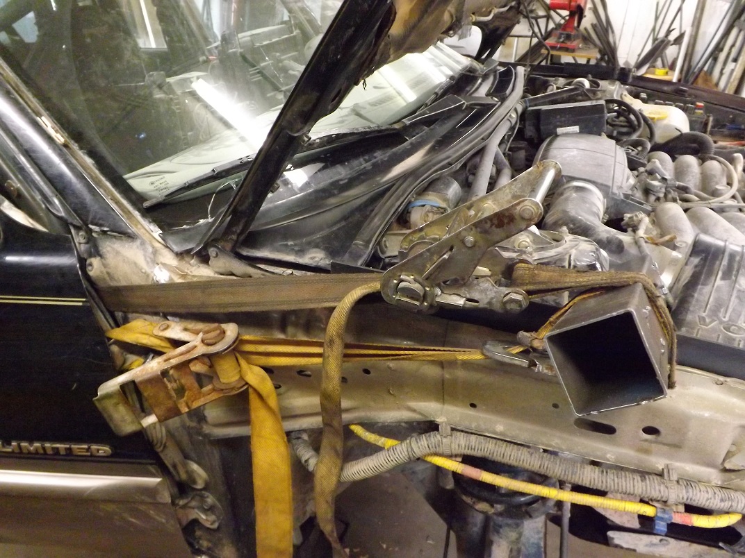

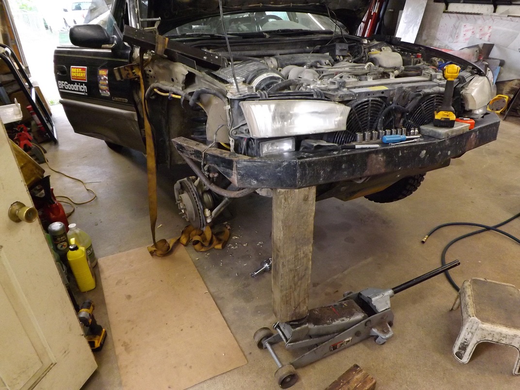

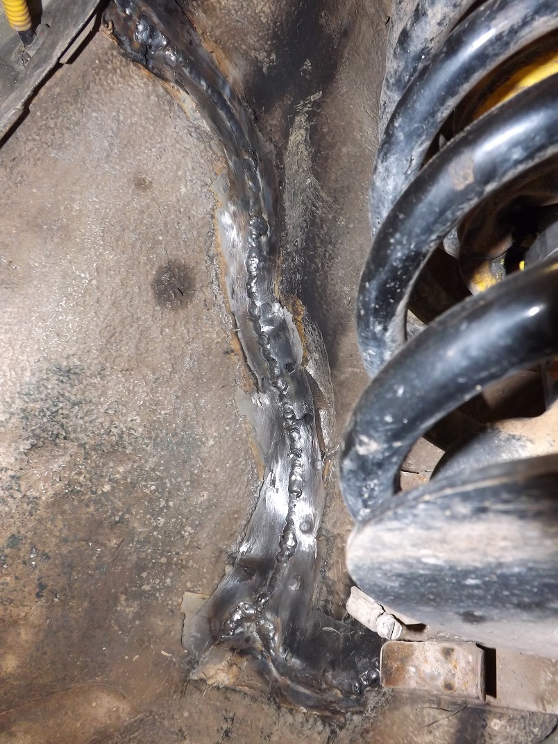

We got a lot done yesterday.  Main focus was putting the body back in place and welding it.  Here are a couple more pictures of the damage:
We bolted a big piece of tube to the front of the strut tower and a piece of angle to the fender rail and welded them together.  Using a couple of big ratchet straps we were able to mostly pull the body back in place.  The last bit of adjustment was jacking up the corner of the bumper to bring that corner back up, then things were lined back up almost perfectly.
We also noticed the "frame rail" section of the body was buckled behind the crossmember and the control arms have been a pain to install for a while since the mounts seem too close together.  So I welded a couple pieces of tube on the body and crossmember and spread them out with a bottle jack.
Then I fully welded the seams that had split.
You can see where the spot welds were on this seam, I think there were only four or six for a two foot long seam.
I did a little more welding than this after taking the pictures and hit the welds with some spray paint.  Hopefully it's better than stock.  It's certainly much better than what we just drove 2000 miles back home on.

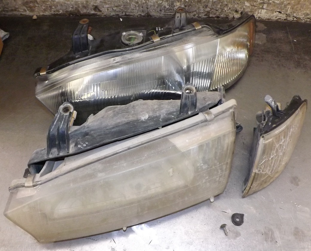

The driver's side front corner light has just been electrical taped on since the V2R.  Went to the local you pull it yard and they only had Outbacks / Legacies with one piece headlight/corner lights so I got a pair.  I think the 95/96 had the one piece lights, in 97 they went to two piece, no idea why.  As you can see the little tab that holds the corner light on breaks off anytime you hit the light very hard.  I did find some over the weekend to replace this one.  Eventually I'll put in the one piece headlights.  The adjusters look better, they have levels, should be more robust, but they take a different headlight bulb.  I can get HID bulbs that should plug in to fit them.

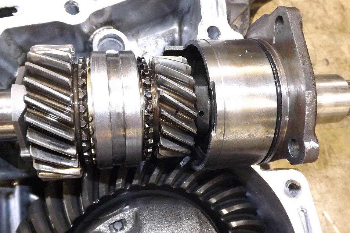

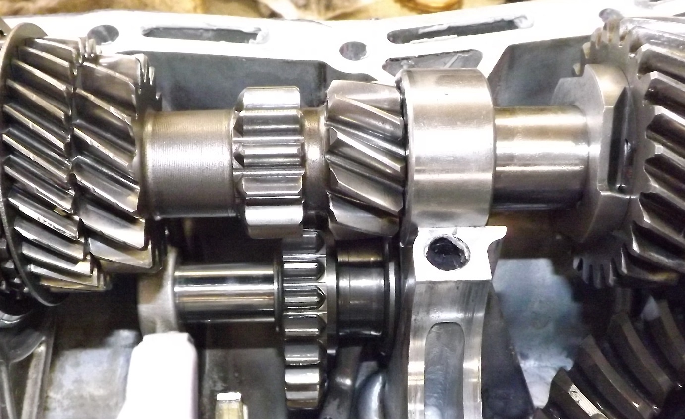

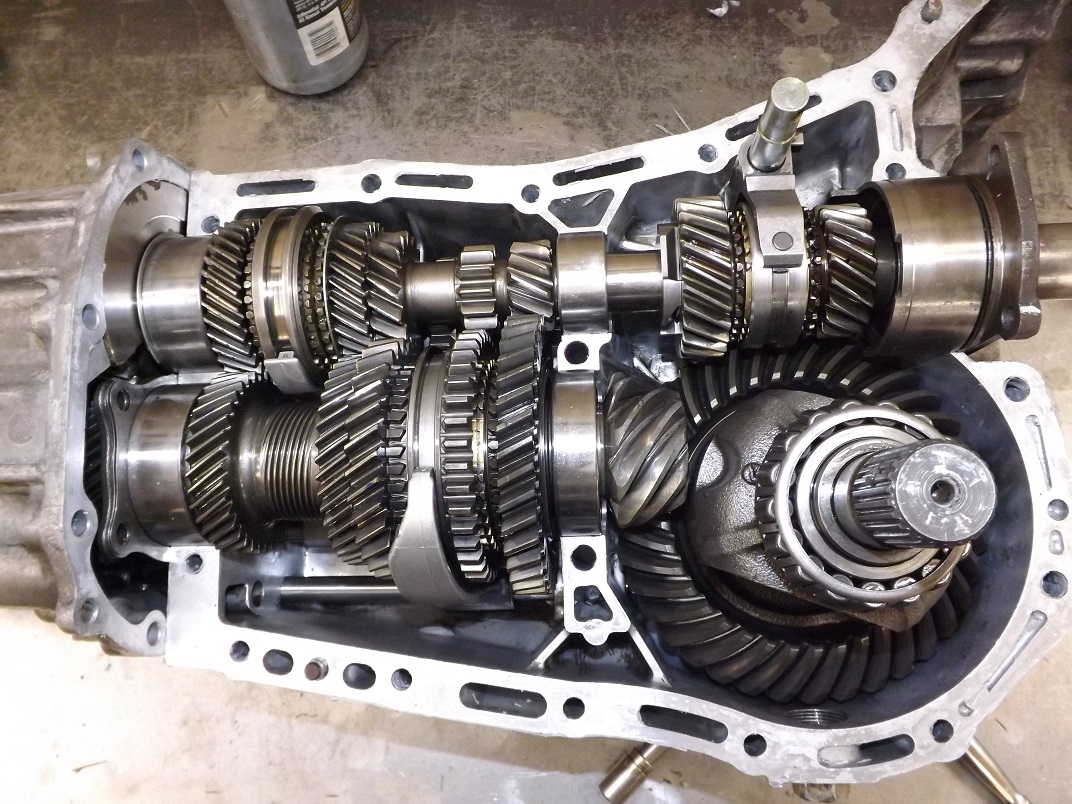

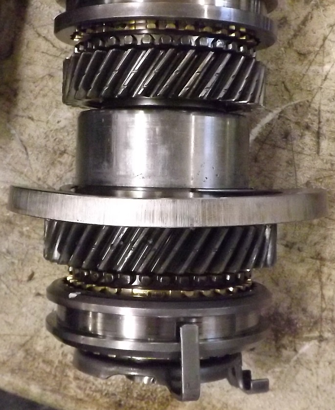

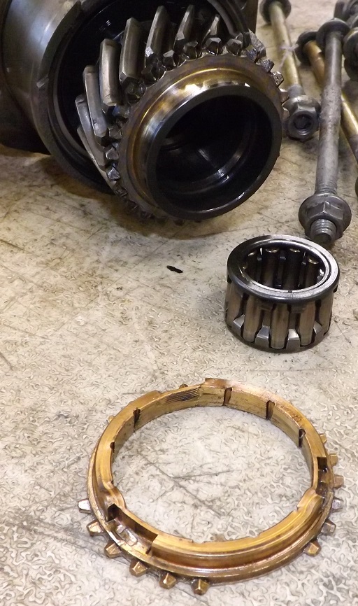

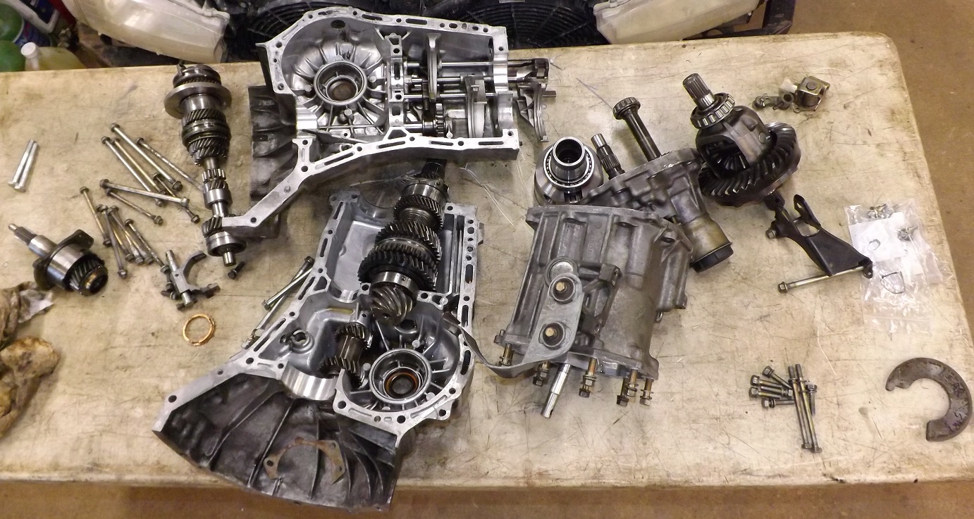

The trans in the 99 Outback started making a clicking noise in first gear a couple weeks ago.  I was hoping it was just a CV axle but only happens in first gear at any amount of throttle, no noise in other gears.  Ran it on my friend's lift and he thought it sounded like a countershaft bearing.  So that's been parked for a while.  On the plus side, hopefully, I got a dual range trans with the right final drive ratio from another USMB user.  He said it needed a baulk (brass synchro) ring so we took it apart.

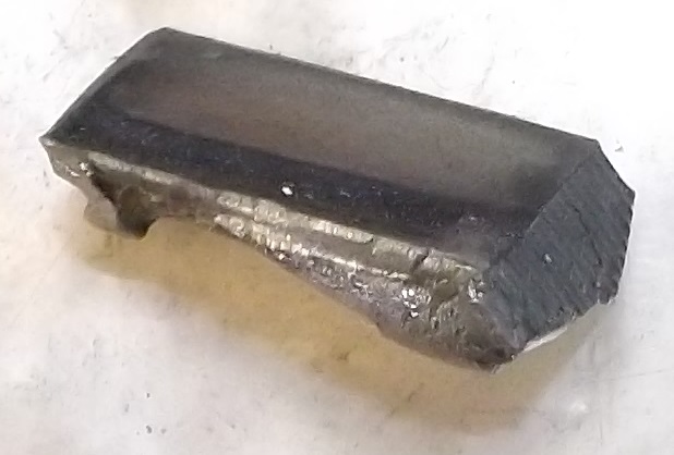

Also looks like that bearing inside the input shaft got toasty.  I'm guessing the input shaft needs to be shimmed out.  I contacted All Drive Subaru in Australia, it sounds like they might have some parts I need.
Plate that goes behind fifth gear on the top shaft looks bent, and the snapring behind it should be replaced.
Other than that the trans looks mint, synchro teeth look new.  Of course just about any parts look mint compared to the stuff that's been on our cars any length of time.  Anxious to see what the car will do with a low range.
If anyone knows where I can get any of these parts, please let me know.

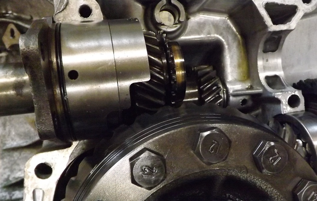

Some more gear pictures and questions.

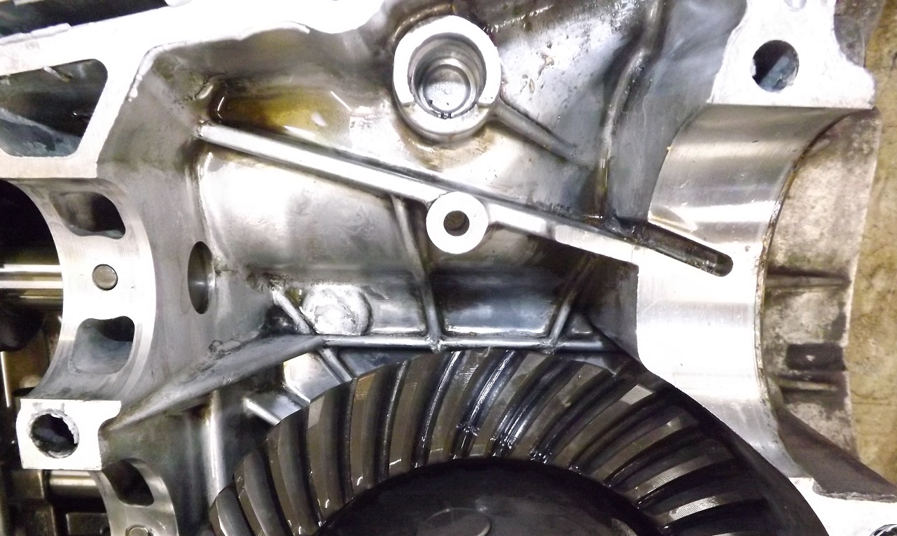

Guy I got the trans from showed me a picture on offroadingsubarus.com of an additional hole drilled in the input bearing sleeve.  I don't see how it would do anything.
In this picture you can see the hole between the bearings of the input shaft support.
This picture shows how the ring gear would sling oil up onto a shelf and into a slot that aligns with that hole.  On the left end of this picture you can see the pin that I assume holds the reverse idler shaft in.  Does anyone know how to remove that?
Then I assume the oil also goes in this hole to lube the needle bearing supporting the other half of the input shaft.
Here you can see shifted all the way into reverse the idler gear is only about half in mesh with the gear on the shaft.  If I can get that apart I'll make a spacer to get those gears to line up better.
My old trans had a good snapring for the bearing behind fifth gear.
It also had a good C plate but it has a different number stamped on it than this one.  They do measure less than .010" difference in thickness.  I see the dealer sells two different plates, I'm tempted to just order them both and use the one that matches the one that was in this trans.
Other than that the main thing I need is that brass synchro / baulk ring for the low range.  If anyone knows where to get one I'd love to hear it.  Otherwise it looks like this one could be deburred and made to work for a while, but it's pretty beat.
Think you will find spare parts for your dual range easier and cheaper in Australia rather than Europe. Check on www.offroadsubarus.com
Thanks, All Drive Subaroo in Australia is shipping me a synchro ring and needle bearing.  Hopefully it will be here in the next couple days and we'll put the trans in next weekend.

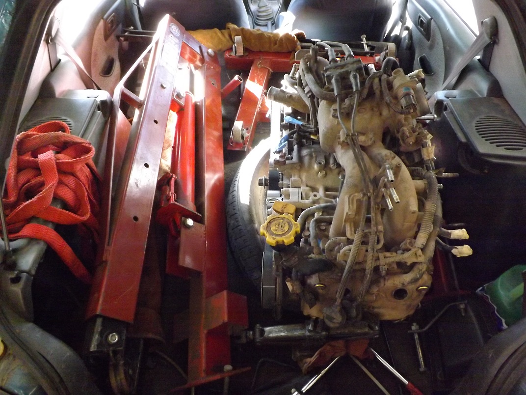

We put the engine we just assembled in my friend's Forester and hooked everything up.  Went pretty quick and easy.  On the downside that means we've done a bunch of Subaru engine swaps now.  His ECU seems to be dead, it was underwater for a while, he's going to get another one and see if he can get it running.
The d3sert has a way of eating rigs lol and thats 90% of my wheeling in the last few years on th3 flip side im broken and im getting old and my wheelin is starting to reflect that all the hard core wheelin is done in scalers now lol so much easyer on the body and wallet Try soaking the ecu in carrosion x ive brought back a few electrical items with that stuff its great for underwater electrical stuff as long as nothing shorted out and fried
Picture of my Impreza loaded up with an EJ25 and engine crane before we put it in my friend's Forester.

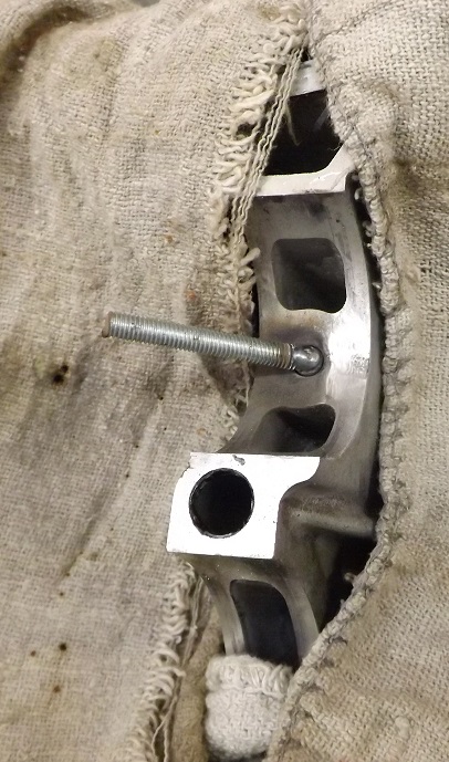

This is the only way I could think of to remove the pin that holds the reverse idler shaft in place.  Surrounded it with rags to prevent weld spatter from getting in the trans and welded the end of an old bolt to it.
Then it pulled out easily.
Obviously I cut that off and ground it flush when reassembling the trans.  These pins seem like a semi posterior way of holding the shafts, I hope I got them lined up with the holes in the bearings but it was hard to tell.

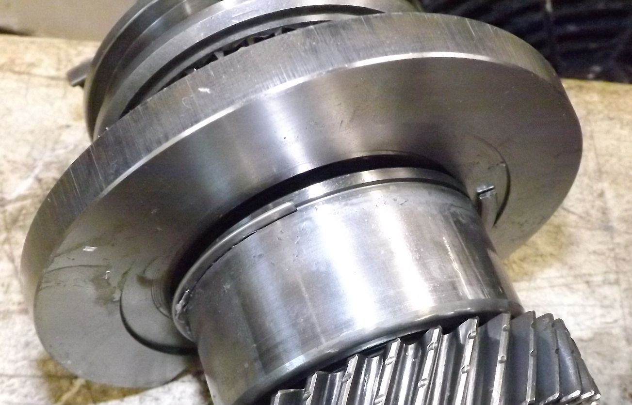

I turned up a brass spacer, seems like it should be about .800" ID x 1.56" OD x .25" thick.  Made reverse gears line up much better.  Could have made it out of aluminum.  Thanks to ivans imports for this tip.
Next step was to test assemble.  Put everything in the left housing and bolted the input flange, pinion shaft flange, and center diff housing on.
This made it clear there was some preload on the input shaft, which may have been what caused the death of the brass synchro ring and coloration of the needle bearing.  I had looked for shims this size with no luck.  I wound up using some ~1mm thick 8mm fender washers and cutting the edges so they sat flat.  Then everything spun freely.
I've got it all together now.  Shifts through all the gears and hi/lo and turns freely.  A couple of the bolts holding the center diff housing on are questionable, but other than that it seems good.  Plan is to put it in on Saturday.

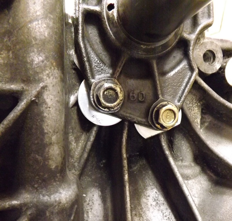

Sometime after the V2R I noticed grease around the LR CV joint on the knuckle, probably coming from the wheel bearings.  Hasn't been making noise but it was slightly loose.  Planning on going on a long vacation with the car so figured I should replace that to be safe.  I think when I put the rear wheel bearings in this summer I packed the area between the bearings and seals with grease, I'm thinking that blew out when they got hot during the V2R.  So I took it apart.
I am not sure if the spring on the outer seal broke before or during disassembly, but there's definitely grease all over the knuckle and hub.  Also there's not really any grease around the rollers.  Not sure if that's because they pushed it out or from getting hot, or not being packed properly.  This time I put a little more grease in the middle of the bearing than they came with but didn't really put any between the bearing and seals.

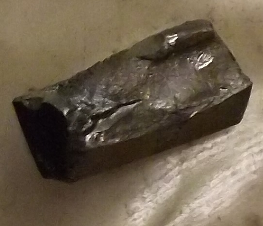

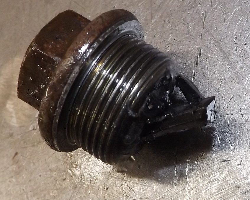

When I pulled the drain plug out of the old trans, there was a gear tooth stuck to the magnet.  I'm guessing that's related to the noise in first gear.

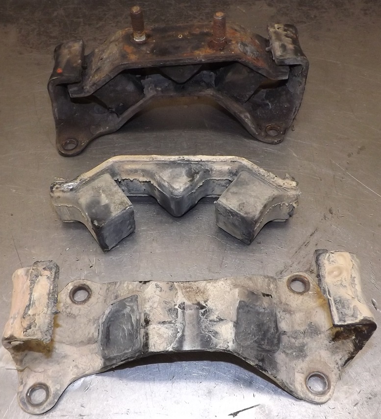

Also the trans mount had sheared apart.  Not a big deal, it's super soft anyways and the design keeps everything in place even though the rubber isn't attaching both halves.  Had another one off another trans we put in (top).  The whole engine and trans are pushed back in the car maybe 1/2", probably why this one eventually ripped apart.

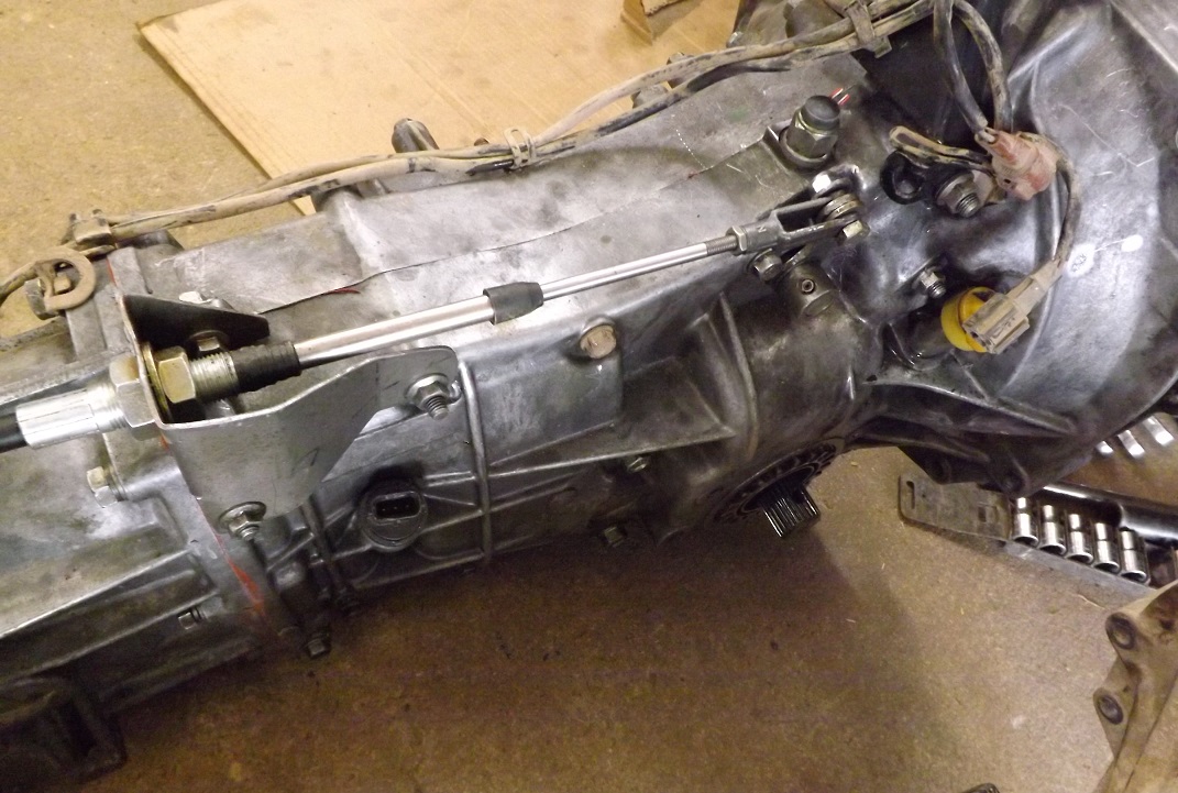

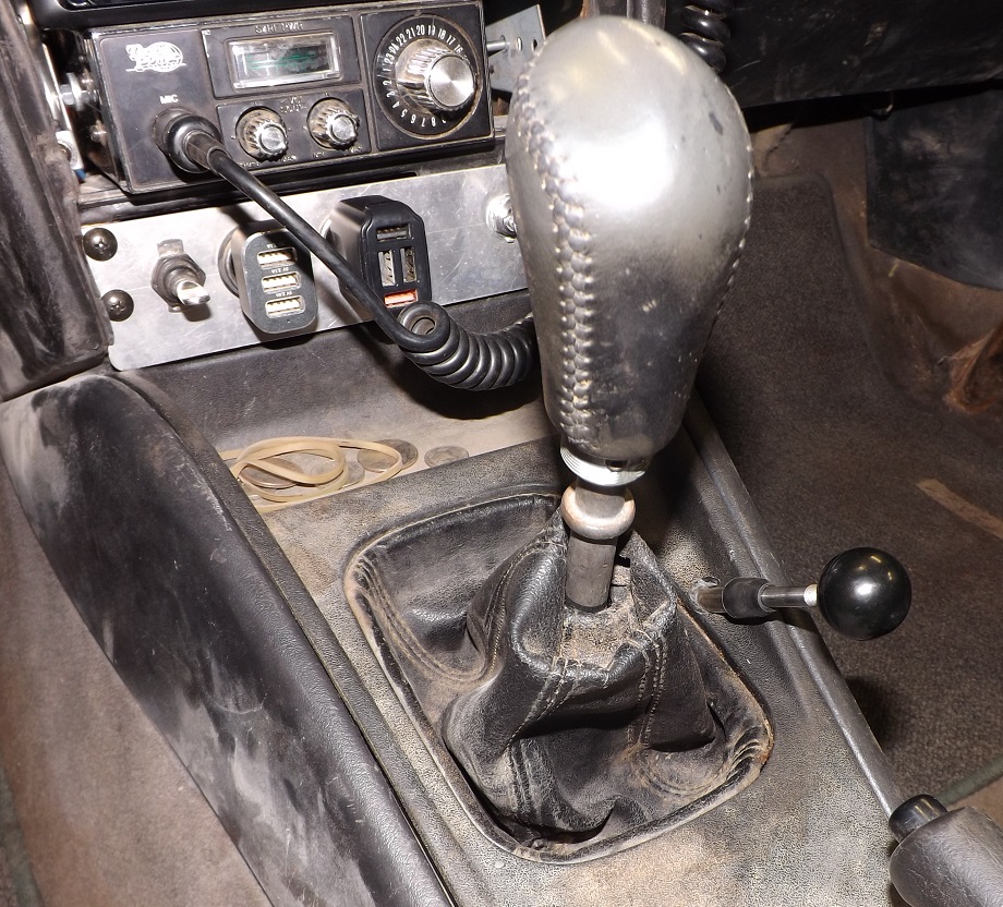

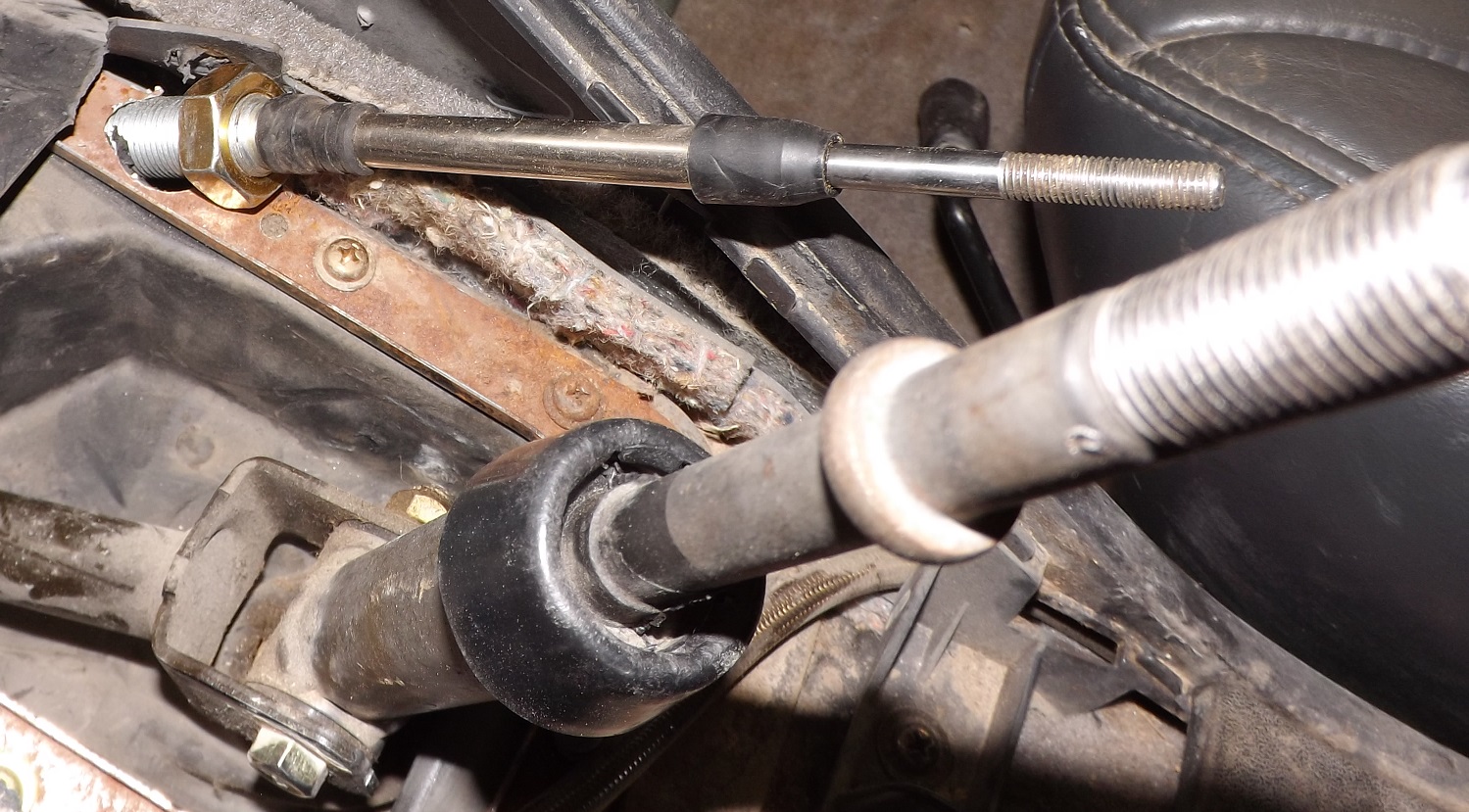

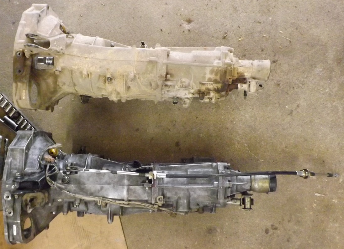

I got a control cable, clevis, and knob from McMaster.  Had to drill out the hole in the clevis and my friend made a bracket for the cable on the trans.  We thought it would be best to attach that end of the cable sheath to the trans so it didn't shift when the engine and trans move around.  While he was doing that I replaced the radio.
Old dirty broken trans vs clean functional dual range trans.
I made a slotted hole next to the shifter for the other end of the cable to go through.  We were limited on options by the length and stiffness of the cable but this worked out well.
Seems to work as you'd expect, shifts smooth but positive. High/low has synchros so you can shift at speed. You can go really slow in low first with the six cylinder, like 500-700 RPM and it seems like you're barely moving. Second gear in low is basically the same as first gear in high. I'll probably test it out in the woods soon but I can tell it will be invaluable in certain situations.
Don't push too hard in low range especially with the H6...
Now you have to install a DCCD and you're done !
I will try to use the low range as little as possible and try to go easy on it when I do.  As you may have noticed, I'm not real big on driving slow.  Considering I've already broken two transmissions and a rear diff, 60% more torque into the gears is scary.
