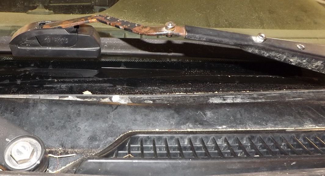

I noticed the passenger side wiper arm has a little bend to it.  Pulled up on the driver's side wiper arm and it seems to increase the force on the wiper.  Bent the wiper arm to give it a little more preload.  Haven't driven the car in the rain but judging by spraying water on the windshield and running the wipers it definitely helped.  Also gets the spring a little farther away from the windshield, that was still rubbing occasionally.  My friend thinks it may have been bent originally and has been flattened out by hitting too many tree branches.

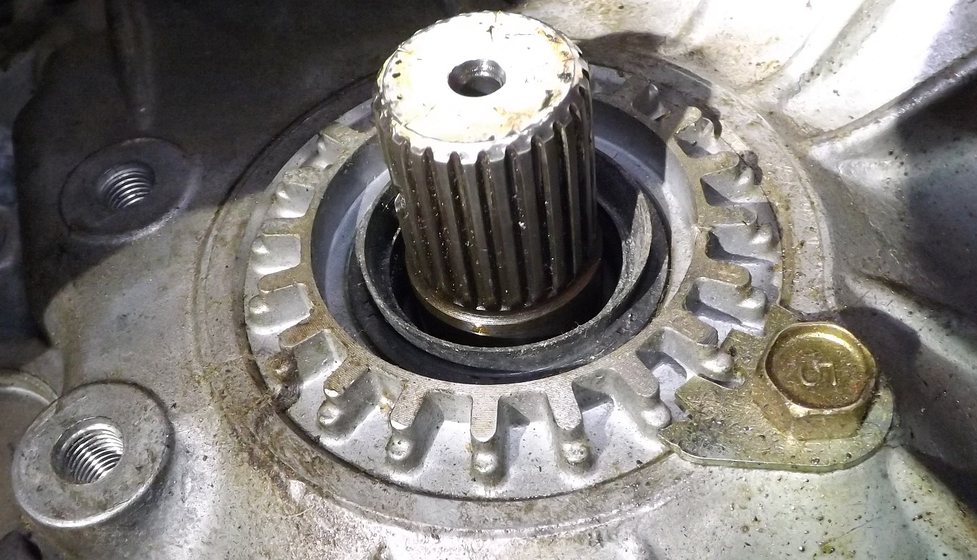

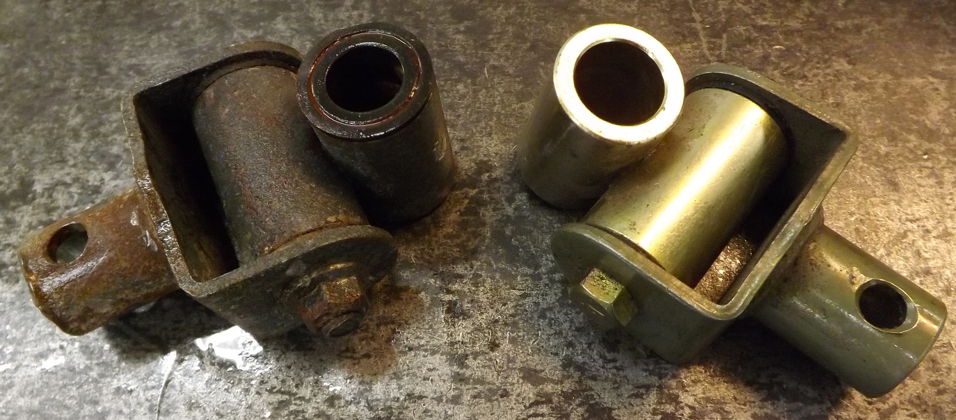

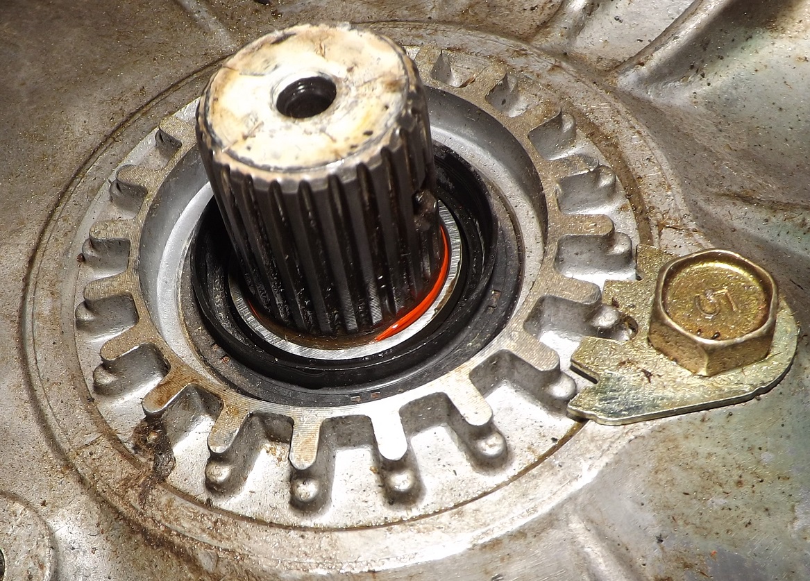

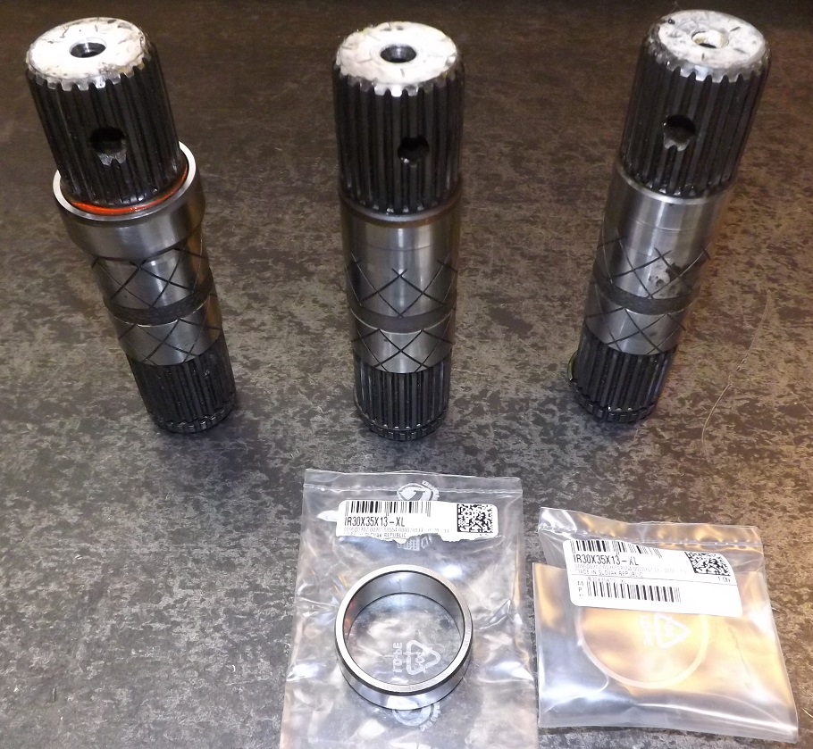

The main issue keeping the 2005 Forester trans from being a direct swap was the axle stubs and seals.  I have a few 4EAT stubs and they fit the front diff but the seal diameter on them is 30mm.  The seals on the trans are much bigger.
I thought about buying or reusing some 30mm seals, the OD measures about the same.  Instead I ordered some IR35x30x13 inner bearing races and siliconed them onto the stubs.  They're smooth and hardened so hopefully the sleeves and seals will last a long time.
They seem like a good fit in the seals, there's a good amount of tension.

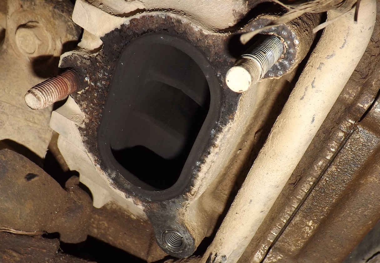

The next issue I ran into while reassembling was one of the exhaust studs started pulling out of the head.  I unthreaded it, drilled and tapped the head, and installed a threaded insert.
Trans is quiet and shifts smoothly.  Alternator is back to putting out 15V, not sure why.  Engine is back to cutting out for a split second occasionally.

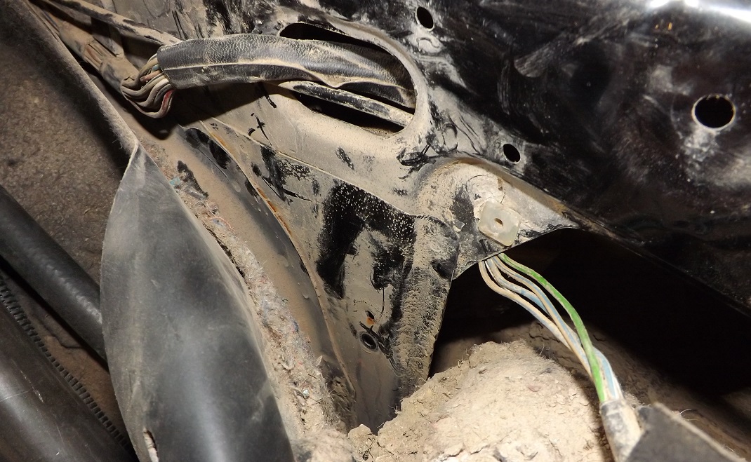

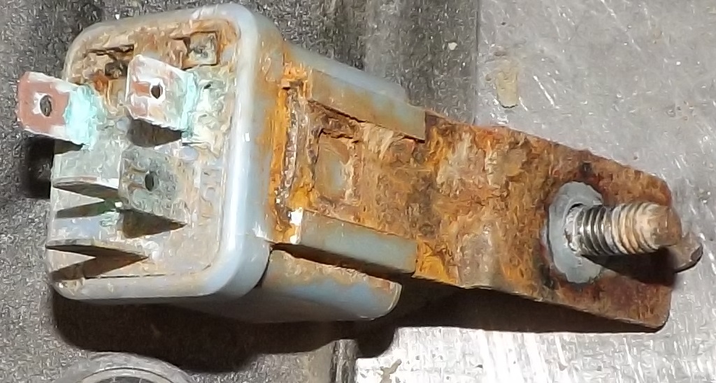

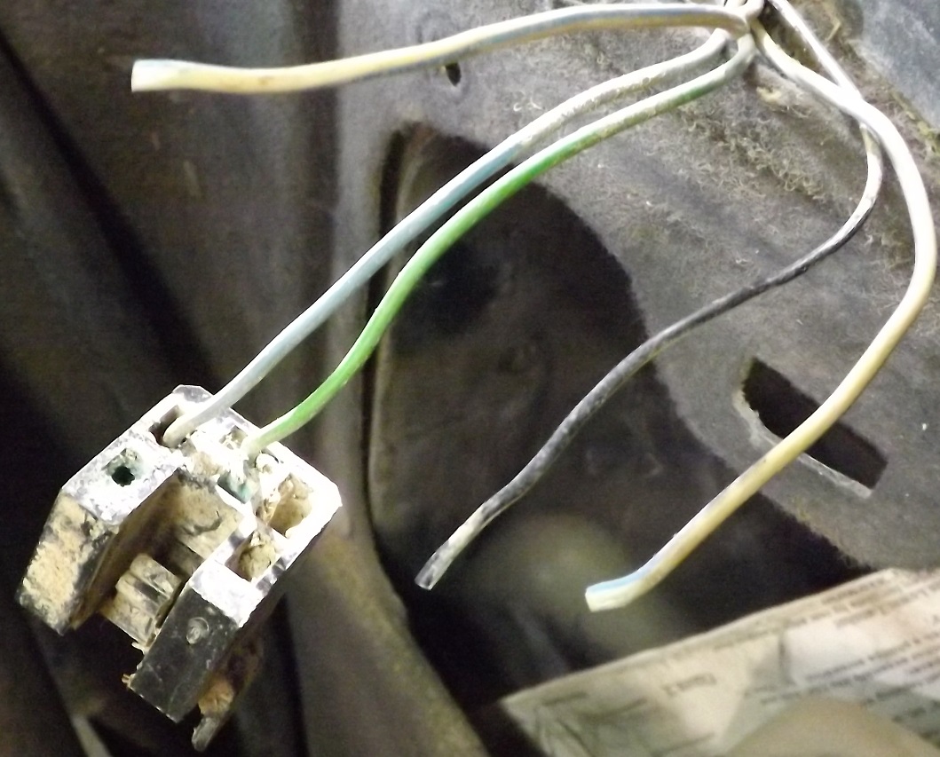

Rear wiper hasn't worked for at least a few months, we've looked at it before, seemed like the motor was good.  I tried to find the rear wiper relay based on the wiring diagram but couldn't.  Had my friend look at it and he noticed some wires going down out of the main bundle behind the RR wheel well, those went to a relay that was bolted into the hole in the bottom center of the picture below.  Amazingly that nut just threaded right off.
Since that wheel well hasn't been sealed in a decade or so the wiring was corroded and broken.
I cleaned up the terminals on the relay and put new female spade terminals on the wires and the rear wiper works again.

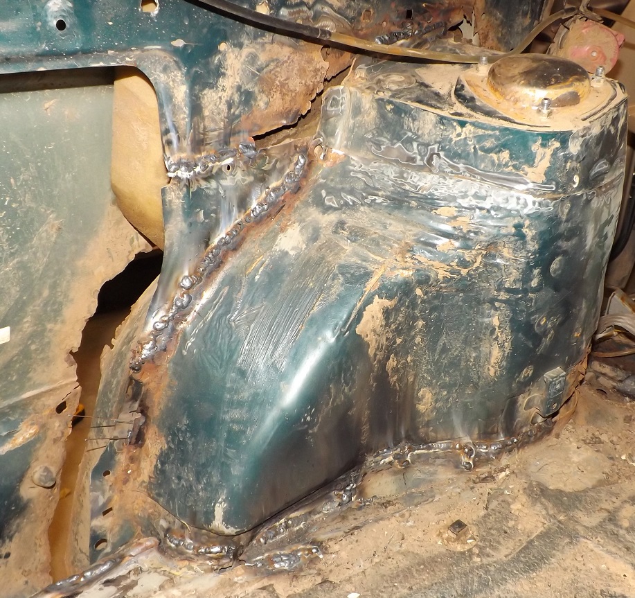

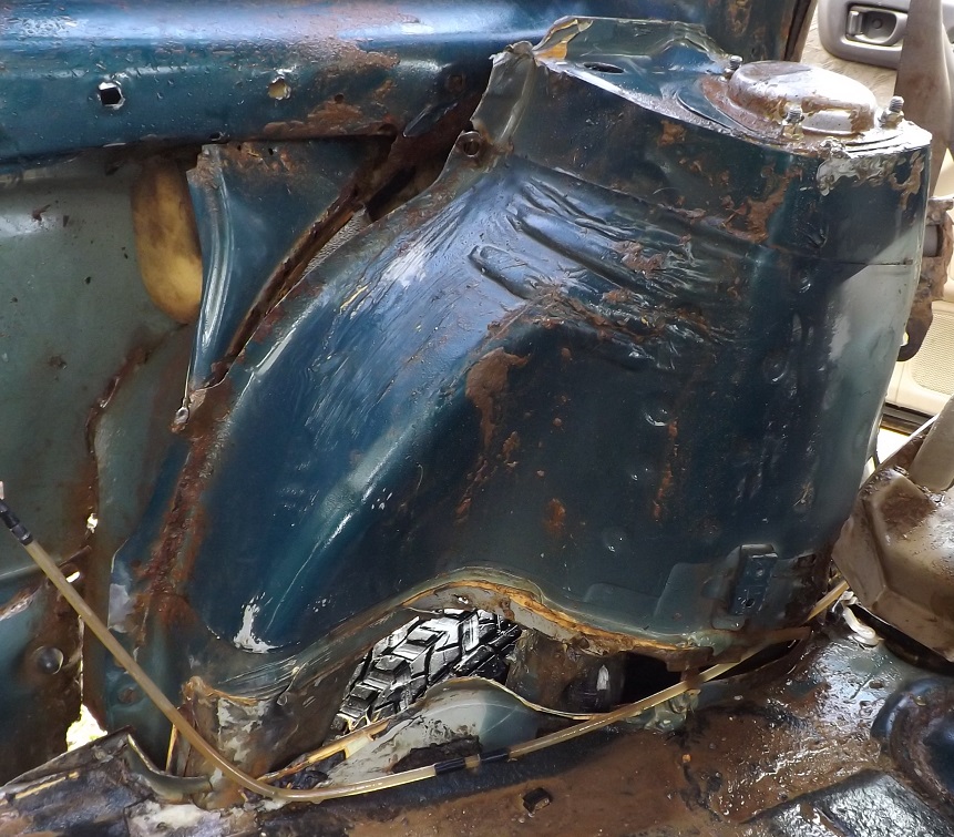

B had pointed out his LR strut tower seam towards the rear of the car was pulling apart earlier in the weekend.  I didn't think it was a big deal since it was towards the rear.  Then I saw the 2-3” gap between the floor and the bottom of the strut tower through which you could see the foam around the spare tire well.  We brainstormed some ideas for fixing it and K threw out jamming the spare tire between the top of the strut and the roof.  We were able to do that with the tire deflated and propped up the top of the tire with a 2x6 down to the bottom of the RR strut tower.  Then we inflated the tire and when C lifted up on the LR corner of the car at the bumper the gap closed up some.  It did cause a bulge in the roof and wrinkle above the window.

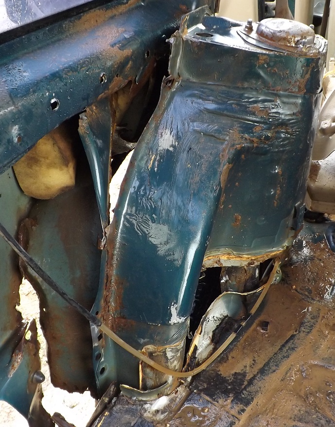

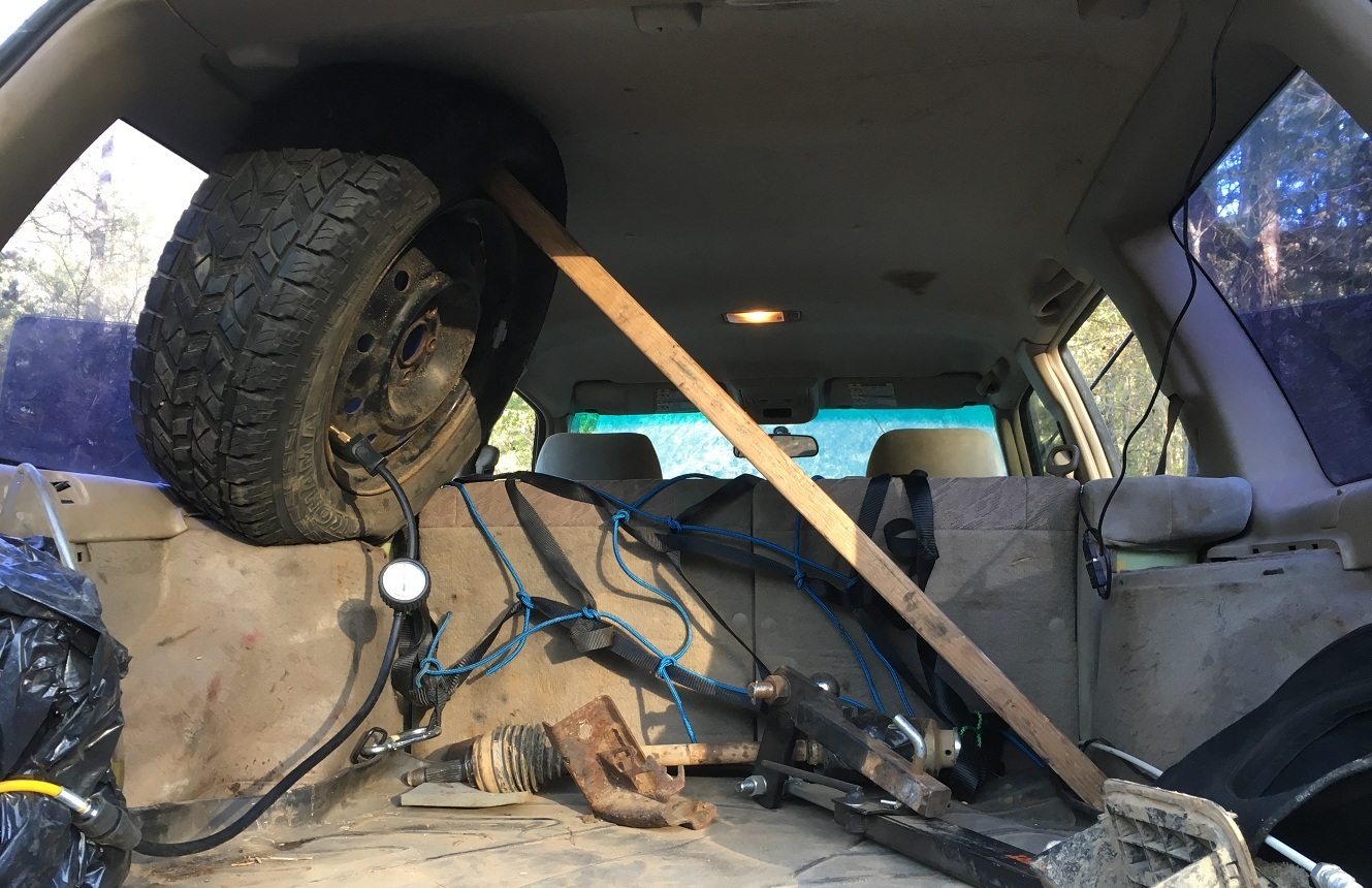

This is what the Forester strut tower looked like without the spare tire holding it down.  Not attached by much.  Most of the front seam was separated too.
With a scissor jack and some boards we were able to get things back into place and welded as we went.  Welded a few seams on the other side to try to prevent this happening.  He is stepping up his rust free Forester search.  PM me if you know of a good rust free manual trans 2000-2008 Forester for sale.

cars who where never build to hold long travel suspension and thats result. its sad to see them in this state really. and i bet in that trip long travel suspension was not even needed .
I'm guessing the rust was more of a factor than the long travel.  If anything the long travel makes life a little easier on the body since you're not bottoming out so hard.
On my Outback I started breaking the rear strut towers loose years before we built the long travel, welded them back on and haven't had to fix them since.
I don't know that long travel suspension is ever needed, but it often lets us drive faster and hit some jumps without breaking our cars.  Once you've driven off road with decent suspension, driving with the stock suspension seems a lot less fun.
i thought i have rust but OMG that forester is just braking apart. yh more speed can brake cars . its because subarus just love speed and its fun to drive them even with oem suspension.
maybe that forester need strut bars front and rear there to keep those in place. imagine that happens to my daily driver i would cry ..,lol
Don't cry just fix it.
I don't think a rear strut tower brace would do a whole lot and would make it harder to put large objects in the back of the car.  We talked about putting in a rear roll hoop and some tubes down to the "frame rails."  Hopefully this fix will last for a while.

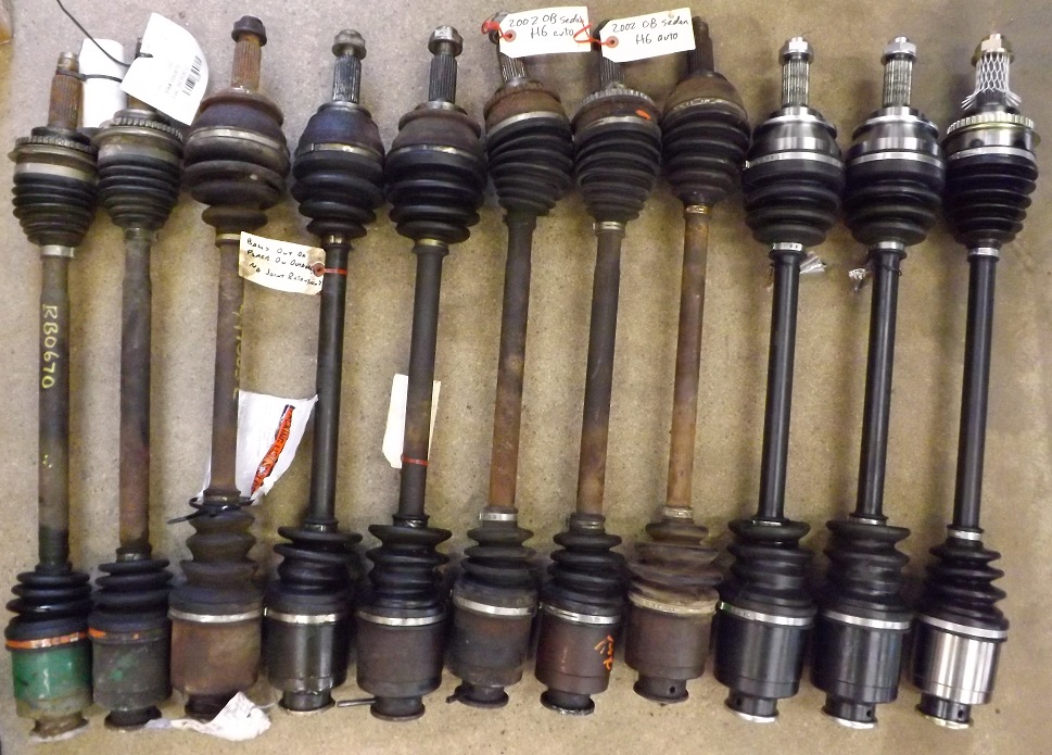

Went through a pile of front CV axles to try to figure out which ones were long enough for our longer control arms.  Still haven't found out if the yard in town with the SVX has the axles for it, want to measure those.  These are most of the front axles I have:
Long story short the Legacy FWD axles are biggest and longest but still have a similar compressed length to the normal EJ front axles.  The 02-04 Impreza sedan axles are long also, but don't have a lot of travel so the compressed length is longer than normal too, which probably isn't a problem.  The joints on those axles are basically the smallest of any we measured though, so I'm guessing we would wear them out fast.

The 3rd cv joint from the left looks the same as an SVX. What are the lengths compressed and extended ? And is the outer cv 3mm larger than a Forester cv ?
I definitely want to find some SVX axles then.  I believe the third from the left is a FWD Legacy axle.  They are 677-680mm compressed and 730-735 extended.  Outer CV is 5-12mm bigger diameter than what I think are standard EJ axles.
The axles we think are normal EJ are 677/722mm.
