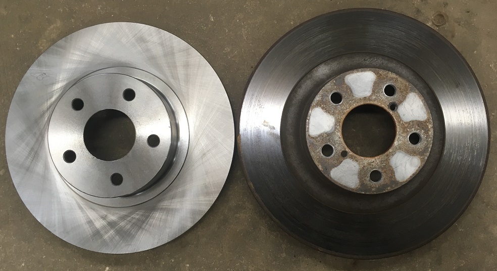

Putting smaller (276mm) front brakes on the 2002 white Outback so I can put 15" wheels on later.

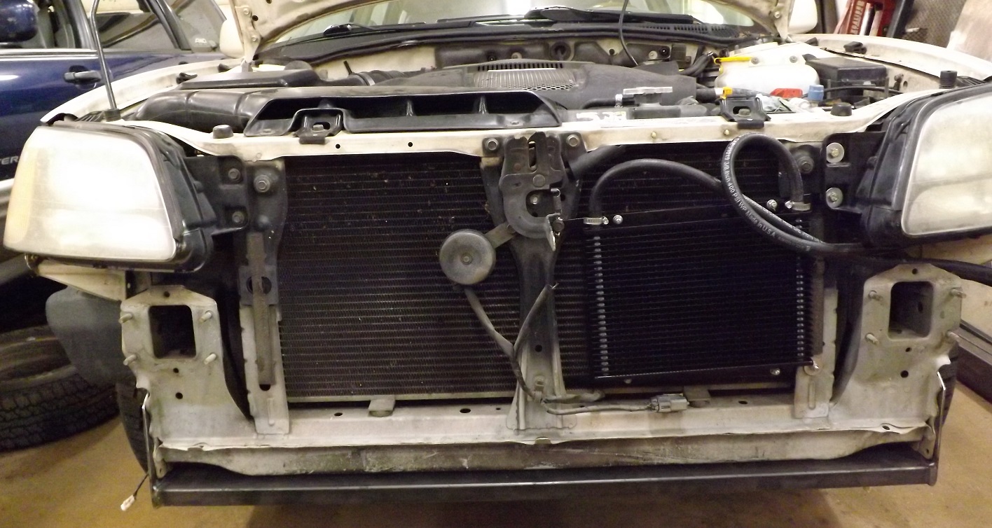

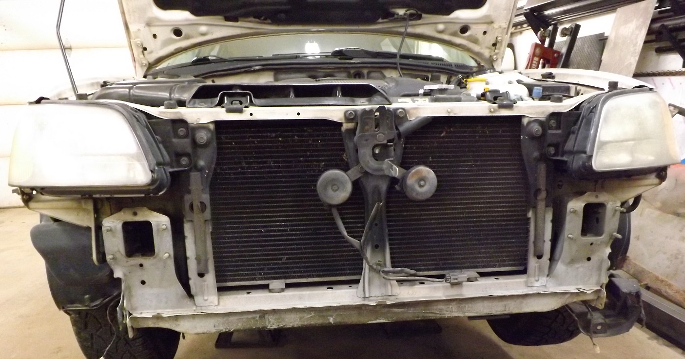

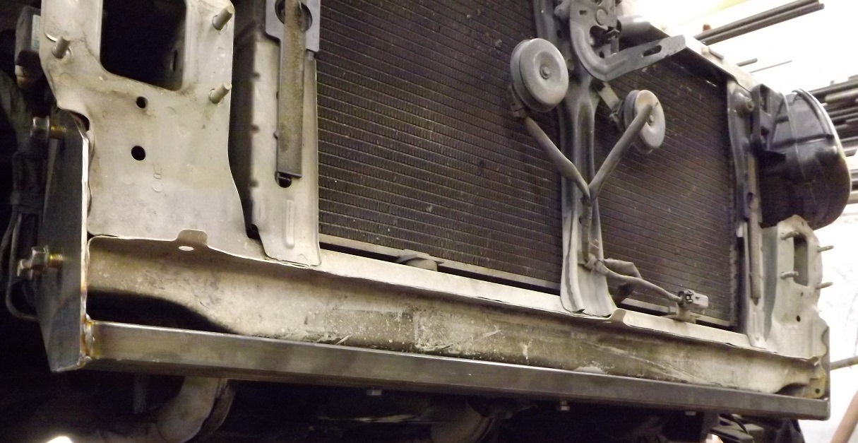

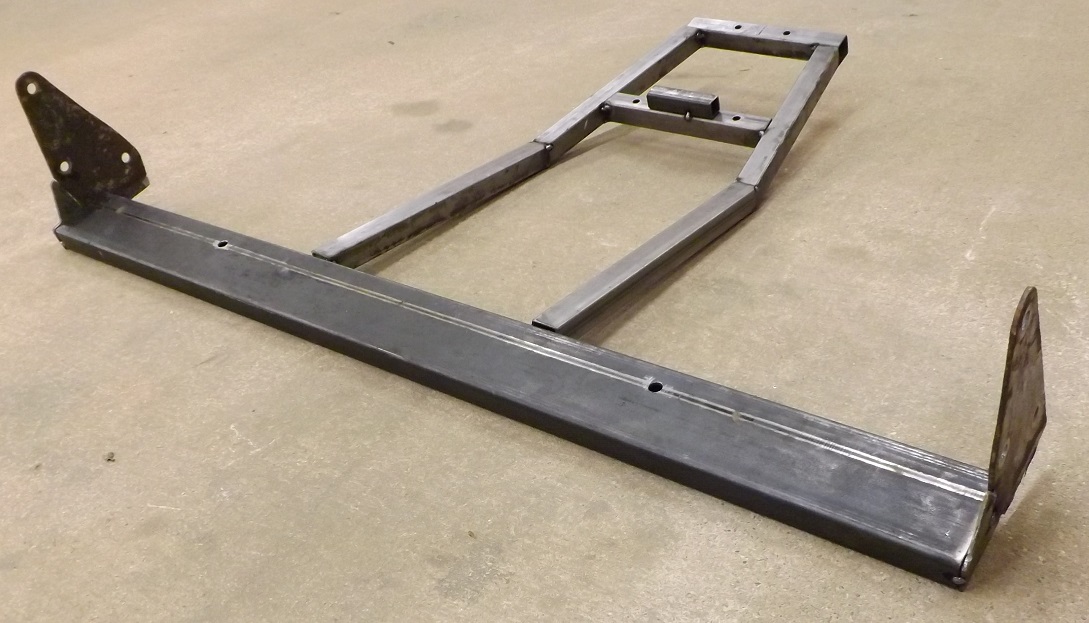

Started on a skid for the oil pan and realized I didn't have enough tubing for mine and my friend's Forester and his needs to be done sooner.  Got the front part done though, bolts into the radiator support and in place of the tie down loops.

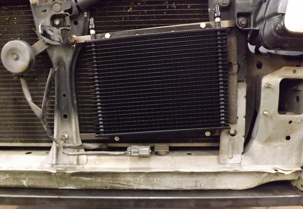

Mounted a transmission cooler in front, didn't have to drill any holes.
This is what it looks like with the mounts painted and lines installed.  Curious to see how the auto works off road.
This is the skid for the Forester so far.  It will have a plate between the square tubes on the bottom, the tubes will give it some bending strength and should be a little more ground clearance than what he had before.  This is roughly what I'm planning on the 2002 Outback.  I also plan to run square tubes from that front beam to the swaybar mounts to brace things and guard the exhaust.
I also tried to get the gas tank guard we built for his 2000 Forester on the 2001 and it didn't quite line up.  Shouldn't take too much work, we just ran out of time yesterday.
can you tell me what benefits that trans cooler gives ? like you need it for offroad use ? for heavy low gear driving i guess ?
The way he drives, more transmission cooling is definitely needed. You can over-cool the fluid, but if the extra cooler is plumbed in series before the radiator, the coolant will re-warm it to the ideal temperature. More transmission coolers is definitely better. I add coolers and usually gauges to most of my auto transmission cars.
I think that's the exact same one that I used, in essentially the same place. I used the little zip-tie mounts through the condenser and mounted it behind the support, but whatever.
It's really nice to be able to put my hand on that cooler when checking the oil on a trip to see how hot the transmission is running.
