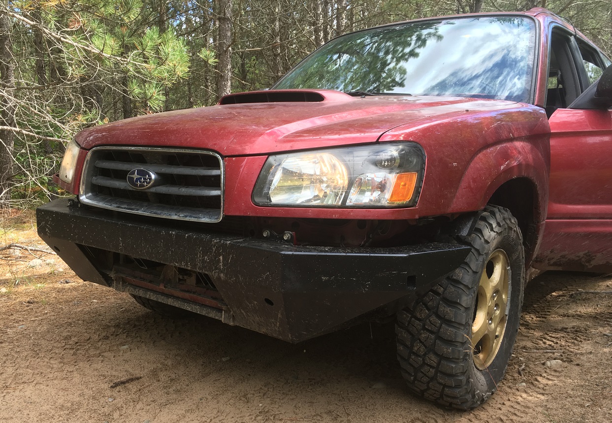

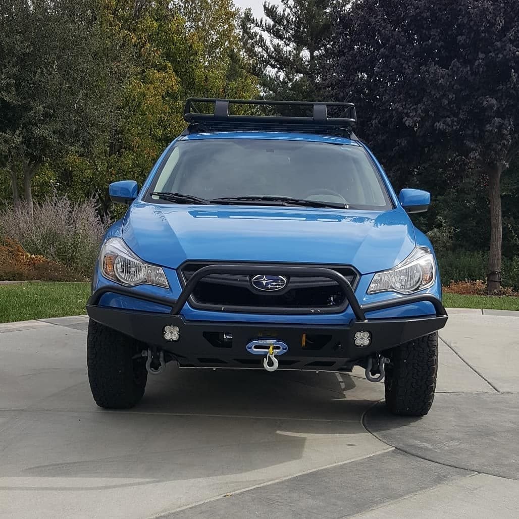

Looks sweet! Any plans to fill the vertical gap between the bumper and the fenders/headlight trim/grille?
It would be more sano but we figured when the bumper shifts around it would break the grill and trim.  Also the grill probably hangs within an inch of the top of the bumper.  He's also thinking about adding some lights or small light bars between the bumper and headlights.
He's trying to decide what color to paint it.  The rear bumper and all the trim is body color so that's my vote.  He's got some gold wheels he's going to put on and thought about painting the bumper gold.  We talked about painting it black too and/or using a bedliner (rough) paint.  Thoughts on that?

Lights below the headlights would have the same potential to contact the headlights as having steel there.  If you cut the plastic bumper cover to fit, I think it would have enough give to be a non-issue.  The plastic bumper might overhang the metal bumper though; not sure what to use in that case.  More example pictures of cut bumpers because they look sweet:
As for lights, I'd put them in the grille area and cut out the grille to make them fit.  Purely aesthetic reason.  Although if you could fit a super-long light bar between the lights and bumper that was the full width of the bumper, that would look pretty sick too.
My vote for paint would be black rattle-can bedliner.  Black because it's low key - I think gold would stand out and look really out of place, and if you use body color it will really highlight the gap between the bumper and body in a bad way.  Rattle-can bedliner is inexpensive and easy, the texture will hide any imperfections, and when it gets scratched it's easy to touch up.  Either color without texture will show off any dents or unevenness in the flat sections.

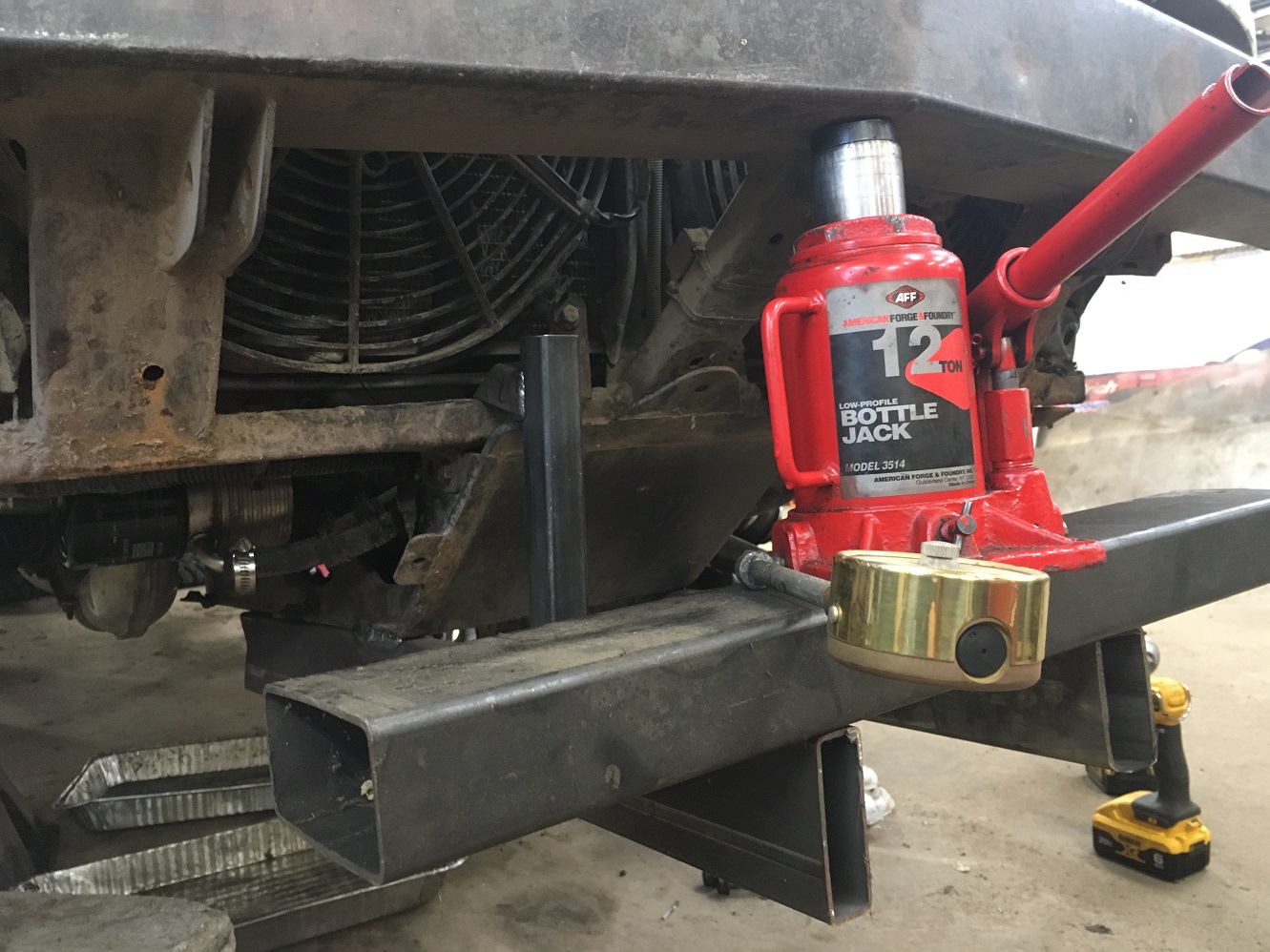

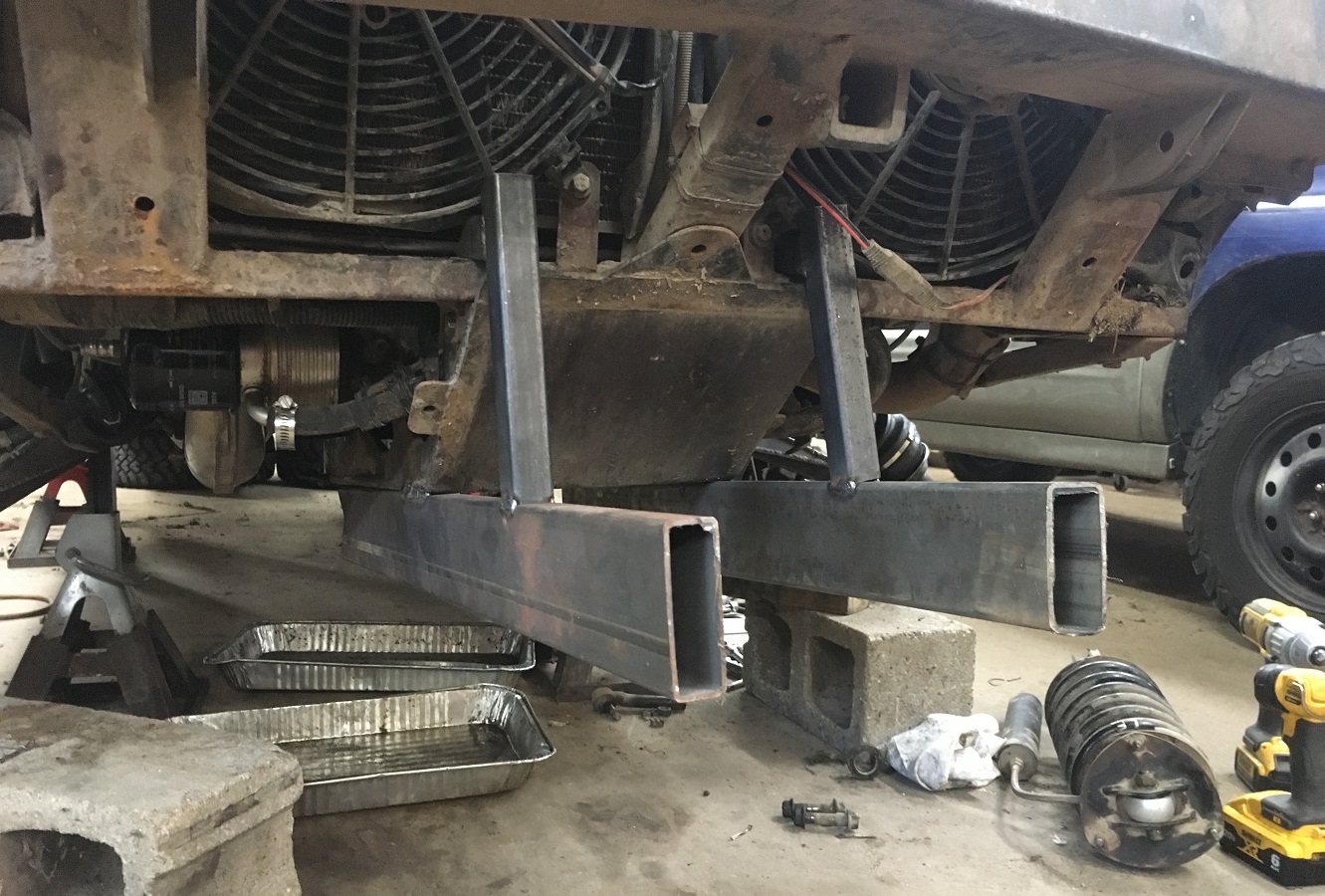

what are dimensions and the wall thickness of the square? tubing you used as the main beam?
And the plate for the rest?
1/8th in?
I want to make a similar bumper for my 98 Forester.
Trimming the stock bumper cover is a good idea, especially if he doesn't add lights between the bumper and headlights.
Good point that if the bumper was body color it would really show the gap between the trim/fenders and bumper.
Everything is 1/8" thick.  Mild steel tubing 4"x4" and 2"x4", 4130 plate.
My opinion is paint it black for sure and trim the bumper cover. Add lights to the bumper or inset. What's left of my bumper cover stays attached to my car much better than when it was whole and it looks damn sano. I left a small gap between the bumper and the cover, about 1/8".
Well done on the tubing mixed with the sheet metal: I've modified mine twice and plan on doing it again to make the center punch much stronger.

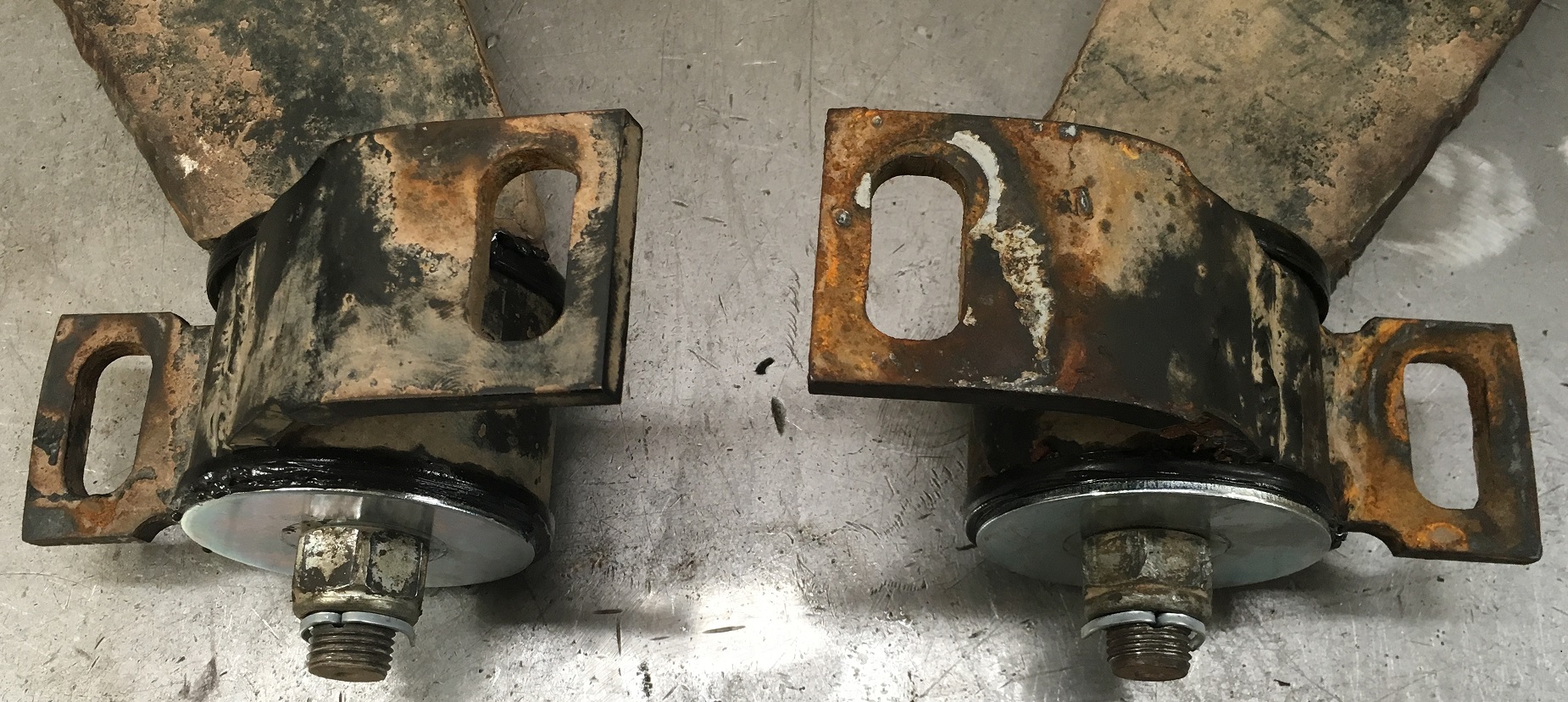

I would also recommend getting new engine and trans mounts, especially if you are using the car off road.  Both trans mounts were split but they have a stud with a rubber faced washer and a nut holding it from moving too far.  All the engine mounts for these early EZ30s I've had off are either already split or cracked, some of them you could pull in half by hand.  The engine mounts on my 2002 white Outback weren't too bad but I should replace the engine and trans mounts over the winter.  At the same time I'll probably make a heavier duty replacement for the middle section of exhaust.

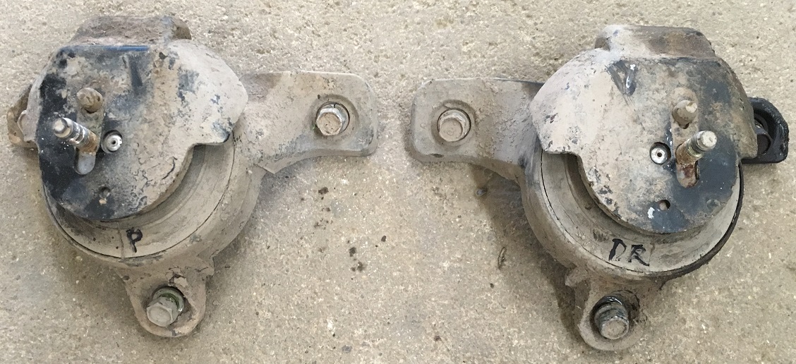

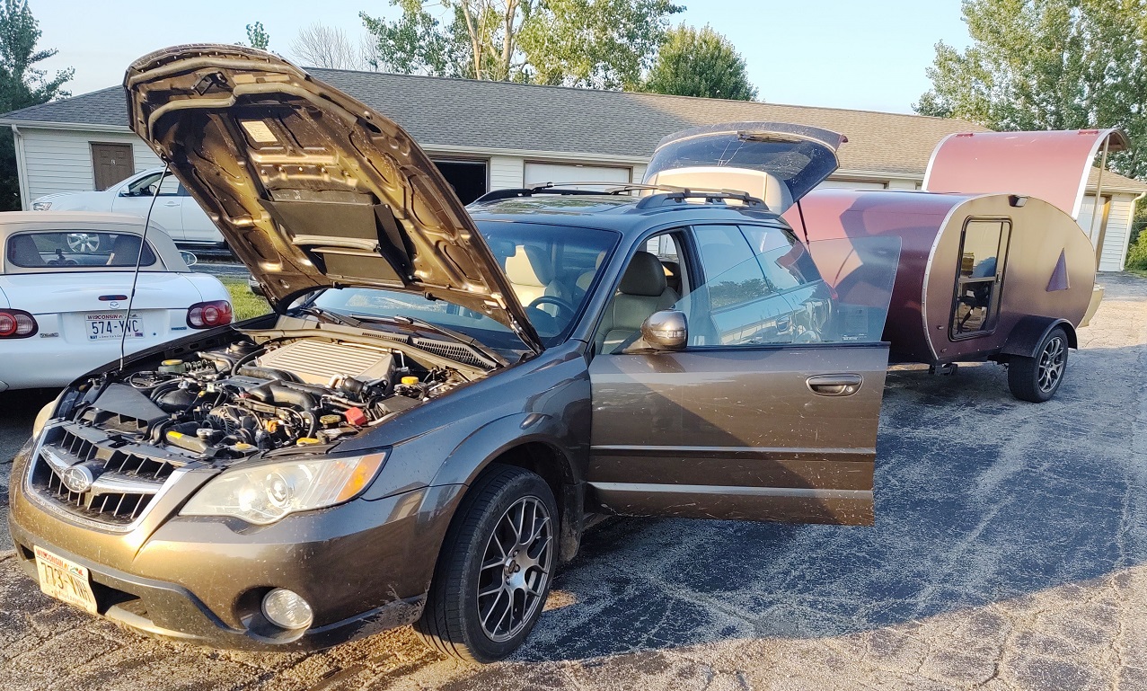

While the engine was out of the white Outback I tested out whether the H6 engine mounts can simply be switched side to side to provide some engine setback.
This is how they look in the stock orientation:
The bolt holes don't quite line up on the engine if you put them on the opposite side but a little slotting would solve that. I think the pads that bolt to the engine are not parallel to the pad that sits on the crossmember so it would put some stress on the rubber when the nuts are tightened. The pads don't sit flush on the crossmember when switched side to side either (or I would have taken a picture) but that could probably be fixed with some hammering.
Swapped some other parts over to the engine and trans from the parts car.
J stopped by Saturday morning and helped me get the engine and trans in the car and mostly hooked up. He left just before B got to town. B called saying that he'd blown up the ball spline rear axle just as he got to town. Balls and pieces of cage fell out when he reached under to feel how badly it was shot.
I loaded up the towbar, lights, and chains and drove the black Outback out there to tow him back. Just before I got to him the engine started running rough again. I let it idle and tried plugging the coil packs back in, one of them seemed to smooth it out a little and it's been running fine since but had no unusual trouble codes (always has torque converter and evap codes now).
First we finished hooking things up on the white car, started it up on stands. I'd forgotten to connect the trans cooler lines at the trans so that puked some ATF out before we noticed and shut it off. It took almost twelve quarts of trans fluid to get it full while running. While we had the front suspension halfway apart and CV axles out, we decided to put on bolt on front wheel bearing knuckles (thanks Slammo). I had one new wheel bearing and one with about 12k miles on it from the black Outback with no slop. Antiseized bearings and new ball joints in them, had to turn up a couple sleeves for the top eccentric bolt (I have long travel struts set up a little different than stock with two modified eccentric bolts). The front dust shields were rubbing badly, bent those in as best we could with everything assembled, but the driveshaft was rubbing on the exhaust under engine or wheel braking. I vee cut the exhaust where it was closest to the driveshaft and welded it back together so it has at least an inch of clearance now.
Over the winter I'll probably replace that center section of the exhaust with something stronger and replace the engine and trans mounts. Other than that it seems to run better than the old engine. Haven't driven it fast yet to see if it downshifts smoothly.

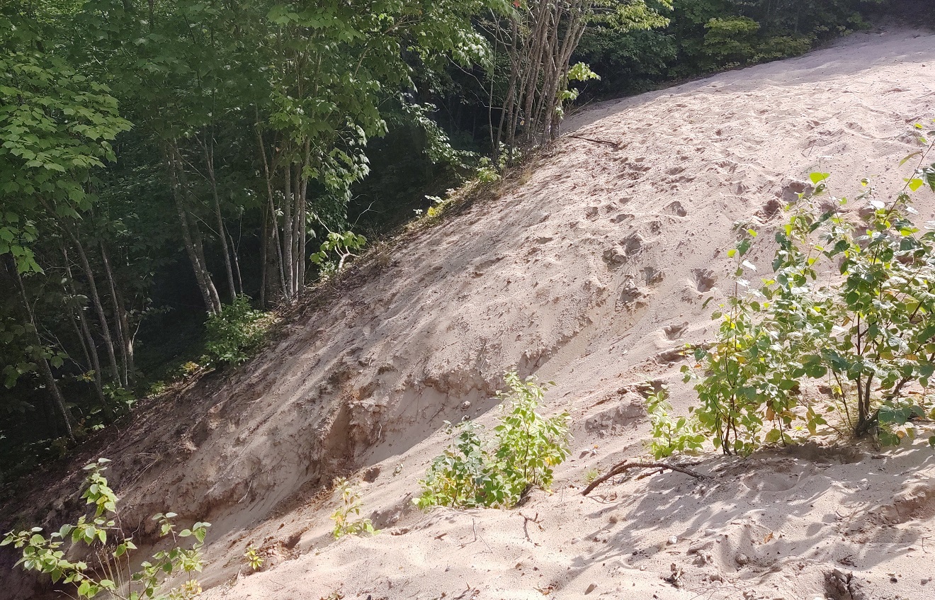

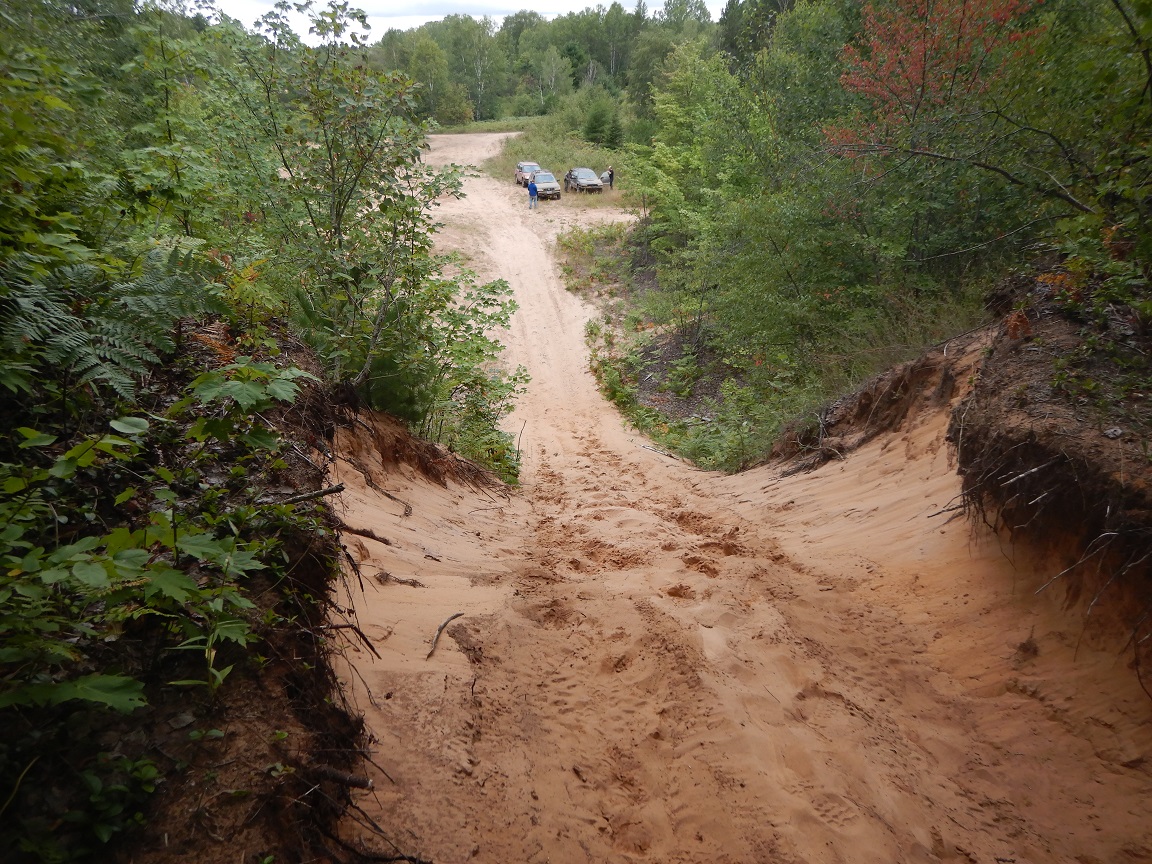

In the morning we paid at the honor box and trail rode up to the giant hill climb we'd found a couple years ago.  Pictures really don't do it justice but this is the top.

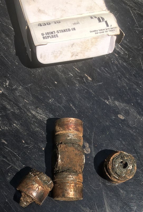

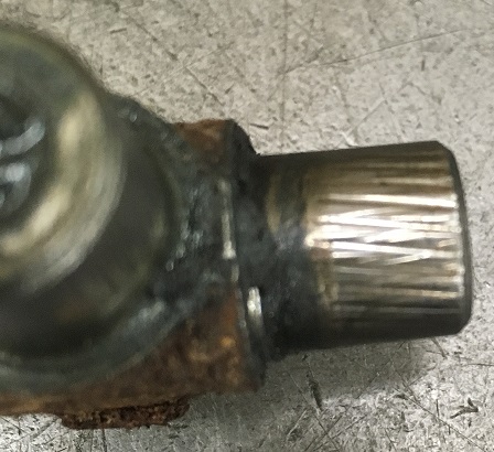

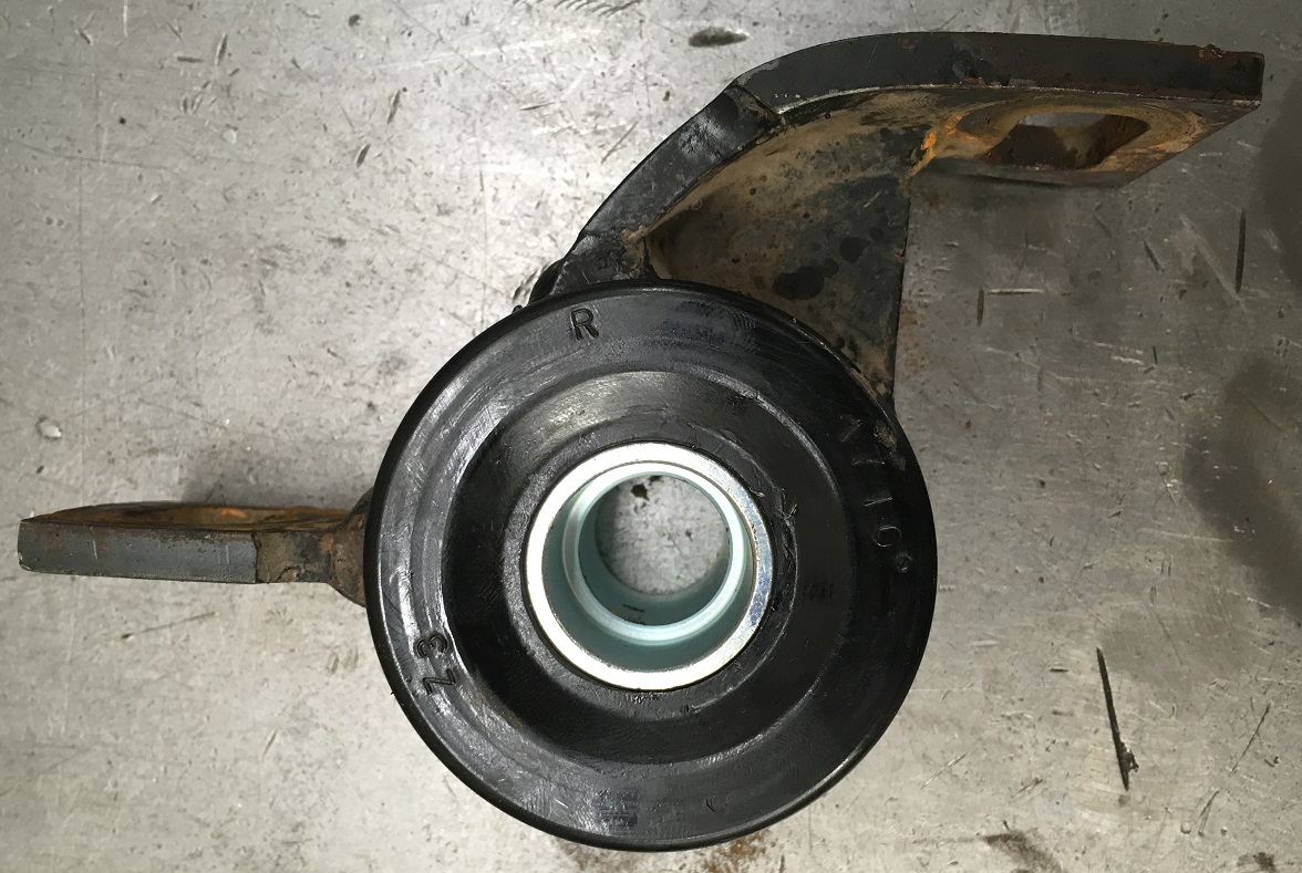

After a while we started hearing a bad clunking noise from the rear of the Outback so I got out and watched M drive a bit, sounded like it was coming from just in front of the rear suspension. Figured out it was a bad u-joint so we got off the trail, jacked up the car, and M pulled the rear half of the driveshaft. The cross had actually broken and at first I was nervous but then remembered I had spare u-joints so I swapped it out and we put it back together.  These have been in the car for about five years.  The downside is since the cups are thicker walled than stock and the cross is hollow it's weaker than stock.  The upside is that it's easy to replace on the trail.
The u-joint at the trans seemed loose too but we decided to leave it and it lasted the rest of the trip. Later on D was driving my Outback with M navigating and they hesitated to make a turn and got stuck in a soft sandy intersection. I told him to stop trying to get out when smoke was coming out from the clutch and the car wasn't moving much. We aired down the tires to about 15psi and I drove out on the first try. I think it was in this section I got the Outback stuck in a big mud hole that B bypassed in his Forester and pulled me out. It was halfway up the door on the driver's side, not quite as deep on the passenger side. There was another even deeper mudhole ahead and I think due to this blockage we had to make a big detour around to get to our campsite. After a while I noticed the temps were creeping up a bit and the fans weren't running, both fuses were blown. There were only a few spares under the fuse box cover so I put in a 20 and a 30 and the 20 immediately flashed out. Later in the day someone noticed there were occasional rubbing noises in Z's Forester. Both rear spring perches were shiny and the tires were extremely close to the strut tubes and spring perches so the rear struts had probably bent a little. We jacked up the car, removed the wheels and tires, and Z hammered the spring perches. I think about this time I aired up. We eventually headed back north up another highway towards the campsite on the bluff I wanted to stay at on Saturday night. When we were within about 20 miles we rode various trails for an hour or so on the way to the campsite. I was relieved to see it was unoccupied on Labor day weekend and the guys who hadn't seen it before thought it was awesome and worth the drive. After we'd been there at least an hour, someone drove there with an FJ cruiser and turned around, they may have planned on camping there and fortunately we'd gotten there first. A cooked dogs, we set up tents, I started to replace a control arm bushing that was blown out on the Outback but then stopped when I realized my spares were pretty rough too. I left the car jacked up on the side to help drain mud/water out of it and left the doors and hatch open overnight. I dug out a few more 30 amp fuses in camp to put one in to power the fan and put a couple more in the fuse box cover for easy spare access.

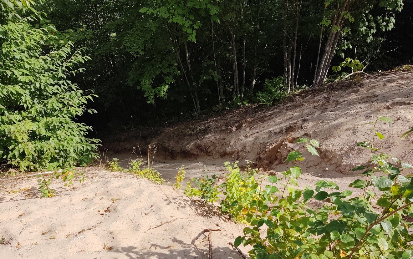

Monday morning we took the highway south to the stunt area south of Seney. When we got to town we filled up in the gas station where we'd flushed out B's clutch on a previous trip. Got to the stunt area and M&B realized it was a lot bigger than the little section we'd looped around you can see from the dirt road. Drove back in it and through some big sand bowls and kept going to a big banked turn and hill climb.
Climb wasn't as bad as it looked at first, B and I got up it on the first try but Z took it too easy on the first try and had to get a bigger run at it and made it to the top. From there it kept going, there was a little loop/bowl around a tree that I made but B got stuck in. Z pulled him out, ran the loop a couple times, and we kept going until we got to a different gravel road. Went back through the stunt area a different way to the dirt road. I decided to hit a small uphill jump. Got decent air at about 30mph but it was difficult to get a good run at it through the soft sand to hit it faster than that so we continued south, mostly off pavement down to 2. When we got back to pavement we cleaned out our wheels at an abandoned gas station (otherwise they shake from imbalance). There is an axleshaft poured into the concrete.

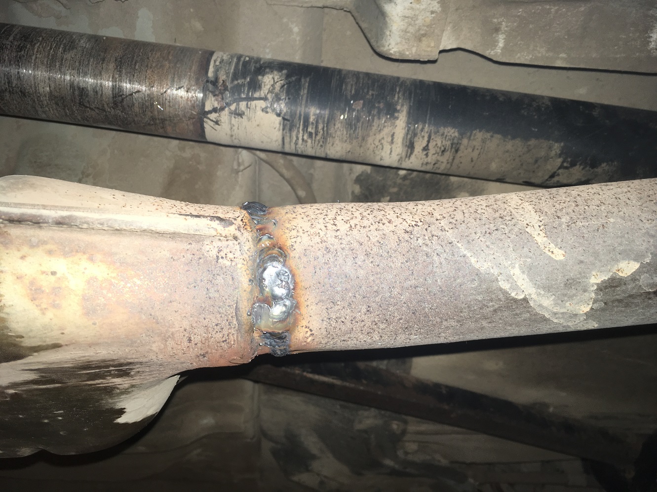

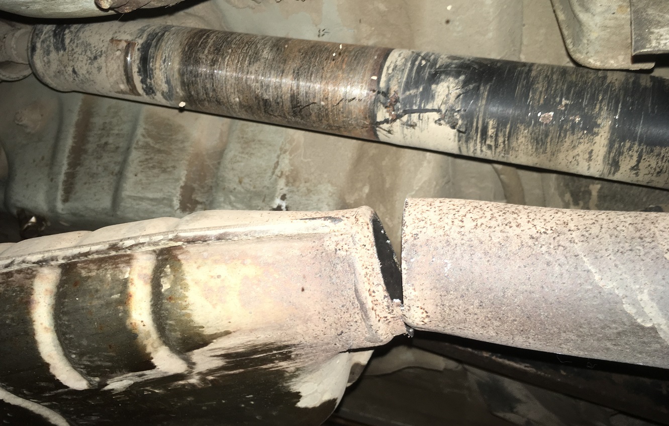

Exhaust is cracked so I tack welded it while it was in place, need to fully weld that now that it's out of the car.

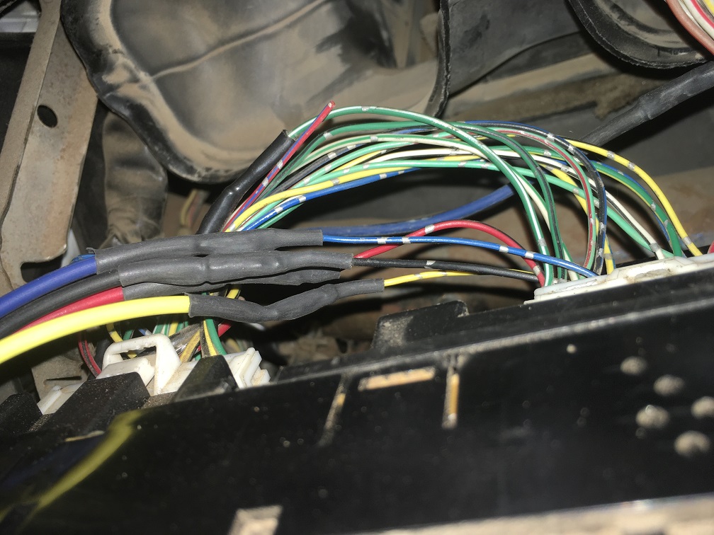

Messed with the fan wiring a bit.  Both fuses blew when I drove it in the mudhole and I replaced them and they were both working.  Later on that weekend I noticed the passenger side (sub) fan is not working.  The fuse is getting 12V and the power terminals at the relays are getting 12V but the coils aren't getting 12V.  So that might be difficult to track down.
I'm also going to try to get the HVAC controls working, my current plan is to wire in a switch to control the actuator directly.

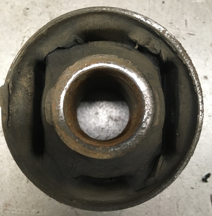

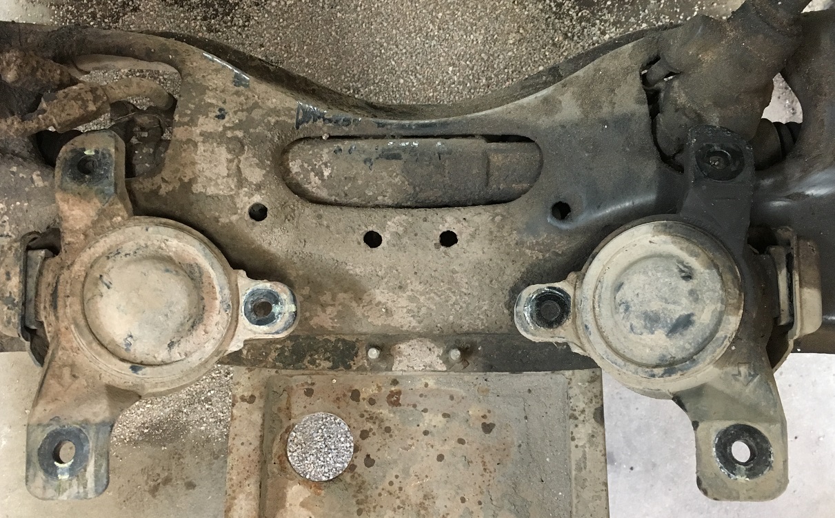

While I had the suspension apart I replaced the rear bushings in the front lower control arms.
I tried the Whiteline bushings again, I think they lastest longer than OEM and are cheaper.
We went through all the struts on my black Outback and B's Forester.  The main goal with mine was replacing some sloppy bushings, I also went through them and replaced some other seals and things.  The main goal with B's was to put on softer springs to get it to sit lower and ride softer, they're about 2/3 the spring rate of what was on the car.

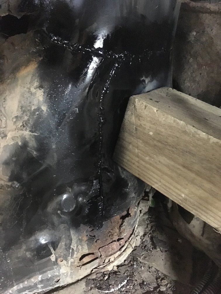

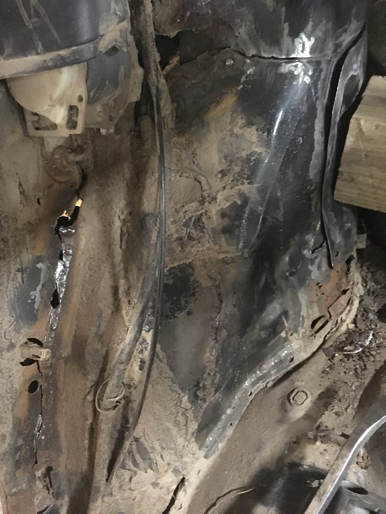

I bent the radiator support/skidplate down somewhere between 1/2" and 2" depending on how you measure it.  Seems to have more engine to skidplate clearance which was my main goal.  Welded those big rectangular tubes to the skidplate.  One thing I added this time we didn't do last time are those square tubes to pull down on top of the radiator support tube.  Without those you're just pulling down on the skidplate tabs.  Both times we've done this we've stopped when the tabs start to rip that tube.  I welded the cracks and stopped there.

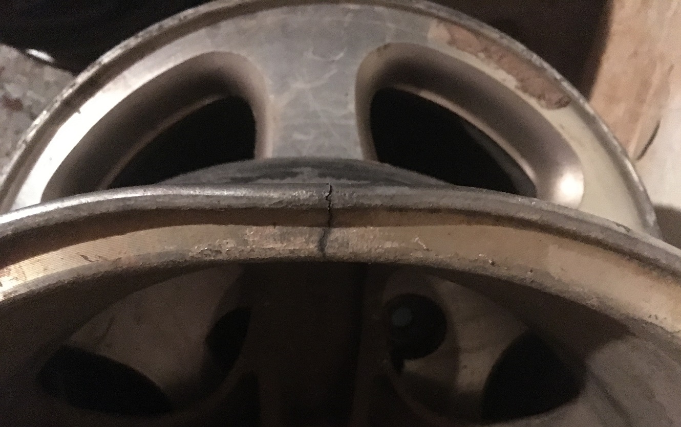

I noticed both the front wheels on the Outback were cracked/dented.  Let's blame that Texas desert race.  This was the worst, I think this is one I hammered/chiseled in Texas to make it round enough to hold air.
They still held air but I had them swapped out with some non cracked wheels.

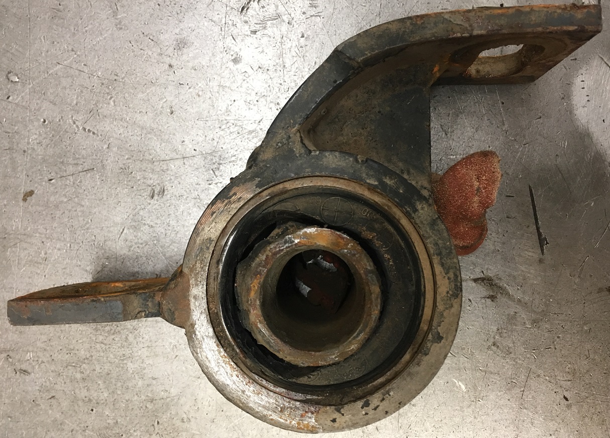

While we had the struts out of my black Outback one of my friends pointed out the RR wheel well / strut tower was starting to crack more.  You should know the drill by now.
If I keep this car for much longer I should really rebuild those more thoroughly and/or add some tubing.

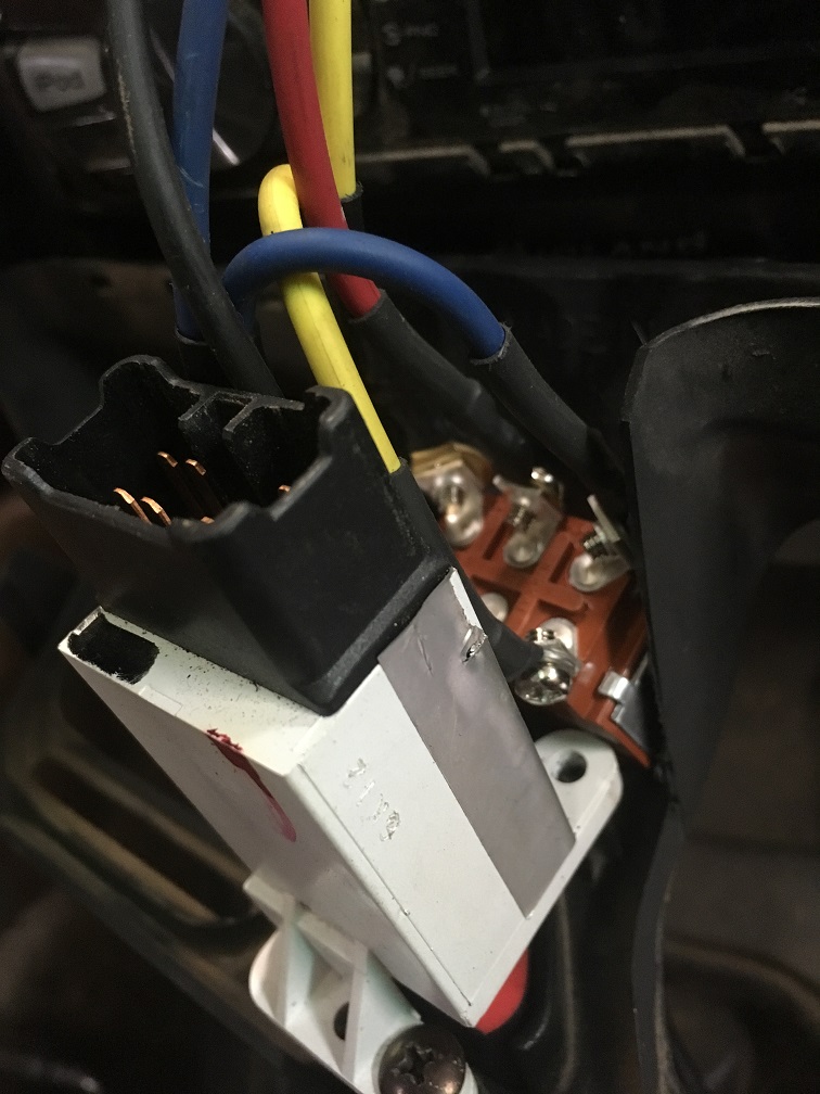

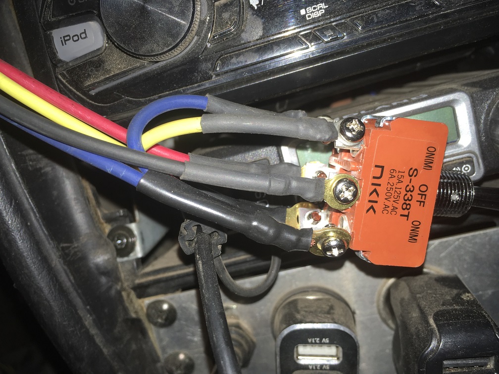

Figured out the problem with the one radiator fan not working was a fuse inside the car in the small fuse block so that was a relief.

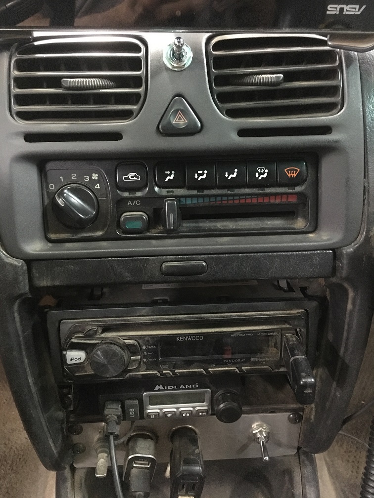

Wired in a DPDT momentary toggle switch to manually operate the HVAC actuator. Have it wired in parallel with the stock control that seems to not work at all anymore. Pin 8 (red/black) is 12V ignition on, pin 12 (black) is ground, wired those to the center terminals of the switch. Pin 4 (blue/black) and pin 13 (yellow) go to the actuator, wired those to the other terminals of the switch so it can reverse polarity.  Wanted to put it just below the cupholders but didn't quite fit.  Seems to work but I plan on using it as little as possible to not burn out the actuator.
Should have done this years ago. Ultimately I think if you had a strong enough HVAC fan you could just have it come out everywhere all the time and adjust the fan speed and aim the vents.  Maybe even have the center vents spring loaded so they only open when the fan is on high.

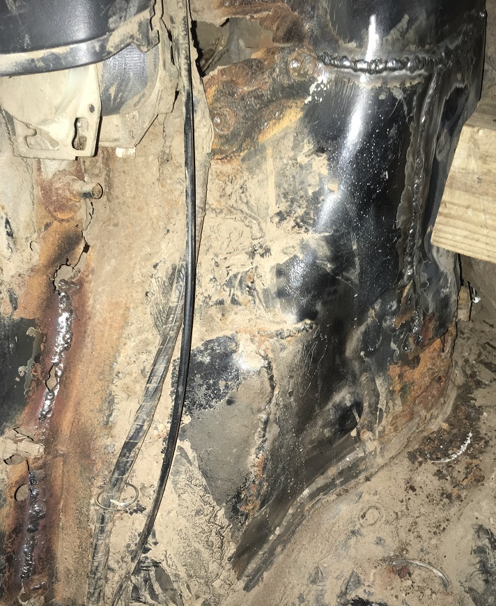

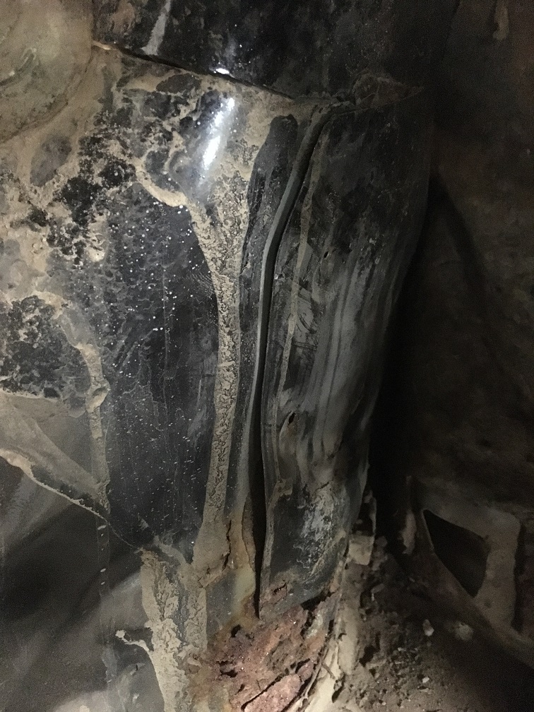

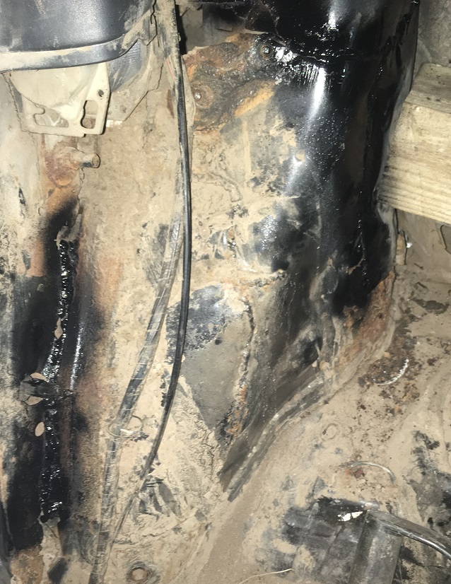

Odd that B's CV angle hasn't changed much with the softer springs, maybe they will settle in, or possibly still not soft enough? Some 'real' bumpers would help, even if its just tubing...
Still looks like a lot of metal missing from those rear strut towers to head out on a long trip as is...
I would consider paying up for some rally wheels... haven't bent any of mine and they have taken some hard hits. OEM is clearly not made for the abuse you throw at it.
K

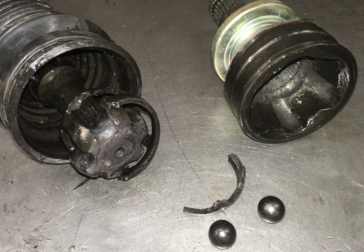

B's Forester didn't require any CV axle swaps on our long trip out west (more on that soon).  Should measure angle at ride height again but it definitely rides and handles better with the softer springs.
You were right about the strut tower.
I've only dented/cracked those alloys in desert races.  It's just a whole different level of abuse than trail riding.
